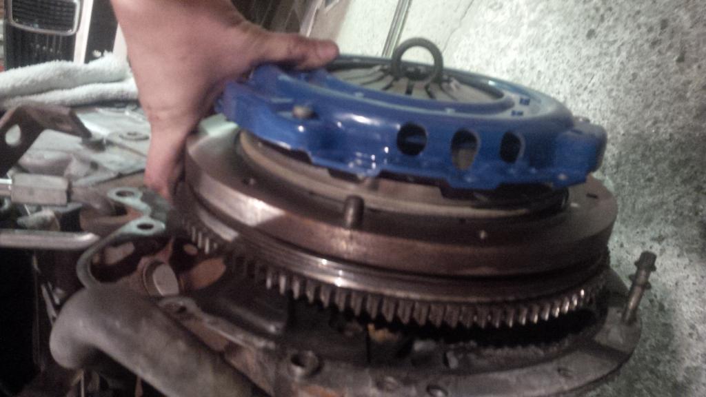

                    Borrowed an engine leveler from a local shop to throw the engine back in without causing damage this time. The clock was ticking, I needed to give it back to them tomorrow. So I rushed and finished up the diff, threw some oil in the engine, gave it a few turns to triple check the timing, pulled the turbo and valve cover to quadruple check the timing again (and I still feel worried about it), and put it all back together again.
                    The oil sending line for the turbo uses an adapter to the back of the m42, which, of course, had the wrong thread pitch. No big deal, Jake's sending me a new one. Throwing the engine in anyway. Attached flywheel (I used a hex key to lock the flywheel).
                    Open up clutch and pressure plate, install TO bearing in tranny (looks like they included an ISB as well for some reason....). Put clutch on, put pressure plate on..........WTF??

                      So that blew my night up. That's not even close.....Took weeks to get it in the first place because they had to MAKE it. Now I gotta wait all over again....
                      So I put the engine on the ground as best I could, removed engine leveler, re-attached engine to cherry picker with just the chain, and put some oil on the flywheel again.... UGH! :curse:

                        I bet that PP was made for a single mass flywheel. why would you keep that 50lb hunk of steel anyway?
                          woah woah, it's only a measley 28.2 pounds. AND that was before it was resurfaced! Must weigh 3 pounds or so now...
                          I didn't want to rid of it because the gearbox chatters more than I like already. Putting a lighter flywheel in will only increase that. So for less money and less embarrassing tranny chatter, I kept the stock DM. Yes, I lose out on some acceleration and blah blah, but (unlike many, I know) I believe, for me, that the negatives outweigh the positives. At least for now. Simple enough to put in a lightweight one down the road if I ever want to do it.

                            FINALLY got the new pressure plate.
                            Boom, clutch on, tranny on, engine leveler on, cherry picker on, over the engine bay... ran out of time.
                            Next day, lowered in, secured down. BAM e30 disco potato.
