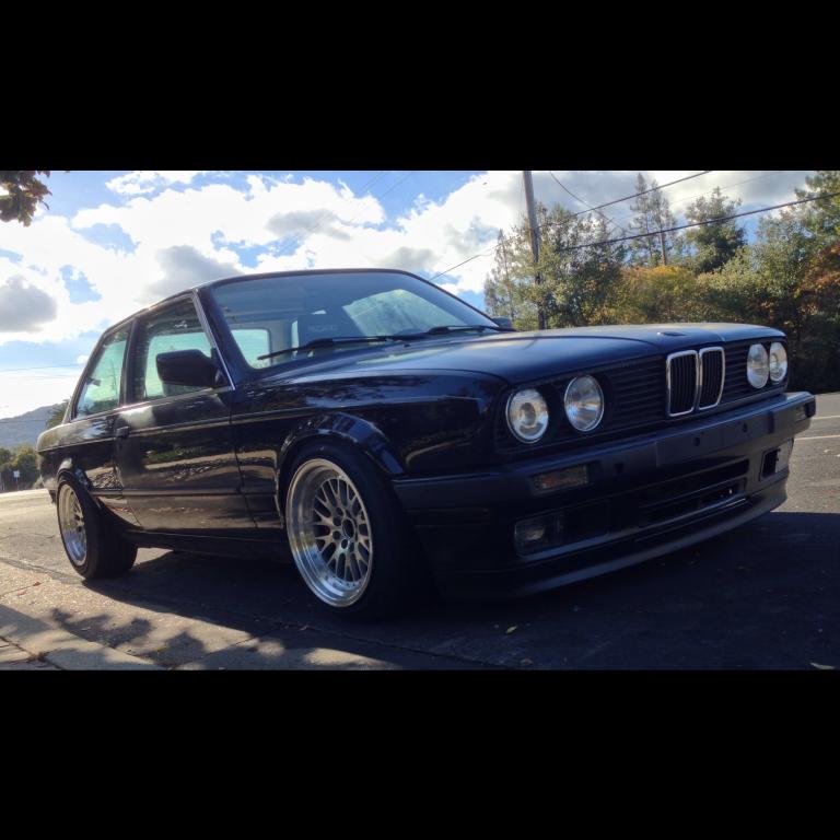

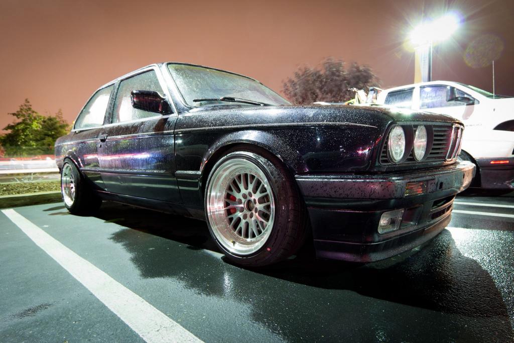

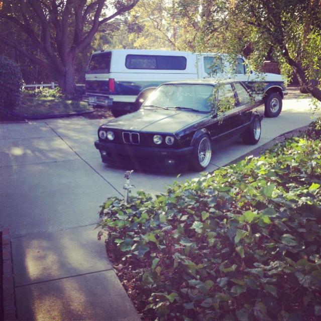

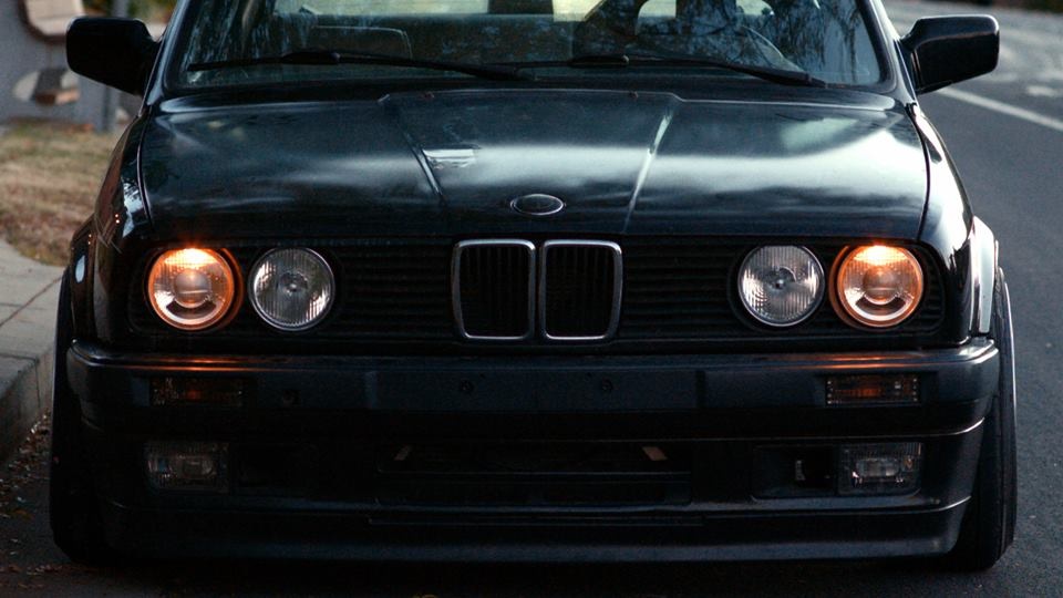

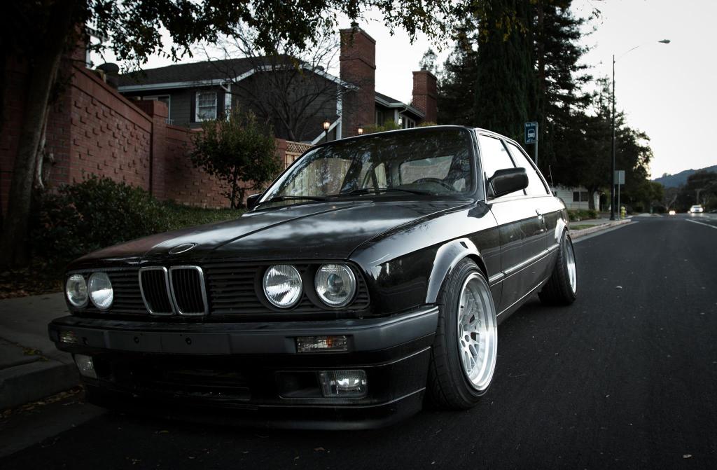

    time to show her off i guess?
    Just finished the zf 6 speed swap. Thought id whore her out.
    ^Thank again for the shot Cabriolet!
