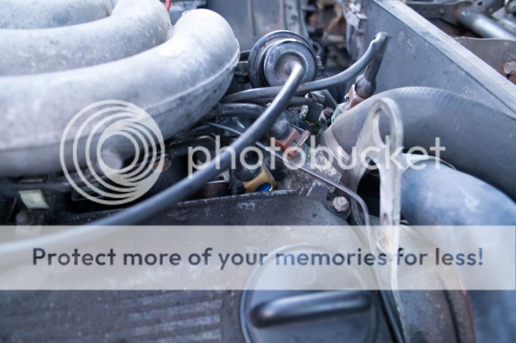

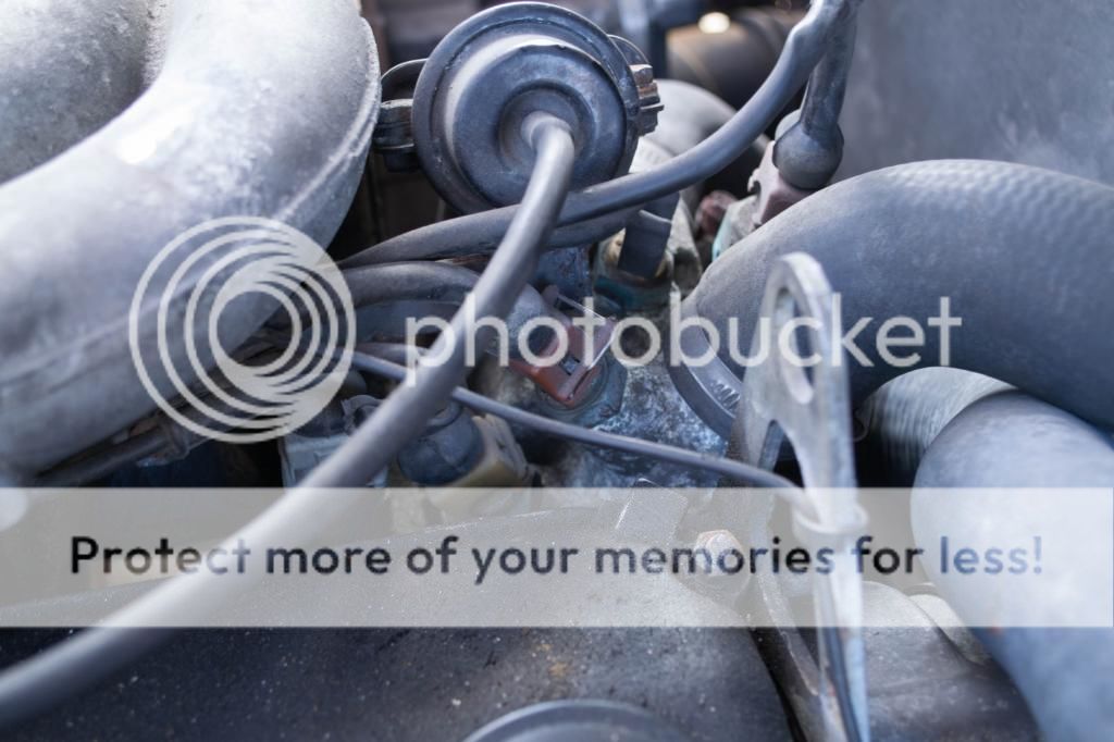

Things are a little better. Changed out the coolant temperature sensor and checked out the ICM, looked ehh but plugged it back in anyways. The idle is better but still fluctuates a little, now only 800-1300. Drivability is much better so I am happy again. Now I think the leftover problems are probably due to a small vacuum leak.
Heres some non exciting pictures on the before and after of the sensor. Wanted to get a side by side but more coolant leaked out than I thought would.
