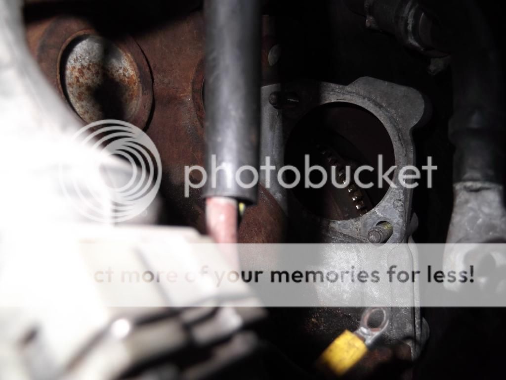

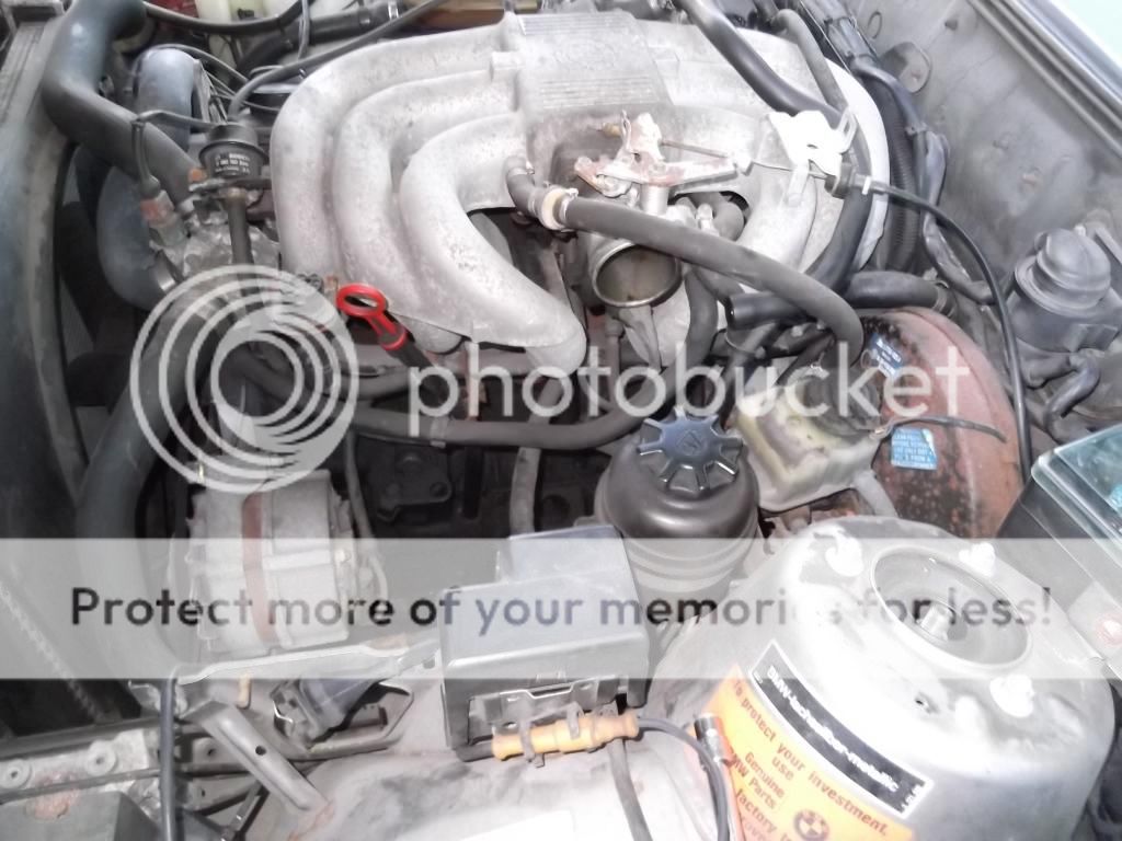

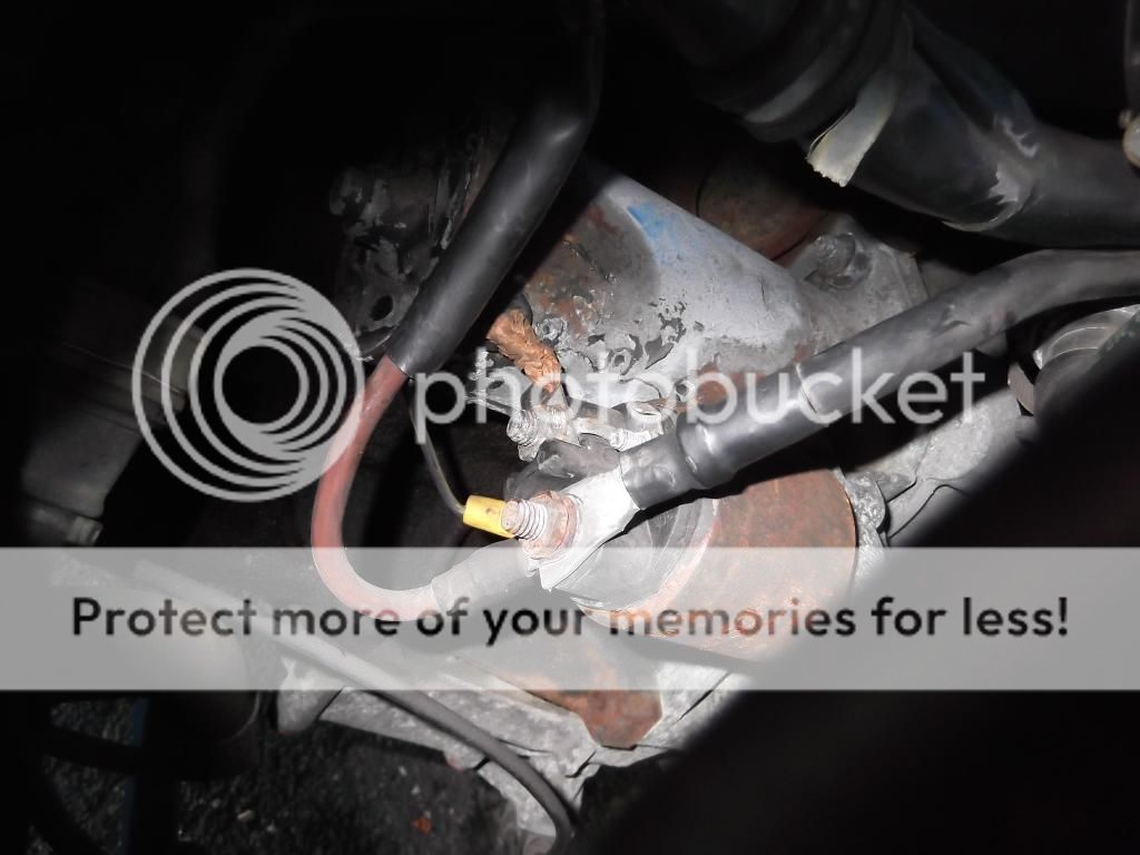

              So about three times in the past month or so my car wouldn't start. With a few pokes to the wire between the starter and solenoid and a few other minutes hitting things, it would start back up. Well, trying to go to work today... no start again and no luck getting it going so that was the last straw. Time to change the starter.
              Had to push the car from my spot on the street to infront my house. Jack it up and kick the ramps under each side.
              Nothing pretty under here... and the air filter arm is gone.
              There it is, and it looks old and worn out. And out ya go. Holy crap there is almost zero room to hold the back of the top bolt from rotating. But with some flexible arms squeezing into small spaces and out it comes that easily.
              And the new guy, reman'd unit because I'm cheap and I'll have to get an "i" version for the engine swap anyways.

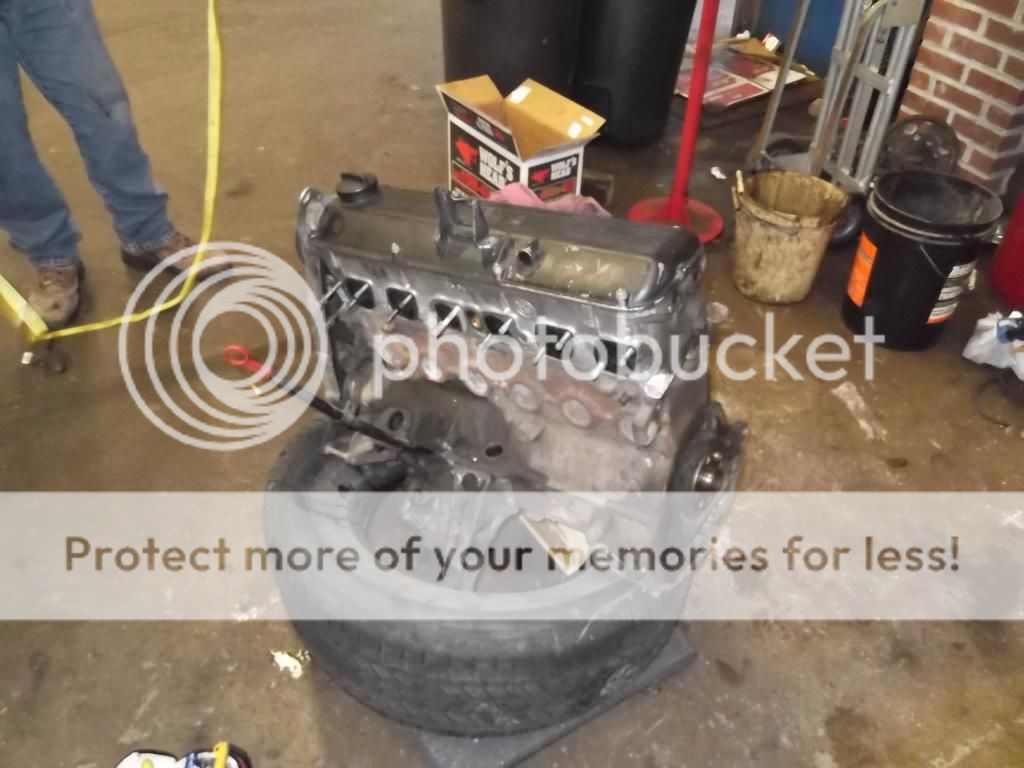

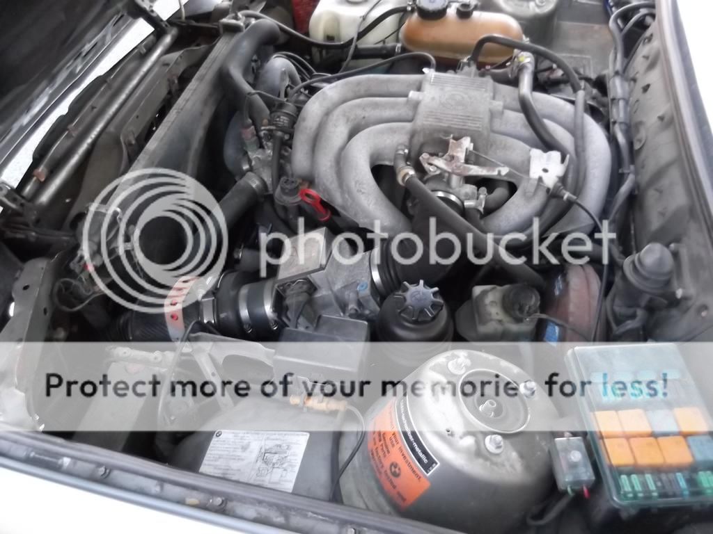

                Bit of progress on the stroker build. Ive been keeping it at a shop my dads friend owns and haven't really had the chance to make it over since I just started my new job. Well I had a hour yesterday to run over with my dad and start breaking it down. We got off basically all the hoses and wires and intake. We plan on going back Thursday to finish up. Im trying to test fit my m52 crank to see how much if any will need to be shaved. From there it will be time for custom pistons. Will take any suggestions on CR but right now Im thinking a final of 10:1 is what Im going for.
                Pic of crusty engine because pics are exciting.

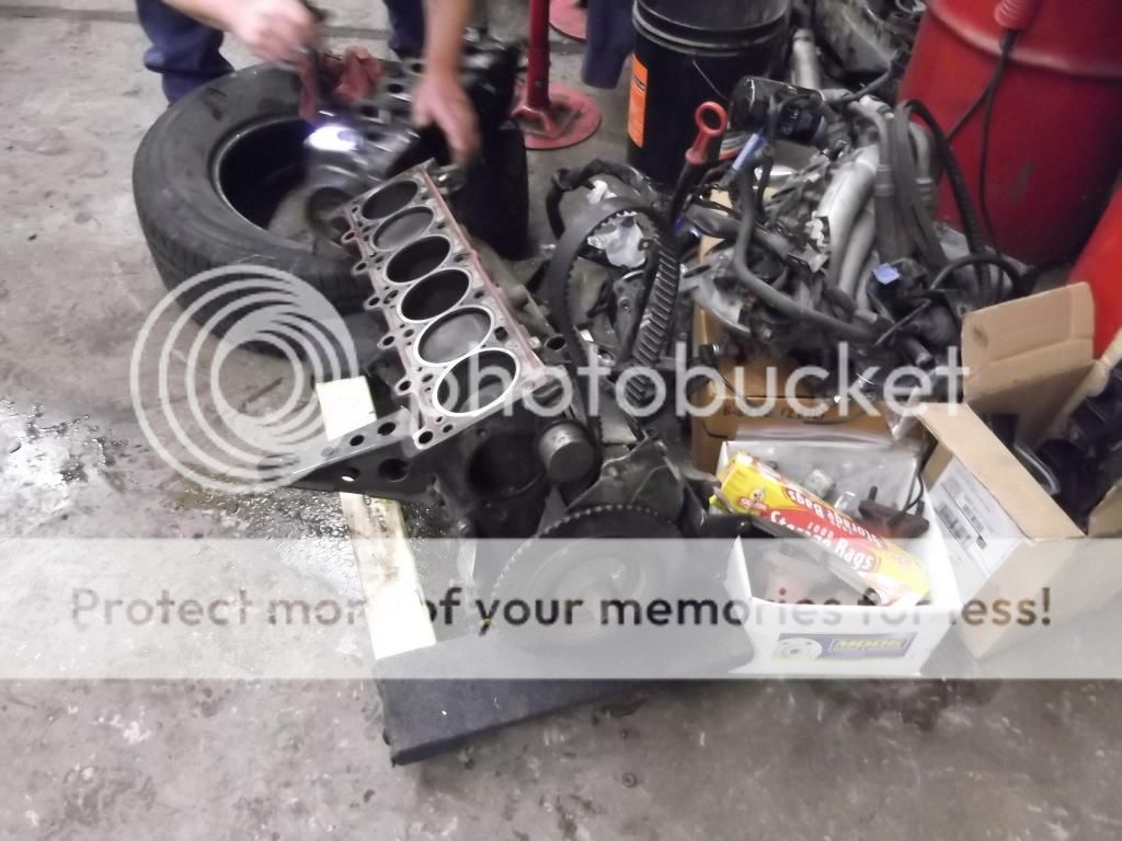

                  Well I can say it sucks to only have a hour a couple days a week to be working on things. Went back to the shop and got the head off but the catchup was on the crankshaft bolt. We had no clue what we were doing and couldn't get that thing to break loose. Even trying with a huge pipe on a big wrench no go, and then trying with a air gun still no go.
                  We never got the toothed pulley part off so maybe we should have done that first. We would try to hold onto it to keep it from spinning while working on the crank bolt. Tomorrow we may try to get it off first and we may also ask around to see if there is any crank pulley holder tool in the area we can borrow. Two of the six pulley bolts were snapped off in there so getting them out is on the list to do eventually (we didn't snap them, it was like that. promise lol).
                  Also the funny/weird part was there was dog food in the head. About 8 decent sized pieces of dry food chunks fell out when we split the head from the block. Coulda been something else, I should have taken a picture.

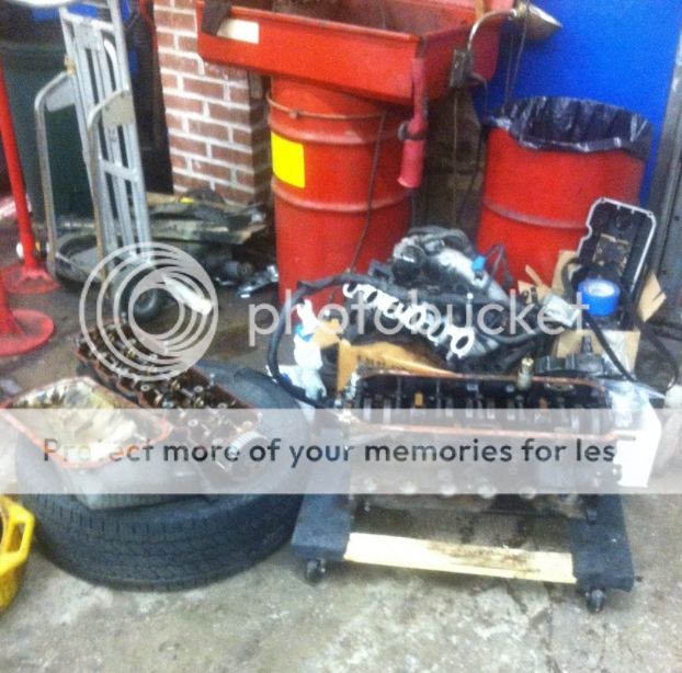

                    Blurry pic of the engine bits...
