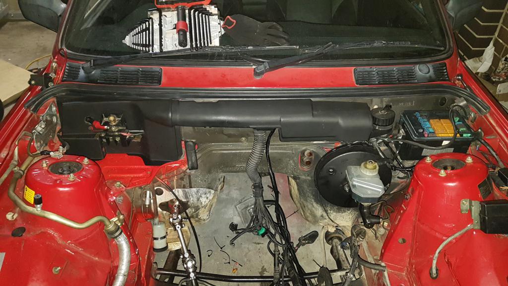

                  also, anyone reading this who has done a 24v swap, how did you mount your diagnostic port and engine harness relays? i tried to find mounting brackets on realoem but couldn't find anything. i sold my m20 relay bracket with the engine so i no longer have that and i'd like to mount them somewhere on the passenger side near the firewall. maybe i'll have to hit the junkyard this weekend and see if i can find brackets of some sort.
                  Originally posted by E30335i
                  Didn't browse your thread, if your using m3 covers, has provisions for the relays to sit there, if not, try the fuse box where the auxiliary fuse box is?
                  Diag port in original location works fine.
                  All my relays are also in the stock location. Shouldnt have got rid of that part...

                  • mitchlikesbikes
                    • Dec 2013
                    • 858
                    #309
                    yours all appears to be different due to RHD and other factors. the original location for the diag port on my car was at the front d/s of the engine near the AFM. your relays are in a different spot than mine were from factory too.
