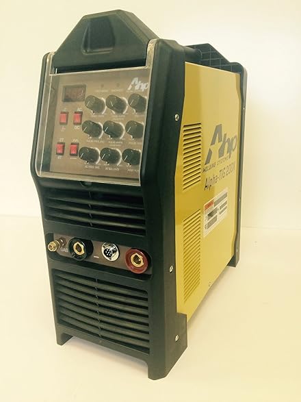

    got my new welder set up yesterday. i have no idea what i'm doing but excited to learn. it will be a slow process though.
    been working on small stuff on the car. i fitted some of the pcv hoses and am just working on general finishing work on the engine. will post some pics tomorrow probably.
    don't mind the leads being backward. like i said, no idea what i'm doing haha

    i also picked up an AHP AC/DC tig welder today for a killer deal so i'm preparing to jump into that rabbit hole. excited to start tig welding, i've wanted to learn for years and it is finally materializing.
