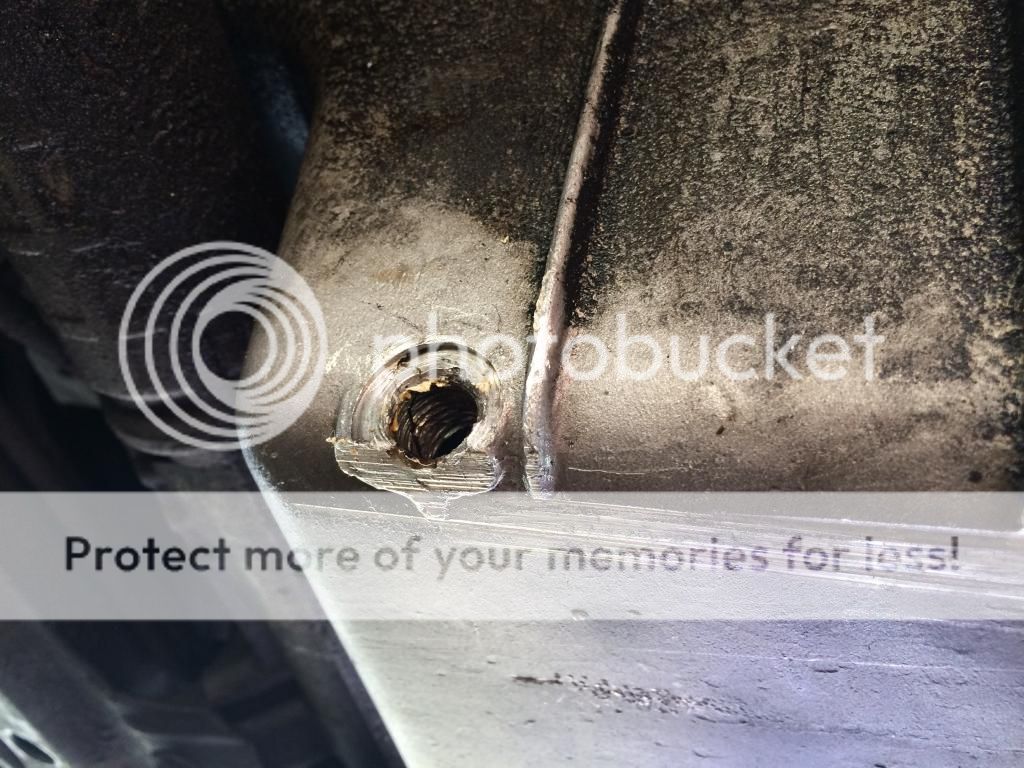

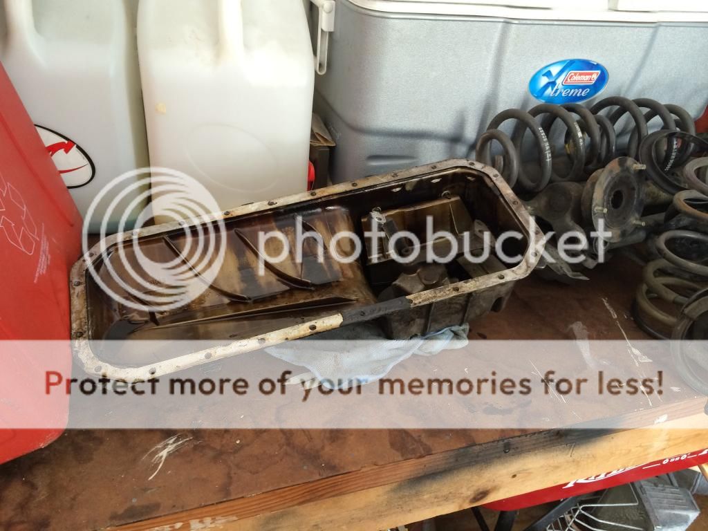

            SO. Some shit happen. Thought i was going to get my new motor mounts a couple days ago and pop those bad boys in before the roads took to much of a toll om my pan, but that didnt happen..
            Im not sure of you can see in the pic, but theres a crack in the threads of the pan drain bolt hole. The rest of the pan is totally fine, but the bolt was just spinning around and wouldn't catch on anything, so oil was EVERYWHERE.

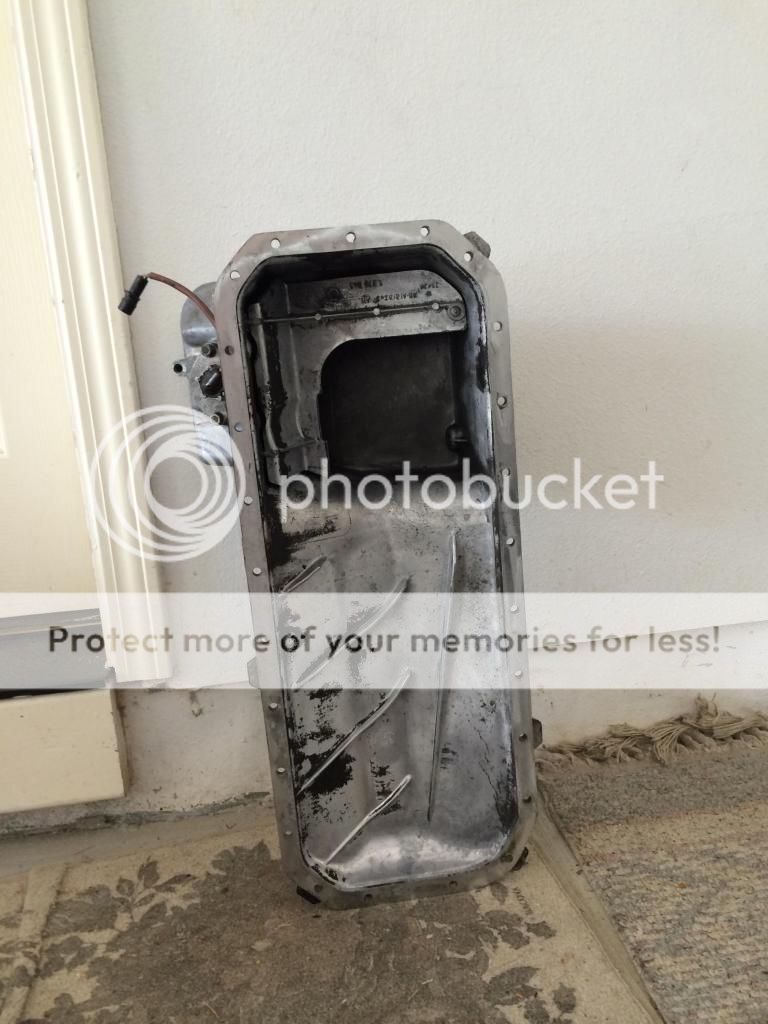

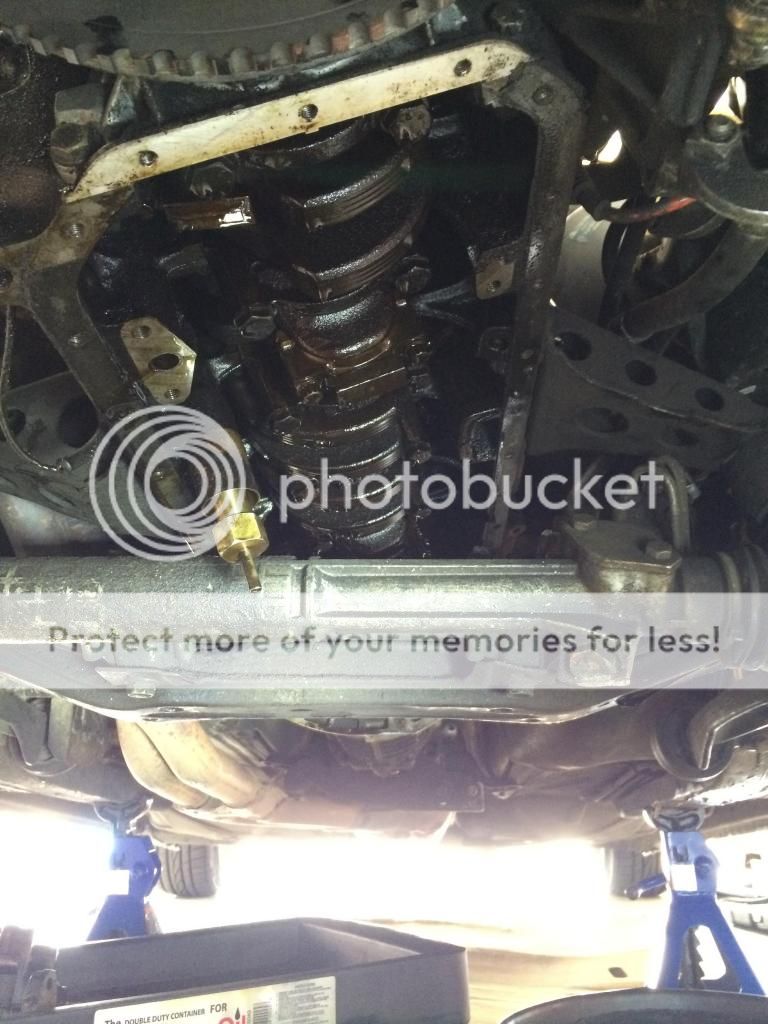

            Pretty lame and i wasn't expecting for something like that to happen. Maybe the whole pan to crack or have a huge chunk taken out, but that? Weird. Whatever though, shit happens. Went out that day and got a new pan from a local.
            Flossy.
            Ive done a pan before on my coupe, so i was familiar with the process and it went pretty smooth.
            Pan out.
            Might try to salvage this pan somehow for future pan issues...

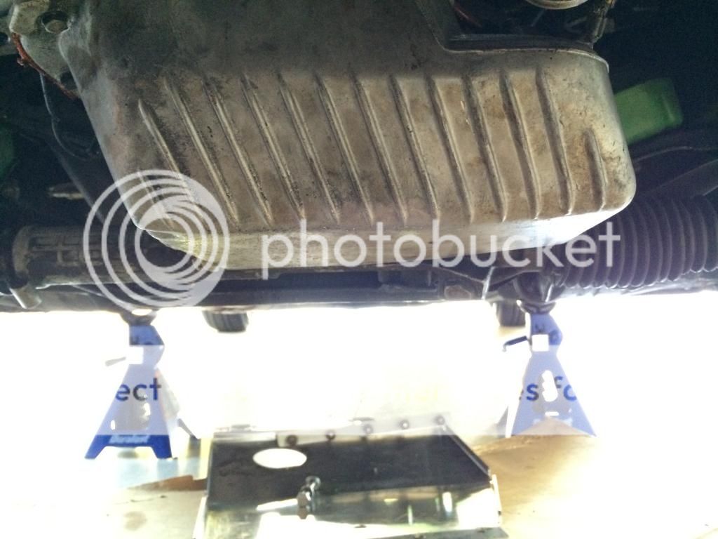

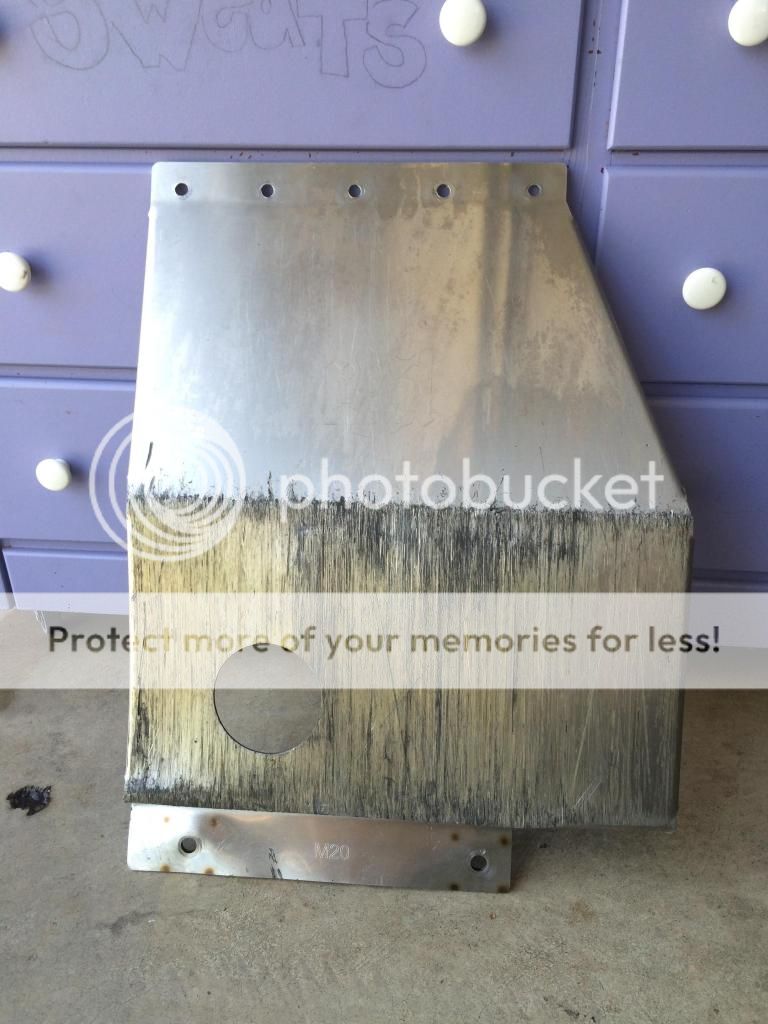

            So with the motor mounts a couple days out and my coupe having a cracked pan too :mrgreen: i decided to take the protector off the coupe and put it on the vert so i could at least have a car to drive till then.

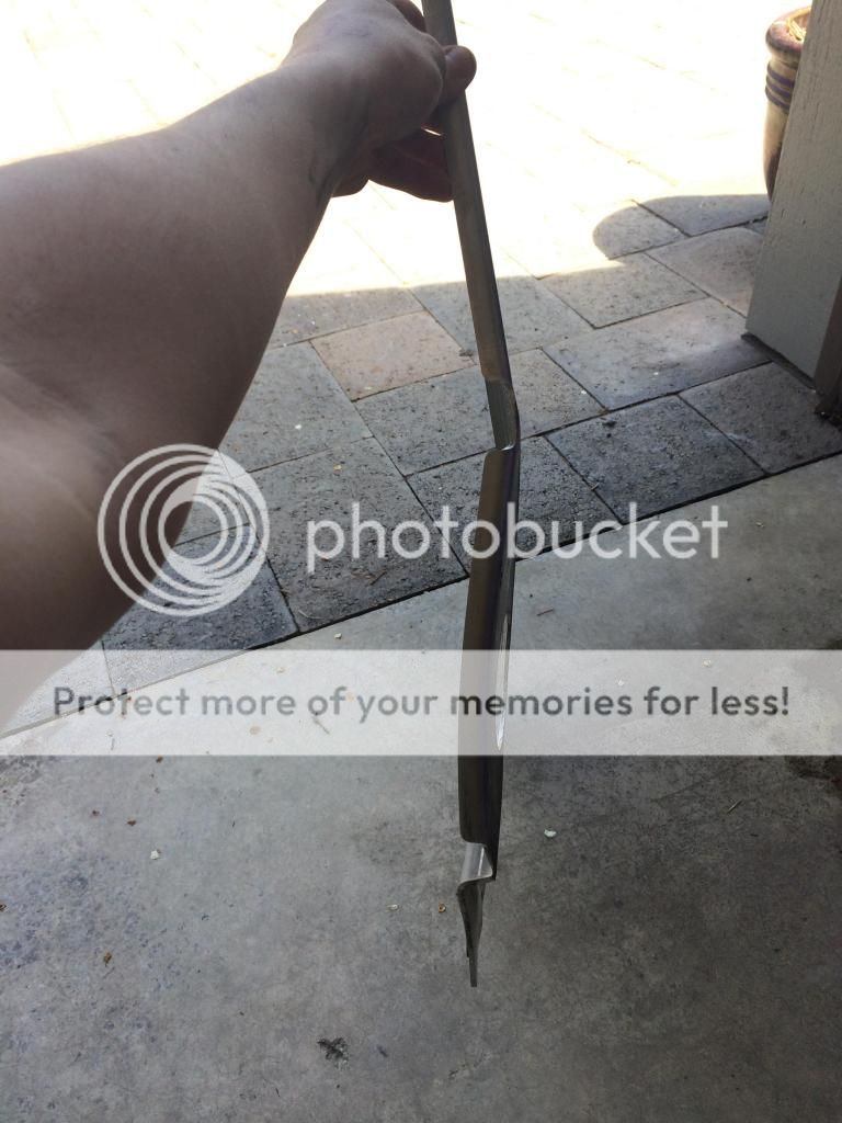

            This thing has see some ABUSE.
            Thats suppose to be straight if you couldnt guess...

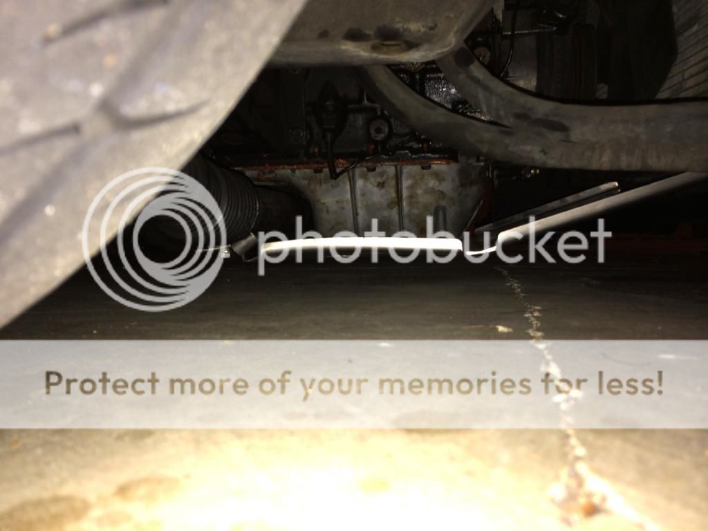

            Drilled some holes and slapped it on. Its pretty darn low.
            Thinking now a wanna go with some stiffer springs F&R so the car has less room to travel and scrape the pan, but i have been enjoying a ride that isnt like riding a wooden bike. We will see, but i think with that and the new mounts im getting, the problem should be resolved for the most part.

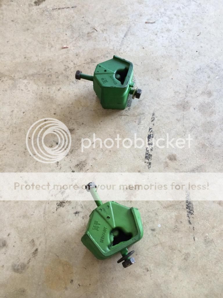

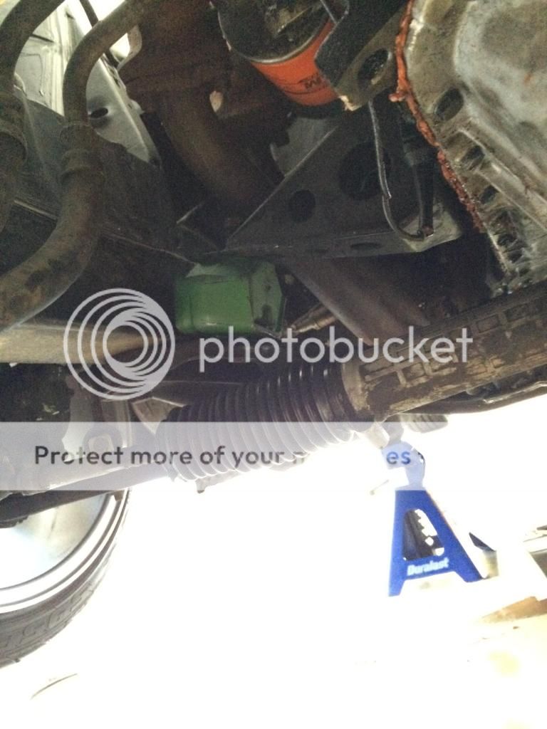

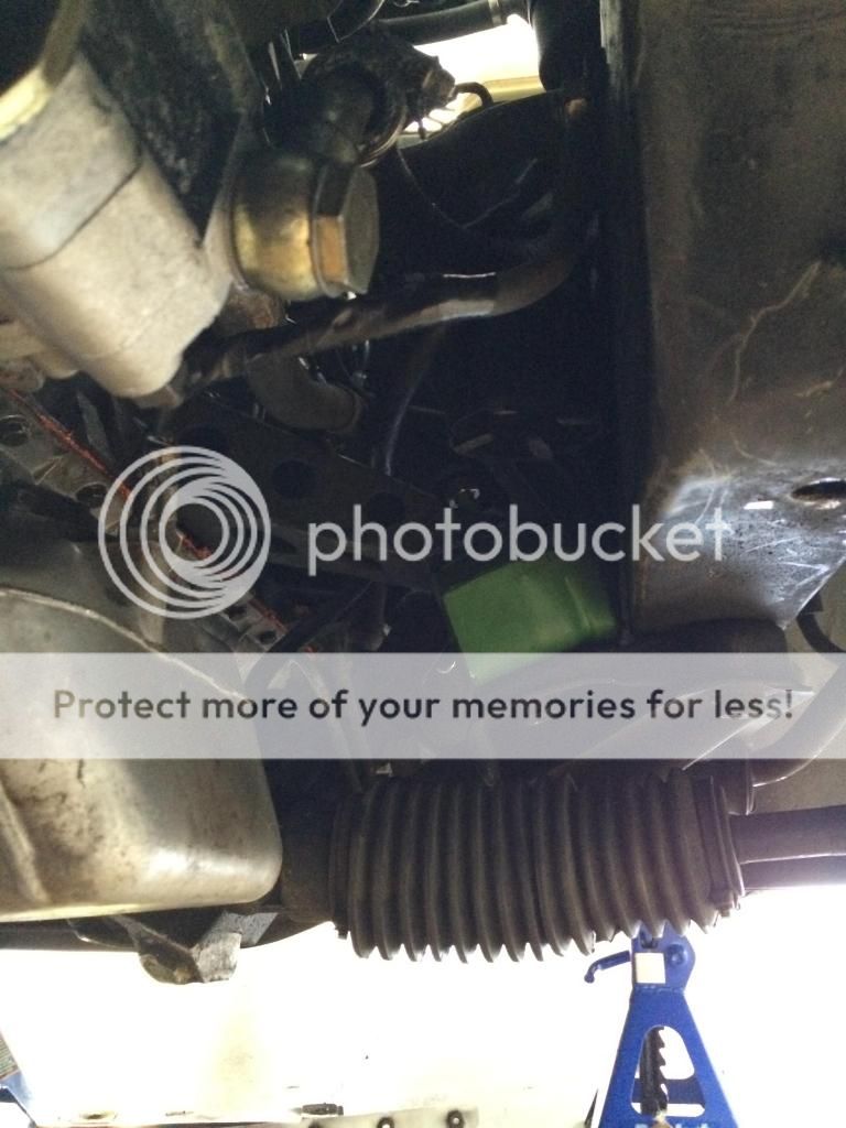

                    Got my new motor mounts in finally. Thanks to the advice of another member on here (ToPLeSS(e30)FeinD) I went with e28 m30 motor mounts. They are thicker than the m20 mounts so it will raise the pan above the steering rack and they are a direct fit as well.
                    The passenger side mount was torn nicely.
                    Went ahead and loosened the old mounts and raised the motor to get them out. Had to cut the top of the stud on one of the motor mounts to get it in because it's a bit longer than the stock mounts and i couldn't get the engine any higher without breaking stuff.
                    New mounts in
                    This shows the pan and how much it was raised. Now the steering rack can kiss the pavement instead.. Lesser of two evils!
