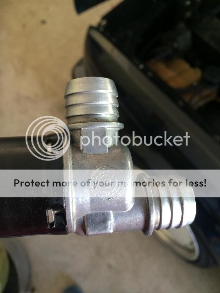

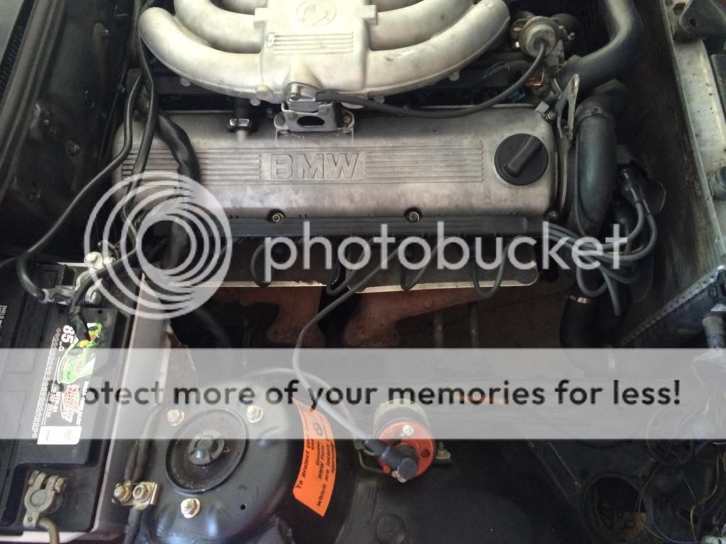

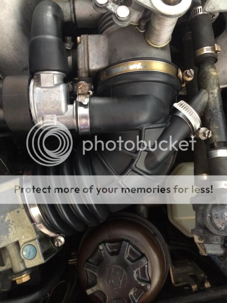

                  Car was having problems idling recently and would die often. After a visual inspection i notice the intake boot is cracked, so i ordered a new one. Had to make due with duct taping the boot to get it to stay running until it the new one arrived..
                  New boot
                  Also cleaned the ICV while i was in there.

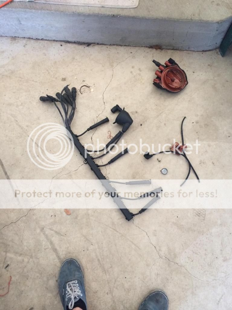

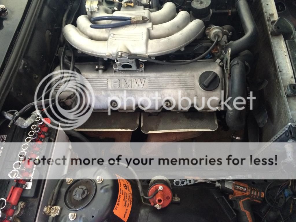

                  After that was replaced it still had the same issue.. Figured it wasn't anything to due with air or fuel so i checked all the plugs. They weren't terrible, but since I've owned the car i haven't replaced anything to due with spark, so i decided to do a little overhaul.

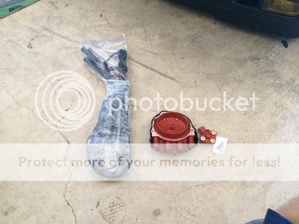

                  Got new plugs, ignition wires, and a cap/rotor setup from a local euro shop.
                  Old crap removed.
                  New crap installed.
                  Boombam problem fixed. Love when stuff works out like it should.

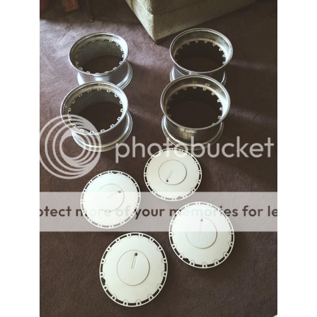

                  Found these bad boys on Vwvortex and just had to have them. Crenshaw classics from an old vette. Specs are 16x8.5 and 16x9.5 and the offset was unknown, no stamp anywhere. I had a set of salad shooters on my coupe so i already had the adapters to fit vette wheels on a 4x100 car.
                  When they showed up.
                  Had to go out and buy some hardware to bolt them together, which i totally underestimated the cost of... Pretty darn spendy. I've never owned a set of multi piece wheels before.
