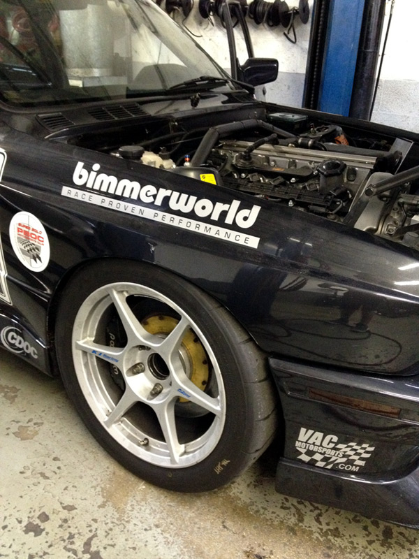

                          Alright, so yesterday I made a quick drive up north for a bit of wheel measuring.
                          DSC_3520
                          by ericandshovin, on Flickr
                          We test fit two wheels:
                          -Black 17.8lbs 17x9 et42 (flat) with puffy BFG R1's 255/40/17
                          -silver 16.9lbs 17x9.5 et35 (concave) with Dunlop ZII's 255/40/17.
                          Various spacers were used to line everything up.
                          Originally posted by Eric
                          I would absolutely love to run Apex's concave 17x9 et30 wheel, but I'll probably run into clearance problems with the willwood calipers.:big cry:
                          As I guessed, the calipers caused a bit of trouble. On the concave wheel, I had to run 25mm of spacer to clear the caliper.
                          DSC_3535
                          The caliper clearance interference can be solved in a few ways:
                          1. run the non concave wheels
                          2. steal the larger brake kit off my 325 track car. This will move the caliper outboard 10-13mm and give the spokes more space to move away from the caliper. Check out the profile differences Rallye vs. Race
                          3. Ditch the E30 M3 suspension in favor of E36 M3 suspension. With the deeper mounting depth of the caliper, I will have more room between the spokes and the caliper. E30 M3 vs. E36 M3
                          4. replace the SL6R with the thinner SL6R14. This caliper is no longer being made by wilwood, so it would require finding it NOS from a vender or used on the internet.
                          So, overall how did they fit? Surprisingly pretty good!
                          Untitled by ericandshovin, on Flickr
                          DSC_3531
                          Pro's & Cons:
                          17x9.5 et35 concave wheel:
                          DSC_3526
                          + Fit with a 25mm spacer to clear the wilwoods on the front side and less than a pinky finger width between the strut and the wheel. A phone call into apex revealed that the 1/2" difference between two concave wheels is all on the back, so I could possibly run 20mm spacer to sink the wheel in a little bit, but this would require a change in brake kits (I have them already, no cost change)
                          + Prefer the look. Really really really prefer the look!
                          + the concave 17x9 wheel weigh's 1.3lbs less per corner than the flat faced wheel. Maximum weight loss is not my end goal, but every little bit helps.
                          - These will stick out 13mm more than the proven setup Hyboost is running. I don't want to pay for respraying the fenders after a bad bump!
                          - Apex only has the anthracite version in stock. I think it will look good against the orange, but it would look better in silver, like the ones test fit on the car
                          - With the wheel sticking out 10+mm further, I might be limited to only a 245/40/17 square tire instead of a 255/40/17.
                          - Didn't actually fit the 17x9 et30 wheel, so I have to take what I learned from the 17x9.5 et35 wheel and make a good educated guess. :ohsnap:
                          17x9 et42 flat wheel
                          DSC_3528
                          + Proven to work, both with Hyboost's information on S14.net and with yesterday's test fit.
                          + less spacer needed to make the wheel fit
                          + No brake caliper clearance problems
                          + No need to change brake kits, suspension setups or even spacers... just bolt on and go!
                          + I can run 255/40/17's no problem.
                          - I've alway thought the flat face ones were boring. This is a decade of disliking the look of this wheel (BBS RC then Apex). Might seam stupid, but this is a big big deal to me! On the other hand the black wheel with the huge tire did look pretty good and I think it might grow on me.
                          - Not concave
                          With either wheel setup, these steps will be performed to maximize potential & minimize risk...
                          - Roll all fenders flat
                          - Increase camber in the front as much as possible, up to -3.5deg
                          - Increase rear camber by TA adjustments, and lower ride height
                          - Lower front ride height to sink wheel into wheel well
                          - remove fender liners
                          - Turner motorsports steering stops
                          As always, your opinions are greatly appreciated! What do you think I should do???
