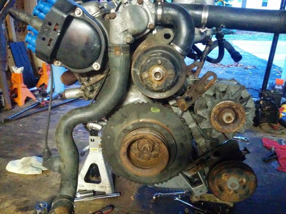

        Here's how mine looked before i dropped or in. It does run.

          So if I recall, that's a m30b34 with the m20b25 harness, and m30b35 ecu and HB?

            I used a b35 balancer and bracket for the CPS as well as a b35 CPS
            Mine looks like andy's now and runs first key turn.
              I am running an M30B34 with B35 balancer, cps bracket, and DME. M20B25 harness. It's a real hodgepodge of parts, but it works, and it cost me very little to put together.
