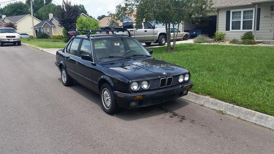

My 1988 Super E
  • sgtskid
    • 763
    My 1988 Super E
    I bought a 1988 Super E as a parts car for my old 91 daily. The 88 was advertised as having a "blown motor" but came with a whole host of aftermarket goodies. I was going to strip the 88 and swap all the parts onto my 91. After a bit of tinkering the 88 purred like a kitten and there wasn't a thing wrong with it! Since it already had all the goodies, I decided to keep it and sell my 91.
    The goodies:
    IE Stage III springs
    Bilstein Sports
    21mm front Sway Bar
    16mm H&R 3 way adjustable sway bar
    Urethane bushings
    M3 Offset control arm bushings
    Solid Diff bushing
    4.10 LSD
    Chipped
    Ireland fixed camber plates
    e36 steering rack
    The day I picked her up
Name:	88 Super E 11.jpg
    My old daily.. 300k+ miles, all original.

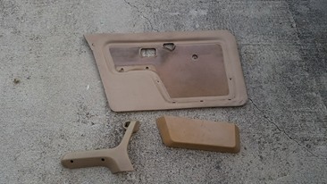

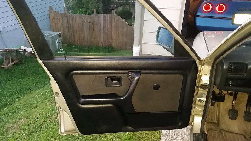

    I'm not a big fan of the tan and since the door cards are kind of ragged anyway I figured why not dye them? Turned out rather well. Can only has enough in it to do 1 3/4. So I'll have to pick up a few more cans tomorrow.
Name:	88 Super E 12.jpg

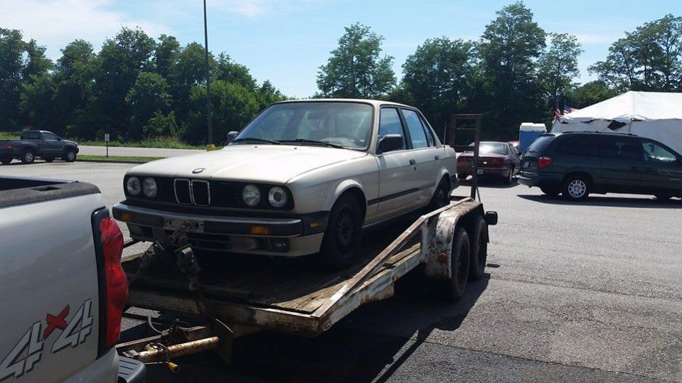

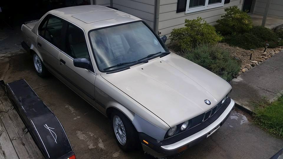

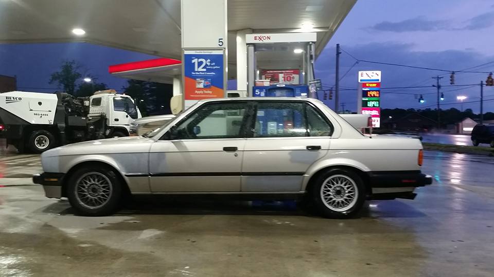

      I have done a bit more work on the car since I first brought her home from Cincinnati in 2014.
      Test fit some TR Motorsport wheels. Looks good but not quite what I'm going for.
Name:	88 Super E 10.jpg

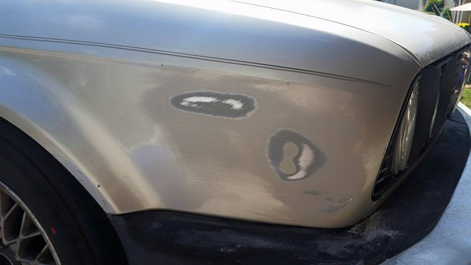

      The car was/is amazingly clean and was supposedly built in Las Vegas. No rust and only minor door dings. The worse part of the body was the passenger rear quarter. The previous owner thought he would try his hand at drifting and smashed into a light pole. I started fixing the dents and have been prepping for paint job.

      You can just barely see the rear quarter damage in the pic below. I'm waiting until I can meet with a buddy to use a stud gun and pull the dent out before skim coating with filler.

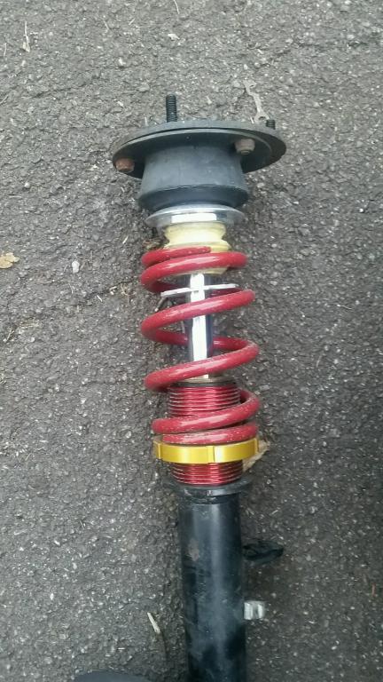

        The Ireland Stage III springs were nice but I didn't like the amount of body roll associated with them. Since they were the stiffest OEM fitment spring on the market, I had no choice but to go coil over.....
        OOOOOOOOOOO..........YEAAAAAAA.....
        After pic of the car with GC Coil Overs.
Name:	88 Super E 4.jpg

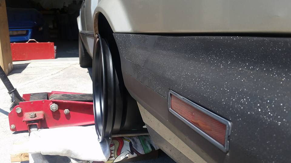

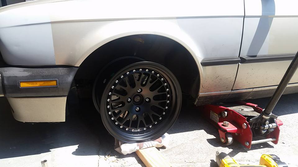

          Long story short, I accidentally ordered some rims which should be here Friday. We'll see how they fit.
          I did some searching to get an idea of what to expect when my wheels get here. In my search for information I came across two helpful websites.
          I should add that I have converted from lug bolts to lug studs with traditional conical nuts. (Thank you Motorsports Hardware)
          Are hub centric rings needed?
          Will my ridiculously larger rims fit with my stupid stretched tire? (not really, but just in case one was curious)
          Current: '91 DS M3, '03 TS M3 (6MT)
          '06 Chevy 2500 Duramax - Race car hauler, '90 Corvette - Weekend toy
          Past: '88 AW M3, '87 RB M6, '98 CS M3, '88 DS M3, '88 Zinno M3, '88 AW SETA (facelift),
          1988 Super E (Bronzit - grey wrap)- RIP, 1986 353, 1986 VW Jetta (vr6) - Racecar
          IG: RDE_Fabrications
          Check us out
          Or YouTube --> HERE;
          • sgtskid
            • 763

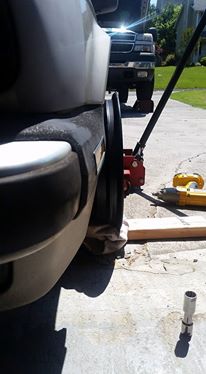

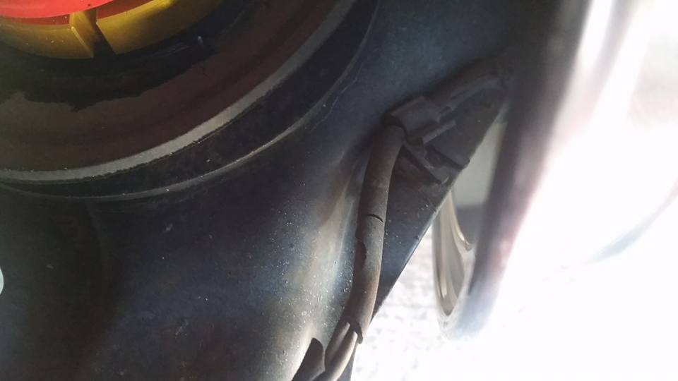

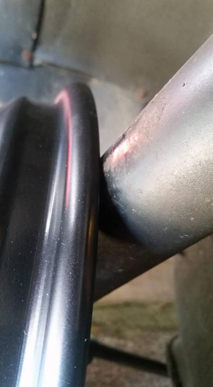

            15x9 et 15. I needed a 5mm spacer in the front to clear the struts. Currently running a 225/45 BFG Rival. I still need to do a little more work dropping the car down. I rolled the rear fenders and rolled and pulled the front.
            Test fit
Name:	88 Super E 2.jpg
Name:	88 Super E 3.jpg
Name:	88 Super E 6.jpg
            Hits the front strut - used 5mm spacer (could have used 3mm but wanted extra room for rim saver on the tires)
Name:	88 Super E 5.jpg
            Rear Control Arm Clearance is good
Name:	88 Super E 14.jpg

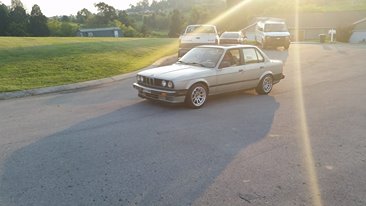

                Here's an after pic with wheels and suspension
Name:	88 Super E 1.jpg

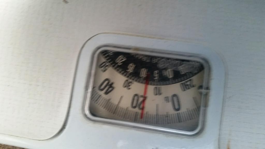

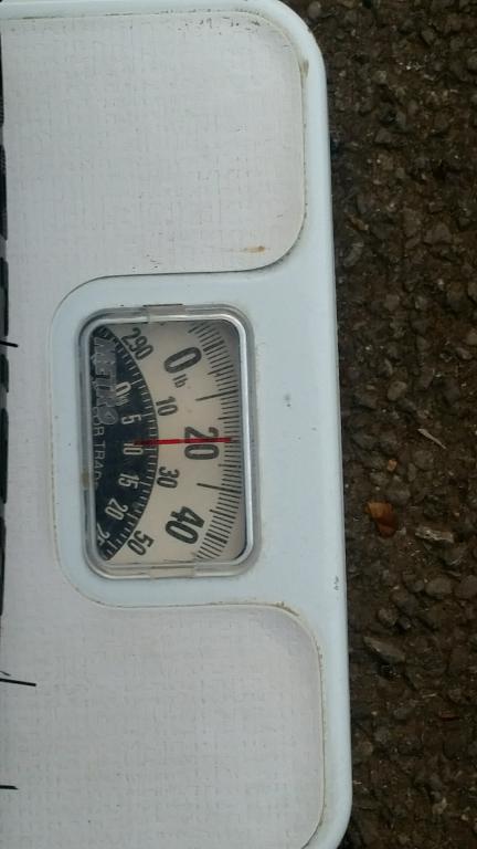

                      For shnitzngiggles I weighed the wheels and tires.
                      The rims weighed 17lbs for a 15x9 and 225/45/15 BFG Rivals weighed 20lbs each.

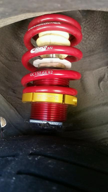

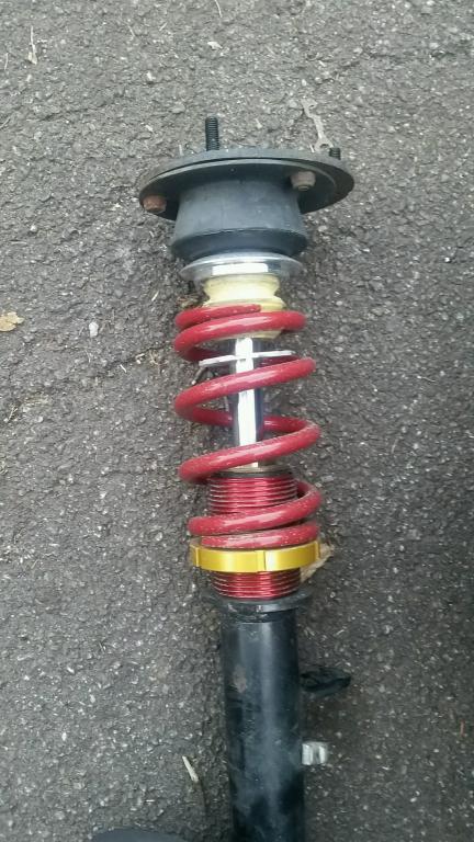

                        GC coil overs with Koni Yellow SAs -
                        The IE setup was too soft for my liking and the body roll made the car difficult to throw into quick turns.

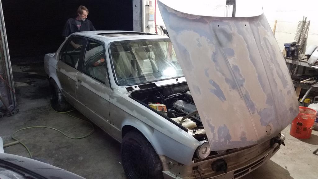

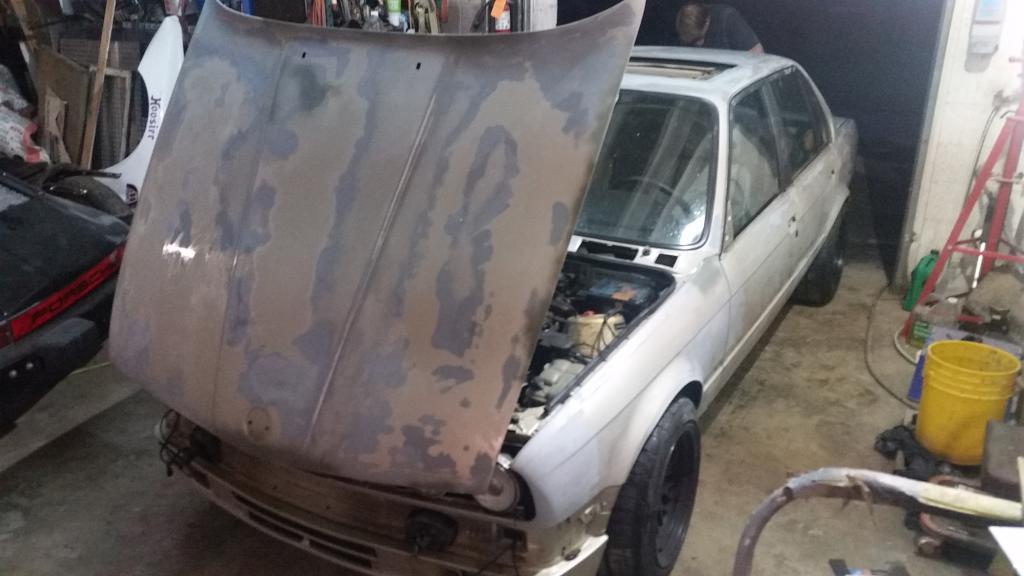

                          Time to finish off the body work.
