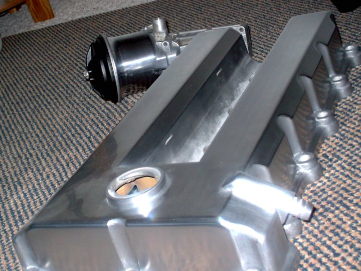

    worse than a jack off marathon
    my fingers, hands, arms - kill
    camera doesnt really do them justice... parts look awesome, worked them up to 2000 grit before cutting with various compounds and then some simi-chrome...
    other parts are bolted up like the timing covers, and the water outlet...
    the oil filter housing wasnt fully detailed, just the upper portion - the valve cover however has all casting lines removed, the raised signature BMW lines removed, all blocked for straightness, then buffed like a mofo
    Just need to come up with something better looking for the center spark plug cover, not diggin the stock plastic piece

                    haha wtf do you think
                    I figured while waiting around for money and parts to finish the motor I might as well do something somewhat productive
                    It will help keep stuff a bit cleaner now too as the porous cast parts are now super smooth
                    Paint never really did it for me... although the block is red - not my idea but eh it looks alright

                              I used a wheel on the upper portions, but everything else was easier by hand
