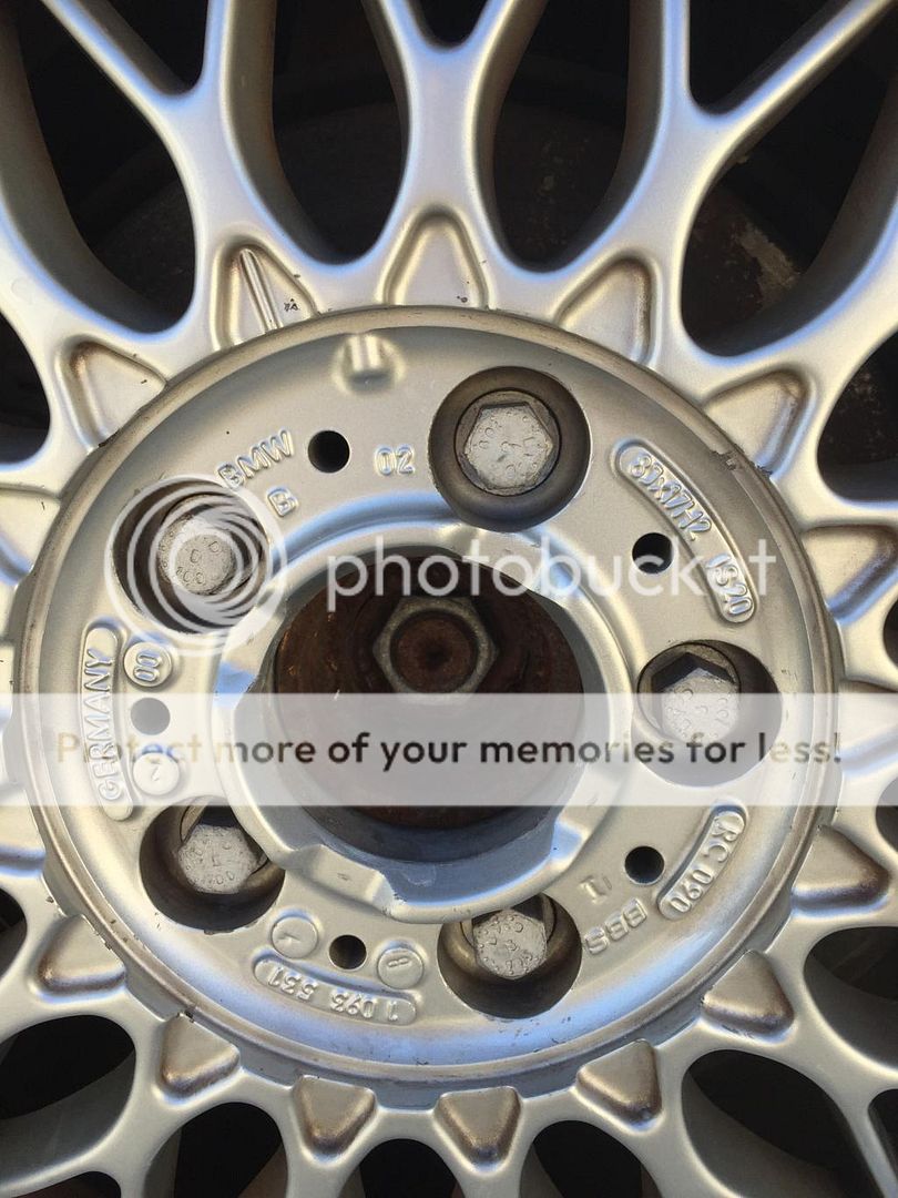

                      Also, the black tape on the front bumper looks horrible. Can you guys recommend a method to remove it without damaging/scratching the paint/trim?
                      I will be looking at tires today, can you guys recommend good tires for the Style 5's? The wheels are square I believe and are 17"x8"

                        215/40/17 for the tires if you want a no issue fit.
                        You may get some manufacturers 235/40 in the front to fit, but 235/40 will fit the rear no problem

                          My M3 use BBS CH ET15 with 235/40/17 (Star Spec) and I think it does look perfect, a good compromise between ride quality and look (too thin in these roads is a NO NO) but I'm running rolled fenders all arround. Front rub a bit at almost full lock with inner fender plastic but doesn't botter me.

                            Thanks for the info guys. I am going to order a set of 215/40/17 tomorrow. Im not sure if I want to roll my fenders and it looks like theres still a lot of room under those wide things.

                              With 215/40 most likely you won't have to roll the fenders, you should be more than fine. The issue mostly is in the back with wider tires that rub in the fender, front not so much.

                                Hi Diego, slept on it last night and now thinking of going 225/45/17 in the Michelin pilot super sports. I have them on my e46 m3 and they are good tires.
