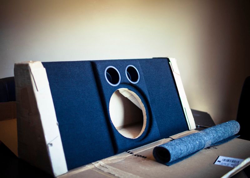

        Also, I purchased a full-replacement sound system. Rockford Fosgate Speakers, Kenwood Exceleon deck, and Infinity Sub. See thread here for more info.

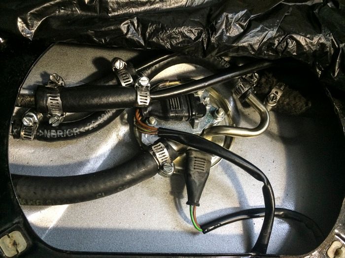

          A few major problems occurred. First, the Fuel pump went out (so we thought)...
          The old pump sure was ugly and needed to be replaced no matter what...it had been whining loudly for the few days the car was running prior to breaking down:
          After I installed a new pump, There was still no start. We ran some diagnostics and found that there was still no fuel delivery . We did some investigating found 1/2" of rust sediment in the bottom of the gas tank The PO claimed that it had been cleaned out, but cleaning out a tank like this would be IMPOSSIBLE. The inside was totally corroded. We had to order a new gas tank, fuel hoses, and inline fuel pump, and another fuel filter as the sediment had clogged & ruined the new one we just put in.
          Installation shot showing new pump, fuel hoses, and gas tank:

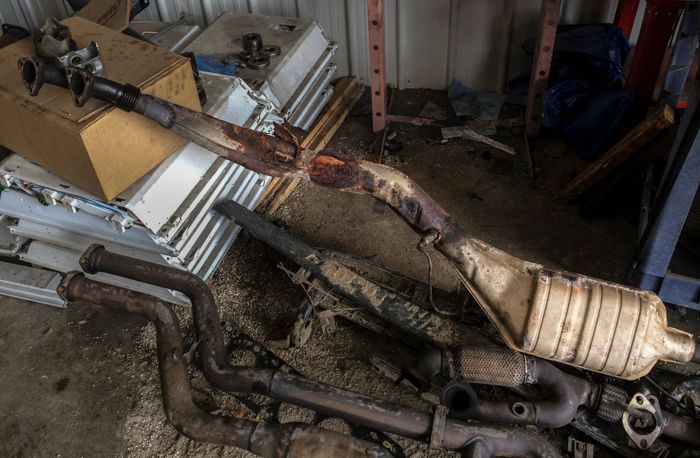

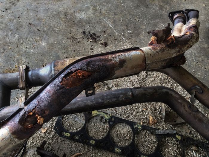

          Problem #2: Failed inspection for an exhaust leak on the cat converter & pipes. Ordered a new DEC one from BavAuto and installed it at our local DIY shop.
          The old pipes & cat were completely rotten:
          After spending around $450 on the exhaust ordeal alone, I realized i never even needed to pass an inspection for the historical plates i anticipate getting. :curse: Oh well, at least i have a proper exhaust now. (Why oh why didn't I take the blue pill?)

          After all of this, clean & pure gas SHOOTS into the engine. It is back up and running! :up:

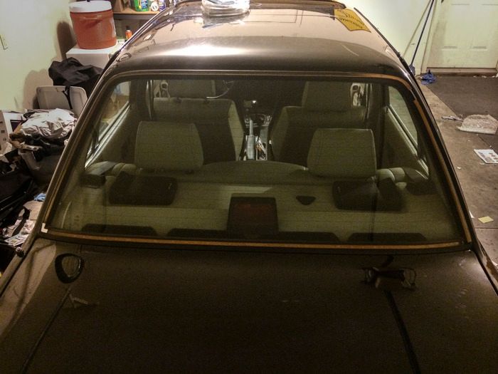

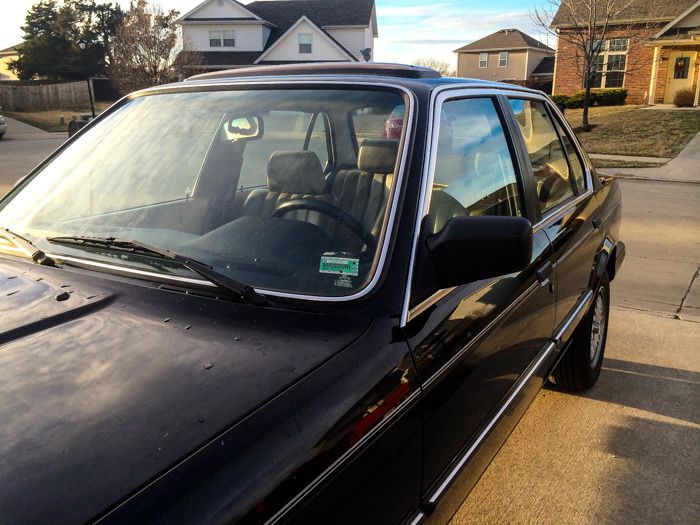

            Got to make her look pretty after she came home in running condition. As you can see in the photos, the front and rear windshield lockstrips were in very weathered condition. I ordered the replacement kit from BavAuto for ~$85, and a Lisle lockstrip tool from Amazon ~$11.
            I used watered down dish soap to lubricate the front, but I went out and bought some Silicone Lubricant before starting on the rear to make the task easier. Both are about equally effective but the dishsoap can be a bit messier and harsher on the car's finish. The soapy water also needed to be applied more often for the same effect. I ended up going back and forth between the two methods while installing the rear strip.
            A lockstrip tool does not make this task easy. Youtube videos make it look like it will be a walk in the park, but if you are a first-timer it most certainly will not be. Having the right tool will save you maybe 50% of time and a good deal of frustration in the windshield corners, but you will still numb your fingers, cramp your hands, and will still need a screwdriver to work in the areas that did not properly install during the first pass.
            After the job was done, it was well worth it.
            Front BEFORE:
            Front AFTER:
            Rear BEFORE:
            Rear AFTER:

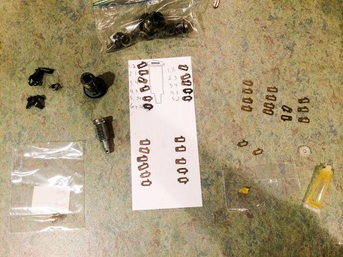

            Also, the driver's door lock was kaput, so i bought a rebuild kit and proceeded reconstruct with caution. The result, IT WORKS NOW!

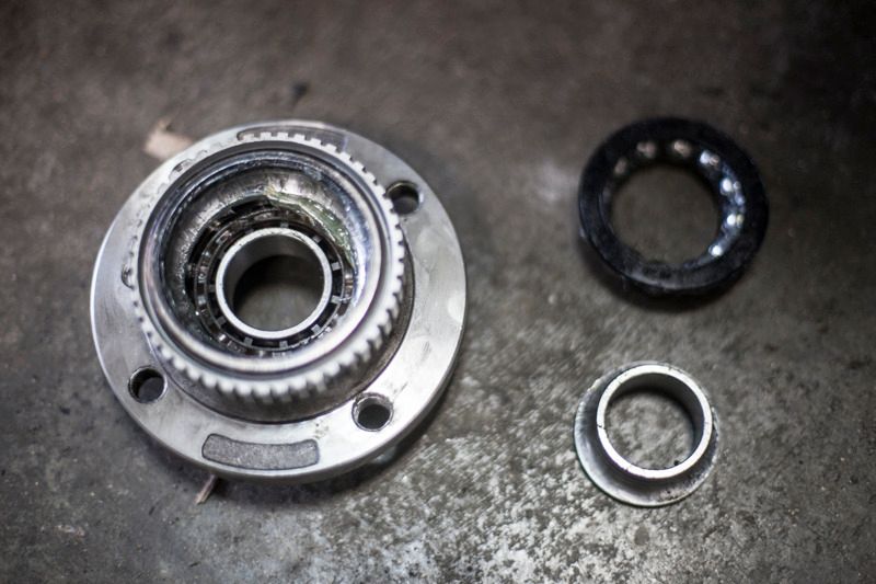

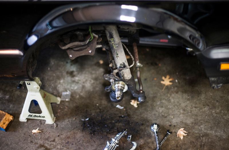

                              Welp, the new front wheel bearing broke into pieces when we attempted to install it. The vendor is sending a new one for free. Unfortunately this means no driving it whatsoever until parts come in. Until then it rests on jack stands...
                              New & Busted:
                              Install Shot:
