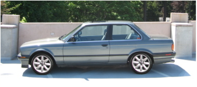

    alright, thanks guys. ill try to do a better Photoshop. i have to work with excel cause i have a mac!

      Originally posted by E30trash
      people say they dont fit, i just saw an e30 today with them on.
      what do you think
      sorry for the blurryness
      Liar, that's an obvious photoshop, liar.
      But, if the MINI wheels are 4x100 with around a 20mm offset on a 7 or 8" wide rim, they will fit as long as the bore is 72.56mm.

        I never said it was fo reals son! i put it in this section for comments and suggestions, i like the look, and i was wondering if anyone else did, i now know what it takes to make these wheels fit right. and again thanks for the input fellas.
            Mini wheels are high offset, like ET40 or so. The E30 centerbore is 57mm , why would the rims need 72.56mm?

                    MINI rim sizes...
                    FYI MINI wheels:
                    4x100, 56.1mm centerbore in the following OEM sizes:
                    15"x5.5" ET45
                    16"x6.5" ET50, ET48, ET45
                    17"x7" ET50, ET48
                    18"x7" ET52
                    looky here for stats & pics: http://www.mini2.com/forum/faq.php?f...q_faq_bolt_etc
                    HTH
                    Derek
