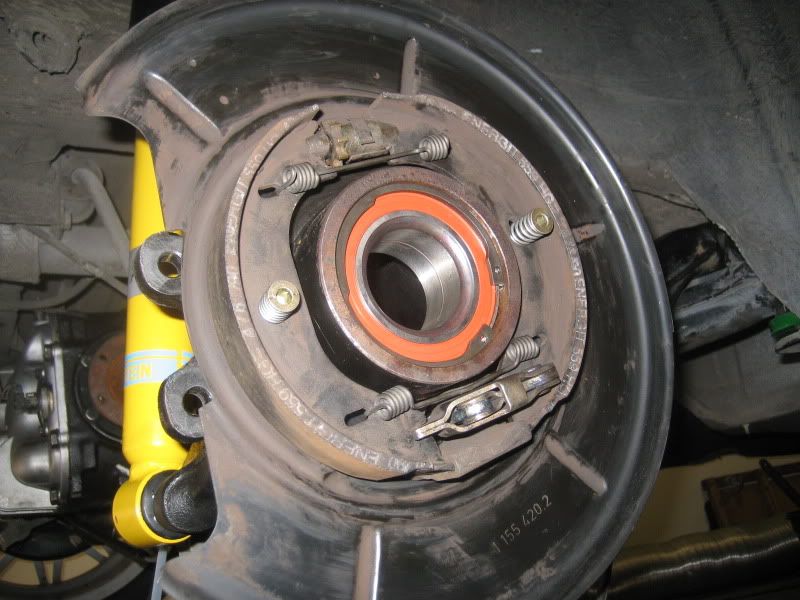

    Did you tighten the nuts under the e-brake handle a bit more?
    When I did my rear subframe I read somewhere that the e-brake should hold the car when approx 4 clicks are heard when raising the handle.
    Thank you. I did not tighten those nuts. I suspect it's the tension adjuster in the e-brake assembly. I forgot to adjust it and test fit before I put on the rotors. I will keep the four click reference in mind. That sounds like a good rule of thumb. Thank you for the tip Doorman!
      I didn't play with anything inside the rotors. I'm actually not sure what, if any, adjustment is behind them!

        This is what's behind the rotor. This is not my car or picture.
        The adjuster is at top.

          You should be able to rotate that thru one of the holes in the rotor.
          Think "old fashioned drum brake adjuster"
            I thought there would be a hole in the dust shield, but nope. Thanks again BMW.
