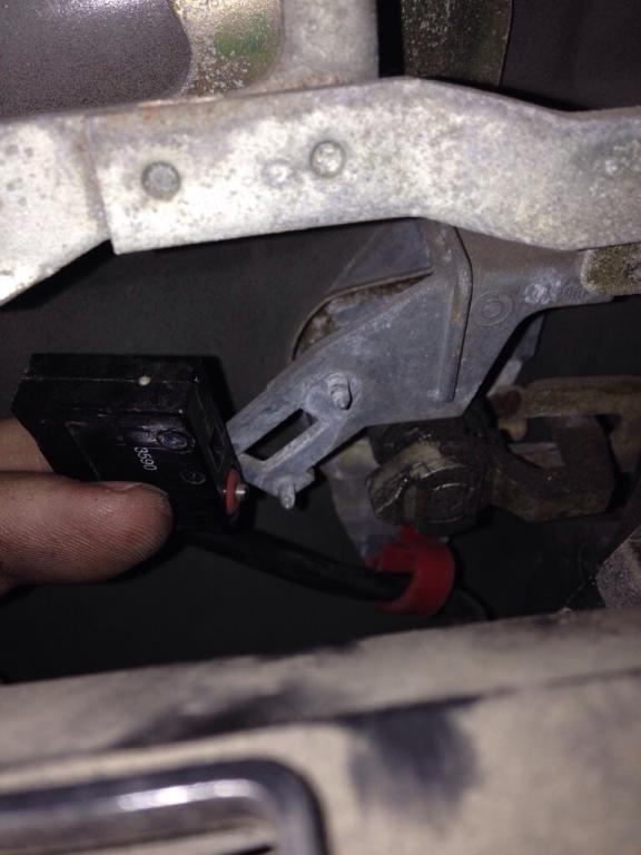

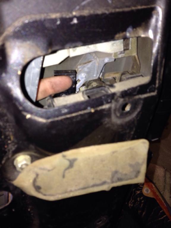

      The PO said he disconnected something in the doors that makes the doors lock, because he kept getting locked out. Hmmmm... So yep the linkage on the actuators was disconnected, and the actuators were both unscrewed from the doors and laying in the bottom of the door. The micro switches work, and were also hanging free. So it appears the "locking out" issue is easily explained- with the micro switches functional but dangling, contact with anything (window, inside of door) would lock the doors as the switches swung freely in the door.
      Sure is tough to work in that tight space.
