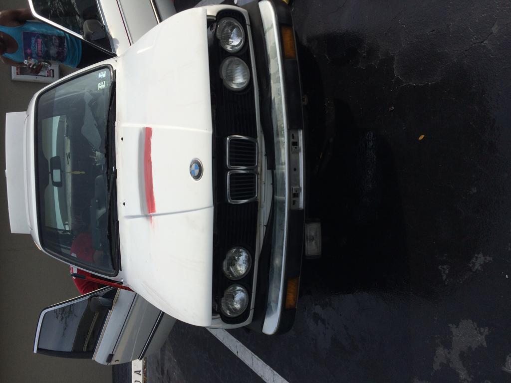

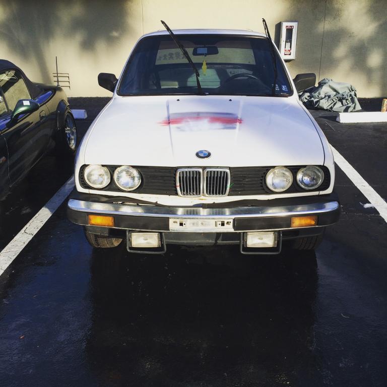

    Hey guys so my friend and I recently went 50/50 on an 1984 325e shell that we scooped up from a friend! This car is both of ours first E30. So far due to school and finals (We are both mechanical engineering students) we have done a few minor things before starting this build thread.
    When we first got the car we knew the car had some rust but we didnt know how much... lets just say we car easily Fred Flintstone this car around hahaha. From the pictures you can see where the car has rust. We did clean and spray these areas with rust converter to stop the spread of rust for the time being until we can officially start rust repair.
    The car only has axles and a diff and all of the remaining bushings are shot. Our brakes maybe work... havent tested them yet.
    The car has 3 different headlights and a spray painted something on the hood.
