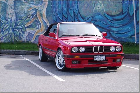

      Also this is what I am modeling my car off of, its what I am going for.
        Originally posted by Mastrcruse
        Yea, so I am going to have the guys that put the new top on look at the hinges.
        Funny thing, when you said you were going for the look of my car + the plastic bumper swap, I thought of that very same red car!

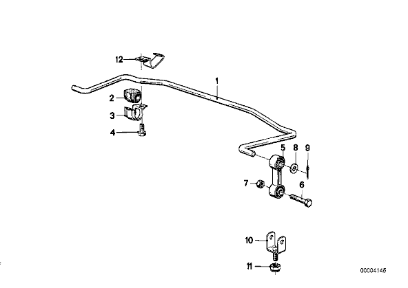

        About the noise - did you ever look at the sway bar mounts on the back, they are common weak points...both where the mount on the body and where the linkage mounts on the control arms. this could cause a clunk/thump especially on corners.
          What numbers am I looking for? I just want to make sure before I get under the car.
          Thanks
            Thanks
            Where 10/11 mount into the trailing arm of the car, and where 2/3/4/12 mount into the body. You'll need to probably jack up the rear of the car to see 2/3/4/12, but 10/11 can be see on the ground from behind the car...easier on the pass side instead of drivers, due to the exhaust.
                      Now what should I look for? Should I shake the part and see if its lose? How will I know its bad? And what part usually goes bad?
                        The mounts on the trailing arms should be pretty obvious - if #10 is loose or in some way not firmly attached to the trailing arm then you have a problem. There is a triangular metal tab that comes out of the trailing arm that the sway bar mount (#10) screws into. These tabs are know to bend or break - although normally it is with bigger aftermarket bars. Here is a stolen picture from another thread that shows the tab (this one has had an extra part welded on to reinforce it) :
                        The mounts to the body may be more tricky to tell - grab and shake the sway bar and see what happens, just make sure the car is very securely raised up...as you will be under the car shaking it! Here is a pic from under my car. I have the IE sway bars with the reinforcment mounts, so yours won't look like this...but it will give you an idea of where to look. Instead of the silver block, you should see a half-round metal bracket that is holding the bar to the body of the car - see if the bracket is still firmly mounted to the car.
                                Great look to shoot for. I would add smoked Euro Ellips, and Euro side markers. Consider the euro bumper trim as well so the side marker lights are not present. Perhaps body color on the bumper trim as well?
                                Keep the vision alive and stay interested is the key!
