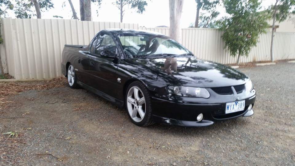

    Decided to buy something fun. Couldn't be bothered doing an LS swap, so just went out and bought something factory LS powered.
    It's a VU Commodore SS ute.
    This is how I bought it.
    Specs Revised August 2016.
    Standard LS1
    25% Powerbond under drive kit
    ARP crank bolt
    Pacemaker Tri Y style headers
    3" De Filippo twin exhaust
    CAI. Will eventually switch to OTR and MAFless
    T56 trans
    Rip Shifter
    Puck Clutch
    4.11 Full Spool(NOT mini spool) BW M80 diff.
    Tuffmounts Billet diff mount.
    Front Suspension -
    Kings KHFL-22HHD and Koni Red shocks.
    Progressive 300-500 lb/in
    Rear Suspension -
    KHRL-46HHD with Koni Red.
    Progressive 600-1000lb/in
    Nolathane subframe bushes
    Super Pro trailing arm bushes.
    17x8 +33 Racing Dynamics wheels.
    Not sure that I want to daily it because it chews through fuel and I'll probably lose my license. The plan is to clean it up and throw the bare essentials at it to make it into a reliable enough car for drift practice.

    I knew I was getting baited with the title. Love these things though, and your next pic needs to be a burnout

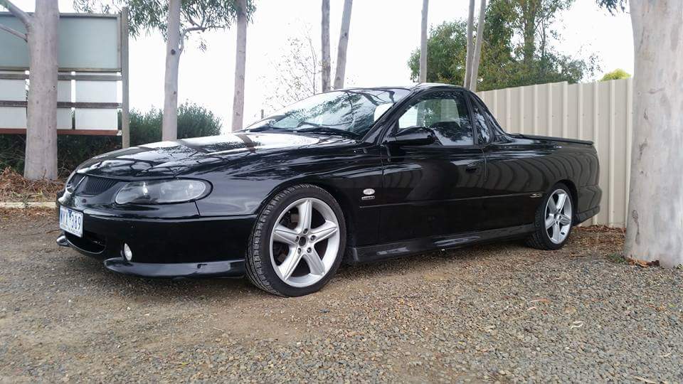

                      Just installed solid subframe and trailing arm bushes and swapped the too low and soft Pedders rear springs for Kings KHRL-46HHD. The HHD are the extra heavy duty rear spring with a progressive rate of 600-1000lb/in.
                      Sits a little higher, axle tramp is pretty much entirely gone and the towbar doesn't dig trenches on acceleration.
                      Next on the agenda is to replace the wheels with something a bit better. The Holden wheels are 18x8 +48. Temporarily installed my 17x8 +33 Racing dynamics wheels but I'm really after something around 17x8 +20. Maybe E39 style 66.
                      INB4 "MOW YOUR OVERGROWN BOGAN YARD". Lawn is now mowed and looking fresh AF.
