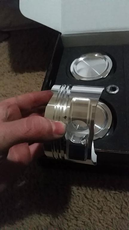

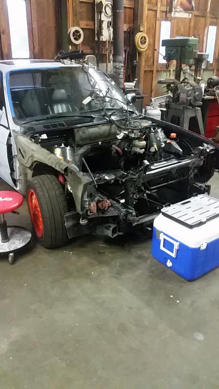

        So far the engine is at the machine shop, it has been line honed and has all arp hardware, bored out to 84.5mm, entire rotating assembly balanced, and it will be back in about 2-3 weeks with the bottom end assembled with the cp 8:5:1 pistons eagle rods and acl bearings. So as of now im cleaning up the engine bay, im doing a shaved bay and a full repaint so thats where im at right now, i want to go with a dark tricoat red, probably will go with house of color because they have some sweet candy reds, but anyways here are some pics of parts and the car and the start of the engine bay

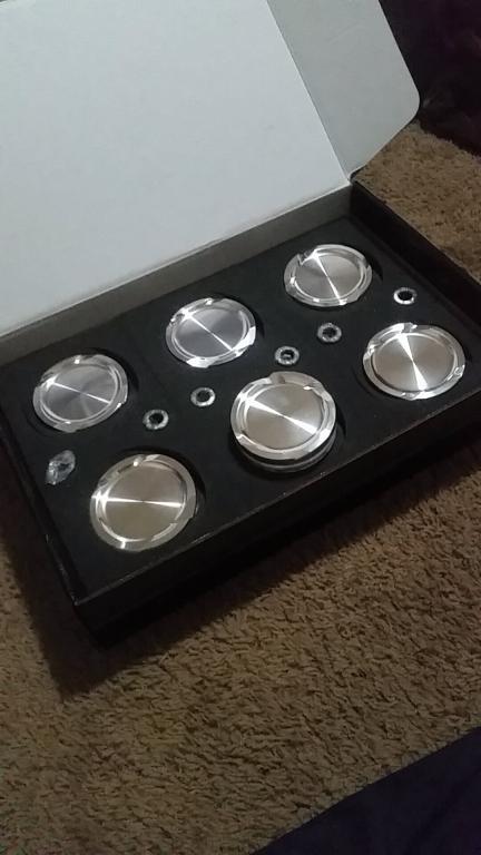

        Cp pistons

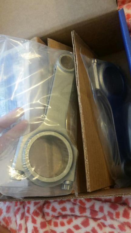

        The eagle rods

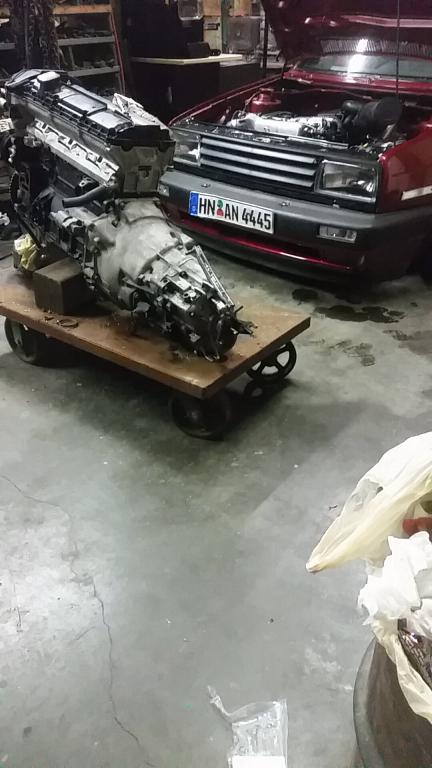

        Pic of the engine out along with my old 1.8t jetta coupe in the back

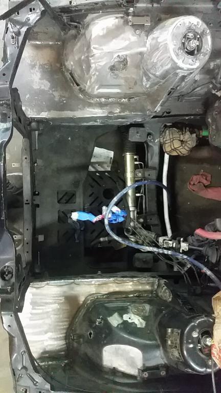

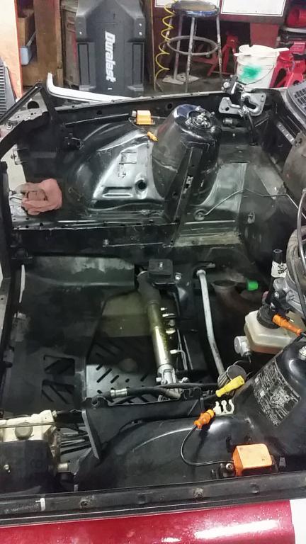

          Start of the engine bay cleanup and shave
          Been working crazy hours for the past couple weeks so progress is slow, but this weekend ill start welding up holes and hopefully will get alot done, pics so far Click image for larger version

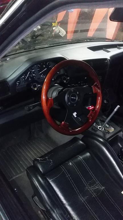

          the woograin and aem guages

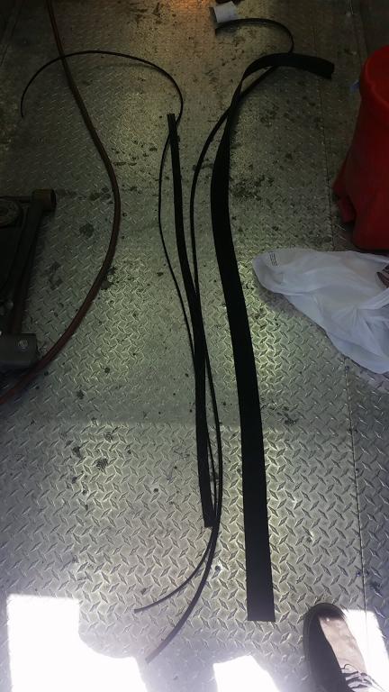

            Went and bought a bunch of nylon wrap and heat shrink to clean up the harness even though its gonna be hidden i still want everything to be as clean as possible visible or not. To stoked for this weekend to get some work done!!

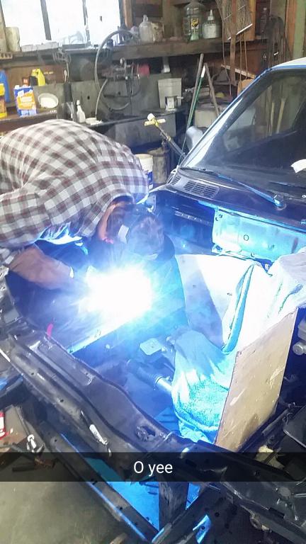

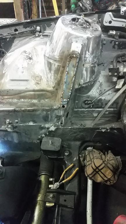

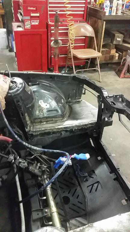

              Engine bay shave and wire tuck
              Started doing some welding, filling up some holes and trying to get some panels for the trays at the bottom of the shock towers mached up,
              had my buddy come and show me how its done haha he does rust repair on old porsches and ferraris

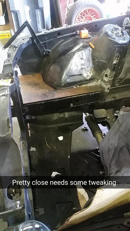

                  • Booostede30
                    • May 2016
                    • 24

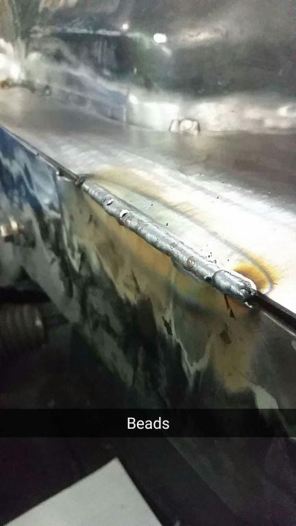

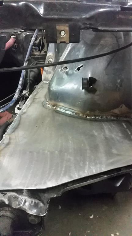

                    I got the panel at the bottom of the shock tower welded in. I have a couple of questions though it seems like most people weld it completely in then grind out the welds and then bondo over the welds at the seams, it sure looks good but my concern is having it crack overtime, id like this to be quality and last along time for shows for years to come, any input from people who have done this? Seam sealer would be nice but i want the bay to look like glass and completely smooth
                    A picture of the panel welded in, some of the welds were shitty i was on my own for this one,

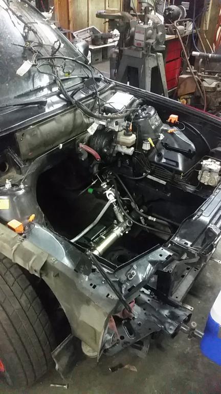

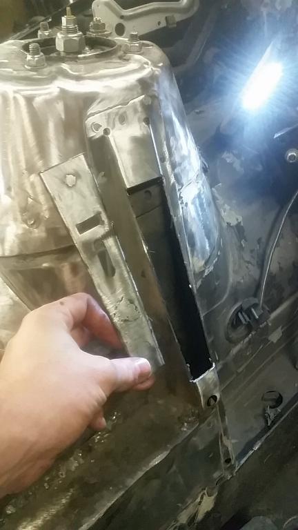

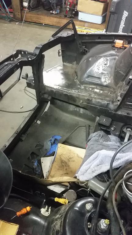

                      Some progress lately
                      Got the other side panel welded in and started to try and remove some seam sealer on the left passenger side also got a couple holes welded in

                          Welded in the small panel on the shocktower after work today

                            how are you going to stop it rusting behind that panel?
                            Boris - 89 E30 325i
                            84- E30 323i
                            • Booostede30
                              • May 2016
                              • 24
                              Im planning on spraying an undercoat on the inside of the inner fender wells/ wherever there's welds. Should make it look clean even though you won't see it but it will protect well against rust more importantly
