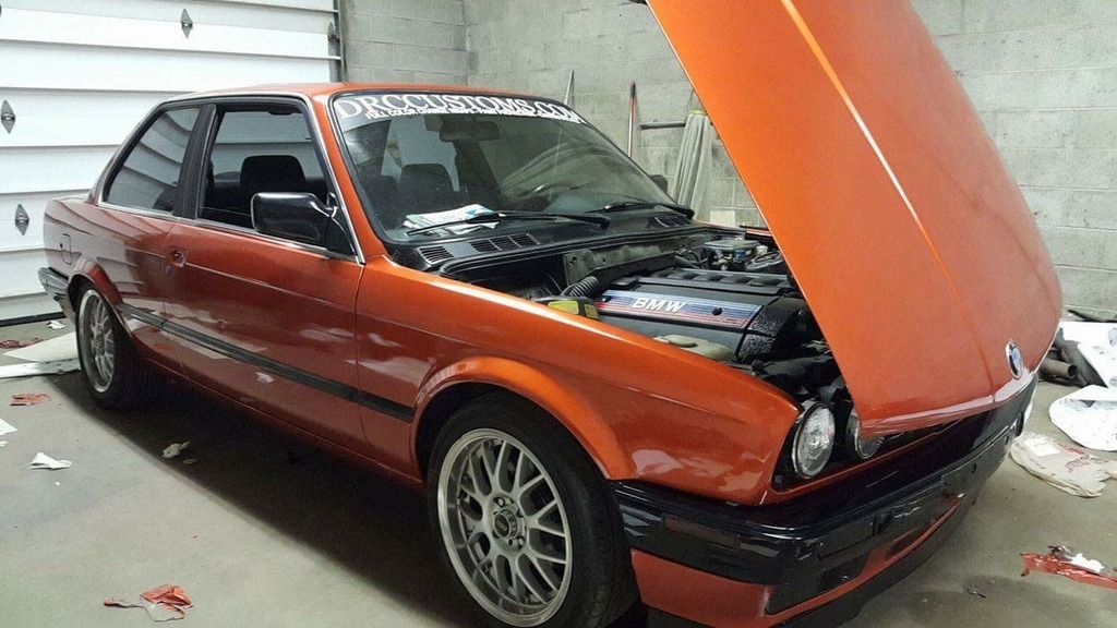

    Now that she's done and in my hands, the name will make much more sense.
