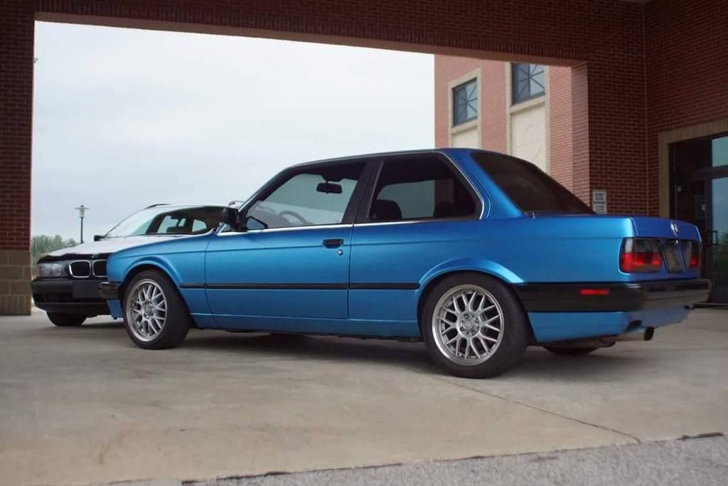

    Hey guys,
    I'm back again, with a much nicer baseline car. Low mileage chassis, rebuilt engine, and a custom wrap is included in with the price!
    I'm excited for this one.
    These are the specs per the PO:
    93 m50b25tu swap using all the right parts. oil pan, rad, etc.
    S50 cam
    ebay headers
    straight pipe
    scorpion muffler
    new clutch Luk unit under 2k miles on it
    new shifter bushings
    ebay short throw
    5 speed getrag 260
    3.73 lsd
    all new bushings and wheel bearings in rear
    new tie rods and ball joints
    lowered on h&r sports
    koni struts
    bilstein rear shocks
    asa bbs reps 16x7 20mm spacers
    decent tires
    drilled slotted rotors and ceramic pads
    depo euro smileys with 6000k hid
    smoked euro tails
    new gas tank and drive side sending unit
    m-tech steering wheel
    convertible sport leather buckets
    pioneer head unit
    manual cooling fan
    20% Tint all around
    I'll show some pictures now, and give more info later today.

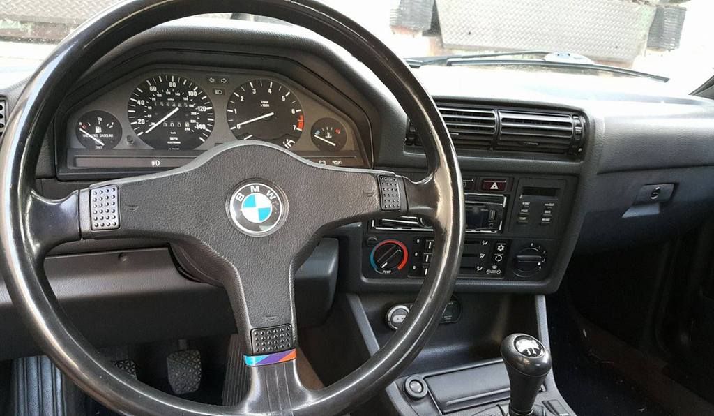

    Now that she's done and in my hands, the name will make much more sense.

      love the mstrip theme!
        Thanks!
        I kinda wish it had them on the hood still, but it might look out of place on an orange car.
