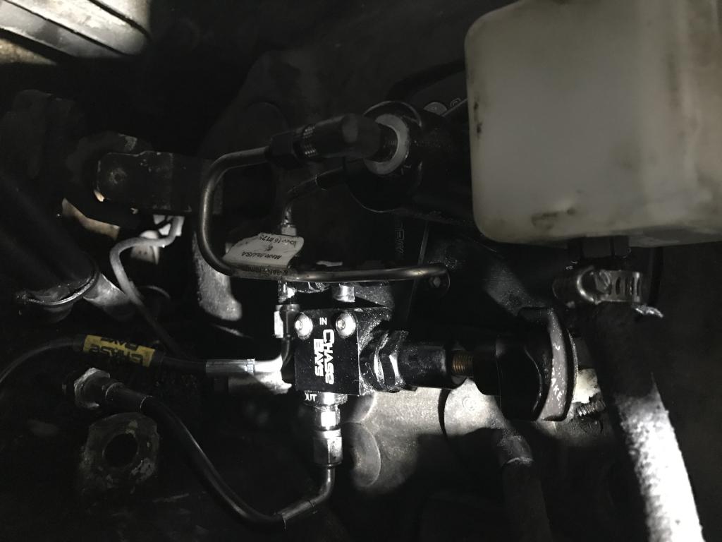

          Got the ChaseBays Booster delete kit installed. It comes with a wilwood master and the proper lines if ordered in the kit. Abs delete and all. Easy install, just takes a lot of Bleeding, hawk HPS pads or better, and some high temp brake fluid. I got Garagistic brake lines, and the pads which will be installed soon. Arm is healing up slowly but surely.
