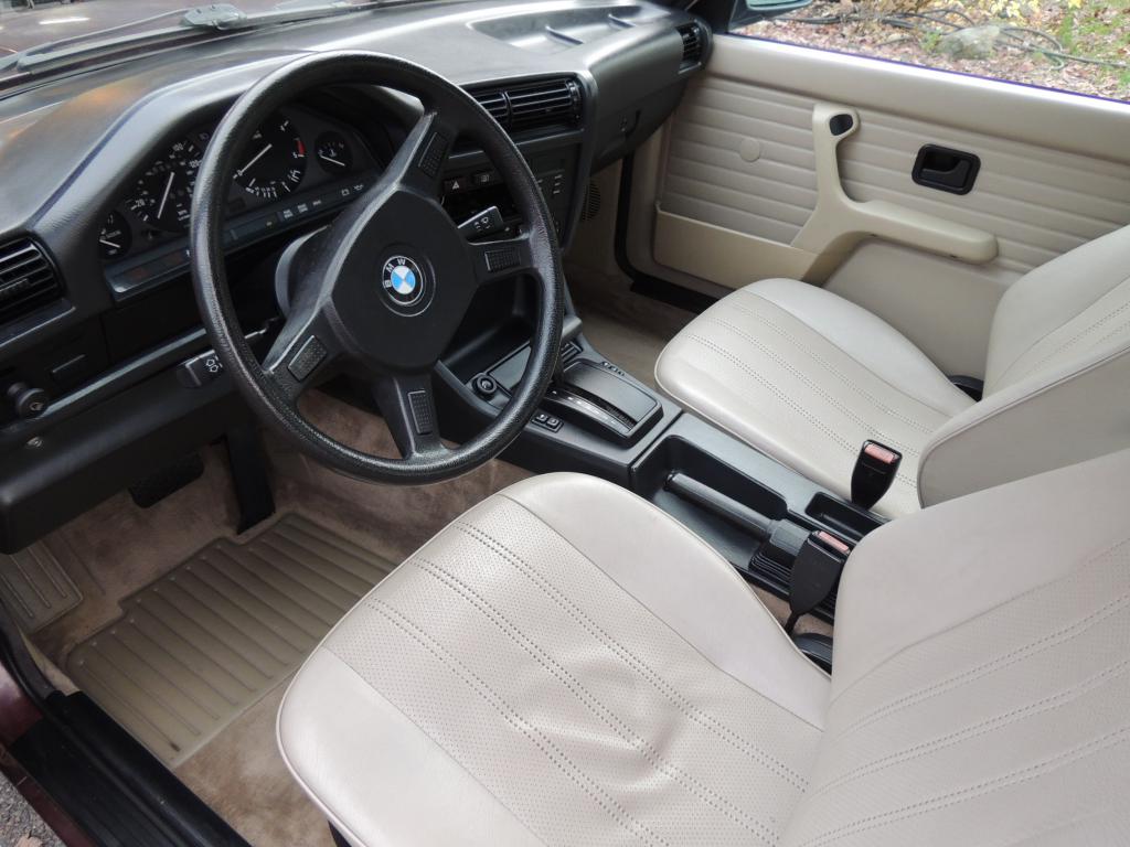

  • MSGGrunt
    • Aug 2016
    • 198
    One of the interior.

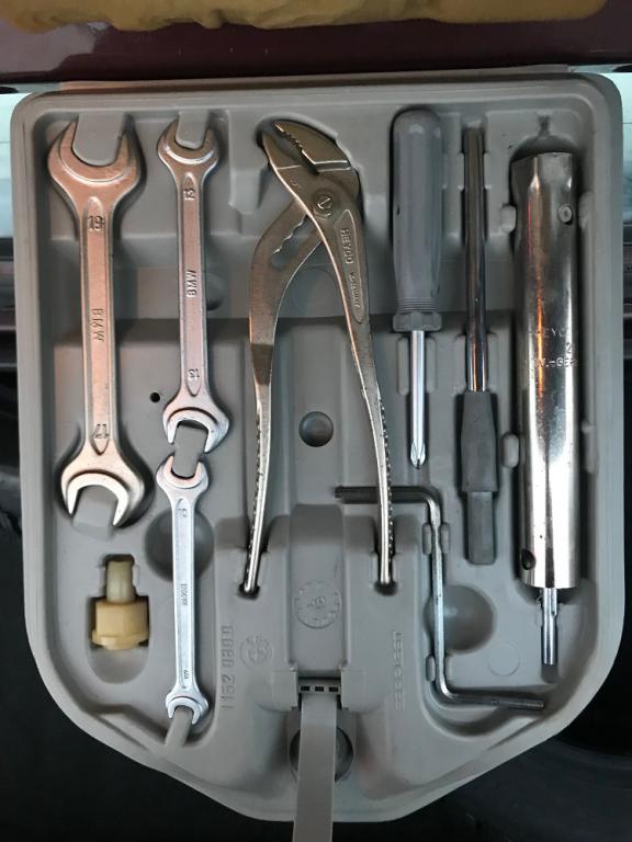

      Complete tool kit and even the original first aid kit is still in place. How often do you find a 31 year old E30 with these?

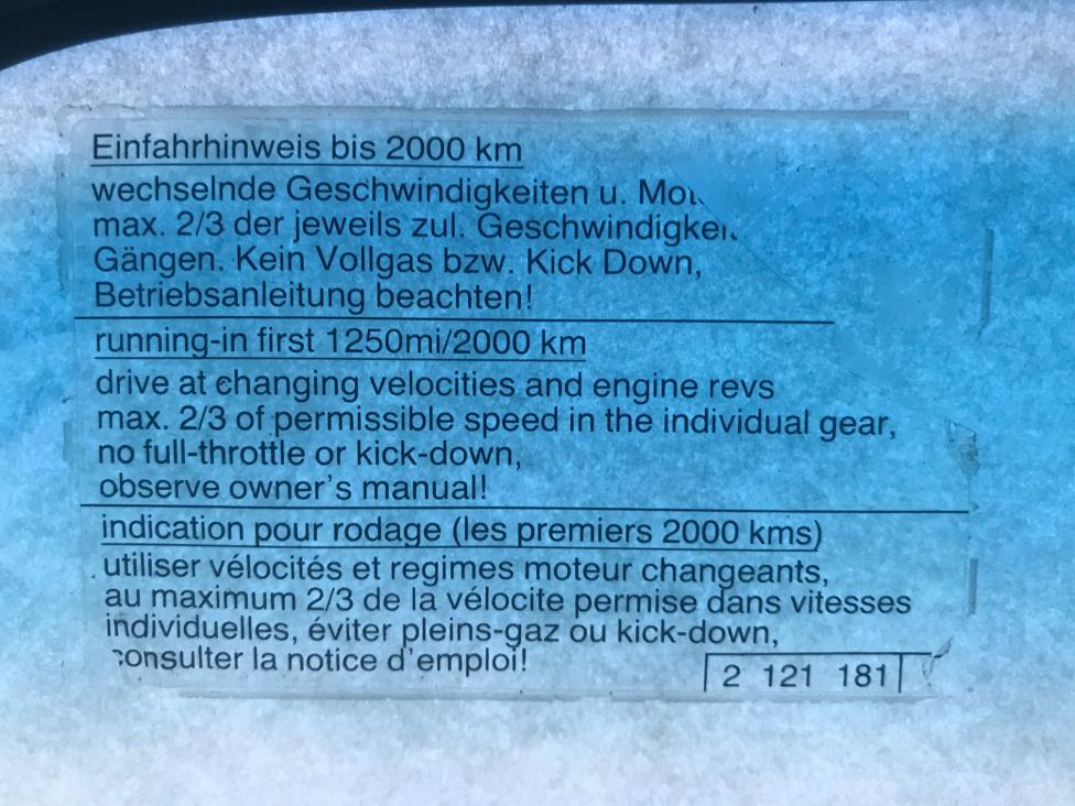

      • MSGGrunt
        • Aug 2016
        • 198
        Original break-in instruction sticker on original pit free windshield. I have never seen this before, not that I am an expert in E30's.

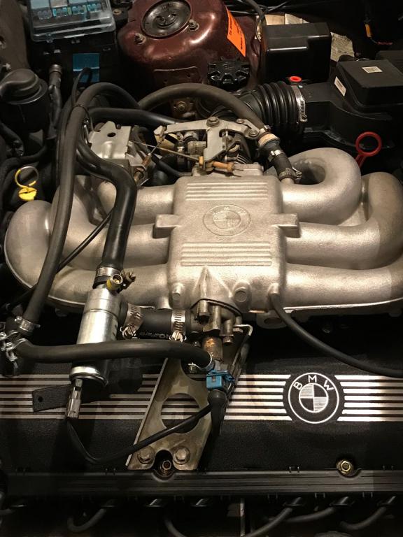

        • MSGGrunt
          • Aug 2016
          • 198
          Engine compartment after a good cleaning and a new radiator overflow tank, vacuum hoses, PCV hose and other small details.

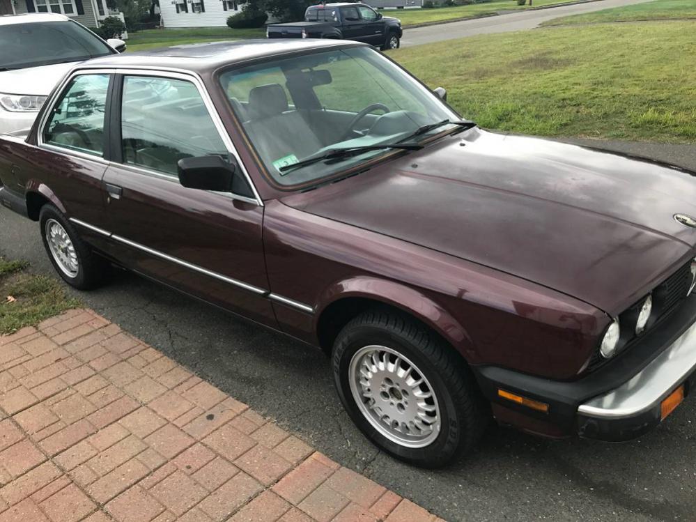

          • MSGGrunt
            • Aug 2016
            • 198
            The paint looks better in the pictures than it does in person. The hood and roof are very sun faded.
            No matter what I do to the interior it will be 100% reversible. Any modifications will be done on different door panels and swapped in sport seats that way if and when it is passed on to a new owner it can be done so in 100% original condition, even down to the 14" bottle cap wheels.
            The "E" is, in many enthusiast's opinion, kind of the unloved E30 from everything I have read. You go on Bring a Trailer and you hardly ever see and E30 325E for sale and lots of times when you do it has had the motor swapped out. This makes me wonder if the car will eventually regain some collector status much the same way the, until recent years, unloved 65-69 Porsche 912s? Regardless, I would bet any unmolested original E30 will only rise in value as more and more succumb to rust, accidents, drift cars, etc.

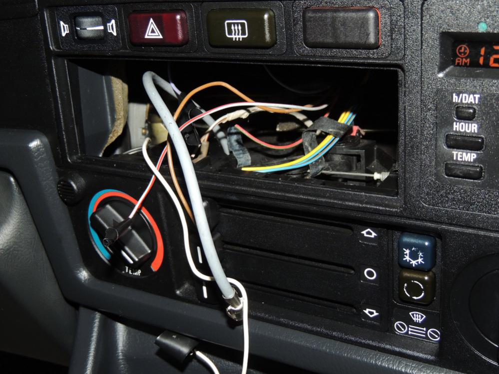

            • MSGGrunt
              • Aug 2016
              • 198
              As clean as it is I did find a few things that need taking care of.
              - Interior lights don't come on when the door is open but, they do work when you manually manipulate the switch.
              - Needs a new driver's side door seal.
              - Needs a new period correct radio and the factory wiring fixed. Whoever did the previous radio install just cut everything. And I will need a new antenna.
              - Driver's seat does not fold forward. No issue, I am putting in sport seats.
              - Handle/extension on transmission selector not working easily. In fact I can pull straight up on it and it easily pulls right out of the transmission selector mechanism.
              - OBC not working. Already replaced with the Euro clock.
              - Speedometer not working
              - Driver's door lock doesn't lock/unlock the passenger's or trunk.

              • MSGGrunt
                • Aug 2016
                • 198
                Butchered radio wiring.

                • MSGGrunt
                  • Aug 2016
                  • 198
                  I fixed the hunting idle issue. Even after cleaning and hearing the ICV working it still must have been bad because the hunting idle instantly went away with the new ICV. I am very happy with that.
                  After driving the car back and forth to work this past week I have a few minor things to attend to.
                  - I will need a new AC switch
                  - The overhead check panel always shows that I have a brake light out but, they are all working correctly. I even swapped out the panel with no change.
                  - A few of the backlights are not illuminating things like what gear you are in, the temp control knob, and the middle center vent slider control.
                  - I have a clunk in the rear that may be a worn out guibo. It does it coming on and off power.
                  - The speedo gears have been replaced but, am still waiting on a new speed sensor to arrive in hope that that fixes the issue. Other than the speedo, everything else on the cluster is working properly.
                  - Missing fog lights are on their way.
                  - Need to fix a messed up brake pad wear sensor harness.
                  I have replaced all the brake pads and rotors.
                  Put in a new radiator overflow tank and replaced vacuum hoses.

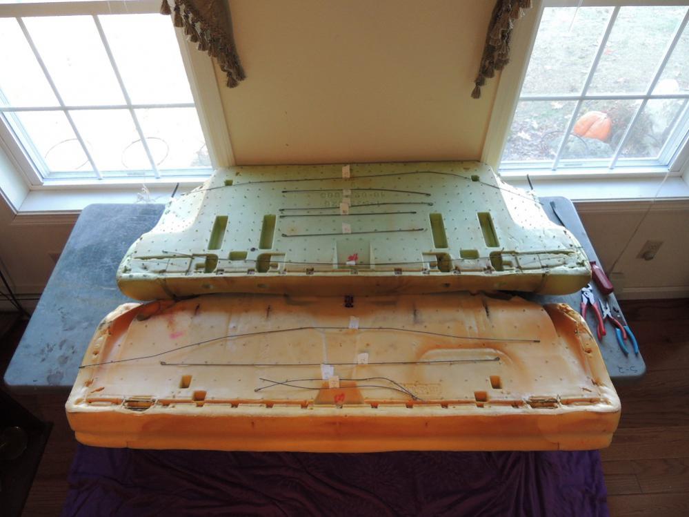

                        • MSGGrunt
                          • Aug 2016
                          • 198
                          In preparation for the new leather upholstery I went ahead and stripped the back seat of its original vinyl. I am hoping this will be a satisfying project. I also stripped on of the sport seats. The back seats were quick and simple, the front sport seat, though not overly complicated, have A LOT of hog rings that need to be clipped. I was sure to take lots of pictures and mark all of the wires and where they go. I am hoping I can pull off a decent install of the front covers. I found this video series to be very helpful and very detailed.
