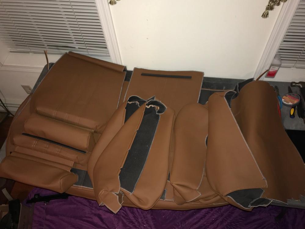

            Today my leather arrived from Lseat.com for my interior project. The front and rear seats will be recovered and the door panels, door pulls, door pockets and rear parcel shelf will be redone to match the darker leather.

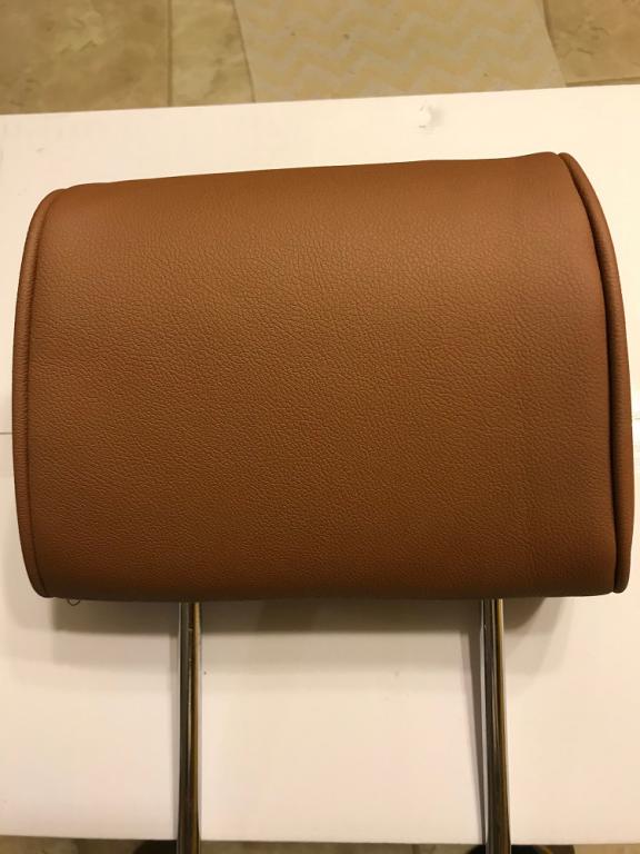

              The first and easiest piece was recovering the headrest. I wrapped the foam in a plastic shopping bad to make it easier to slide in and then removed it.

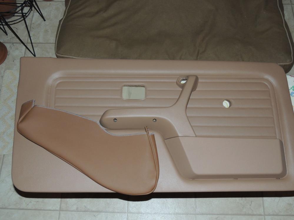

                        I went to a local auto paint supplier who mixes custom aerosol cans and they scanned the leather and mixed up a can of paint to spray all the other interior pieces to match the leather. As you can se in the picture the match is a little off. I will take the pieces I "painted" in with me and have them mix up some more paint that is a bit darker brown.
                        I am no paint expert but, the shop specifically stated that the paint would work on vinyl and hard plastic. Probably a flex additive in it or something. Not any different than SEM or Dupli Color's vinyl and fabric paints.
                        One of the hardest things is finding hog rings. I assumed I could find them locally but they seem to be enough of a specialty item that I will have to order them.

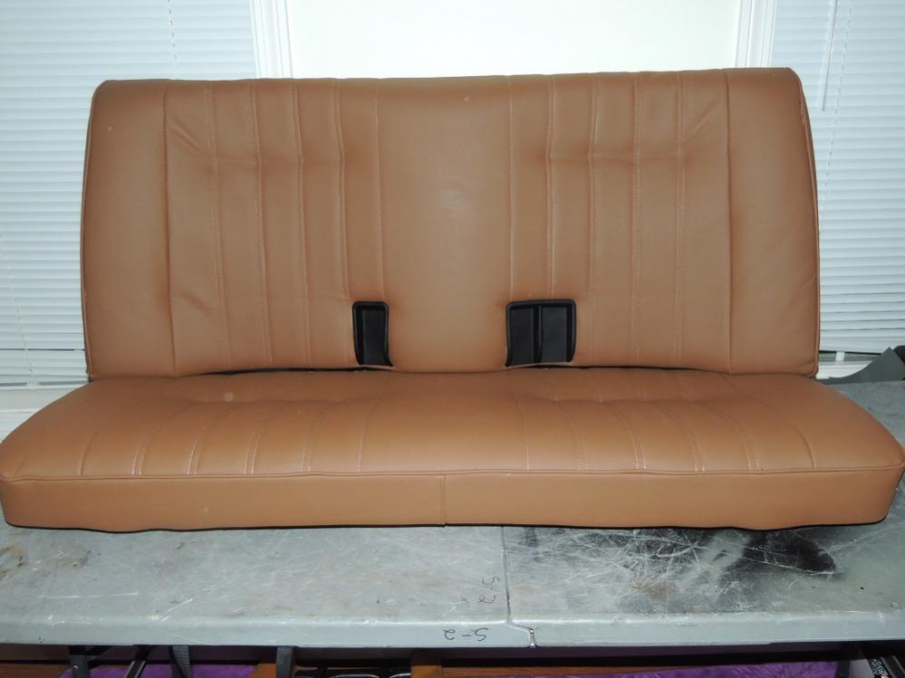

                              Rear seat recovered. A couple of puckers on the backrest portion, but overall I am happy with how it turned out.

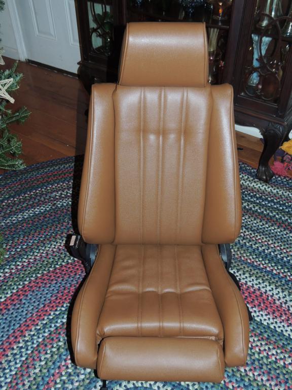

                                One of the two front seats is done. The front leg support didn't turn out as nice as I would have hoped, but overall I am pleased with the covers, especially in leather and only $299.00 for the non piping option. I paid I believe $329.00 for the covers with piping.
