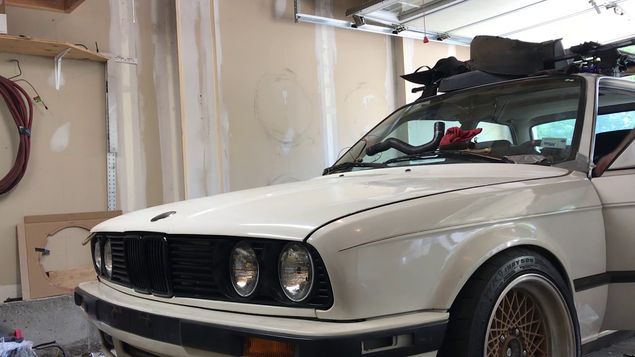

              Picked up a Tech 1 spoiler to compliment the Alpina 162
              I'm also now sitting pretty on nice new 195/45s
              I've also begun cutting out a nasty rust spot on the scuttle panel that stemmed from the front fender rubbing through the paint. Amazing how problem spots grow.
              I'll remove the windshield and sort it out once I get a test drive under my belt.
              As my garage is small, I don't have the space to warrant having an engine hoist sitting around. This is how one ends up installing a CD009 solo without a lift.
              With the gearbox now in, and the shifter nicely situated within the e30's interior trim, I'm begun buttoning up the engine "permanently".
              I should have it all wired/plumbed this weekend.

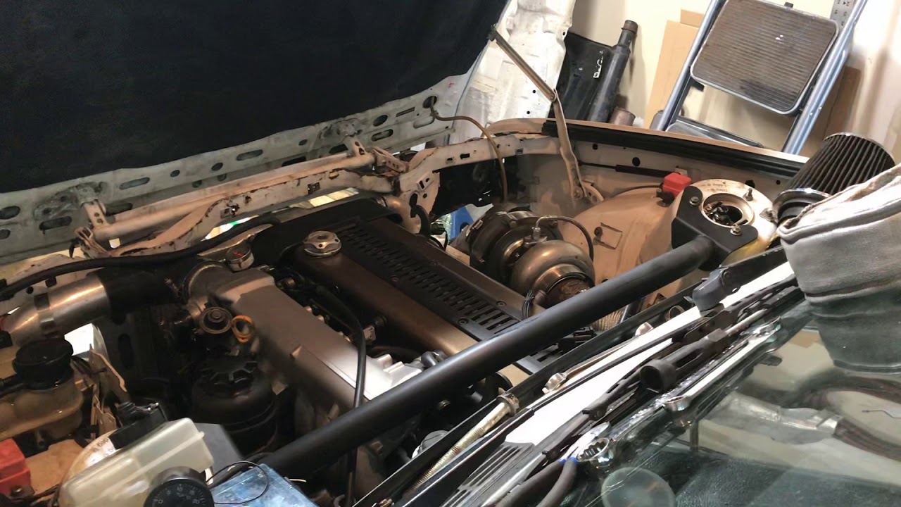

                          Noises! Sounds just like a Toyota should.
                          I jammed an intercooler elbow into the open downpipe, then stuck every exhaust box I have in line behind it.
                          This way it is quieter than the S4 and nobody will complain while I tinker
                          That is idle with no adjustment for the larger injectors, as it is all wired straight into the ECU without the Apexi AFC.
