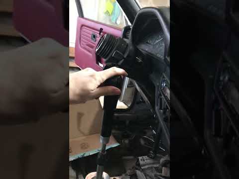

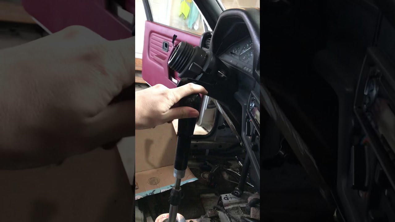

          I have adapted an adjustable gear knob to work, which can be filled with weight to get things shifting perfectly
          I've played around with a discrete hydro idea, but I'm undecided if I'll use it

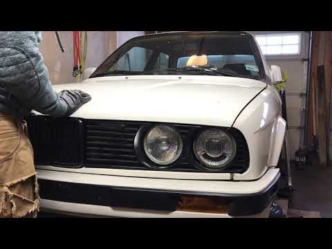

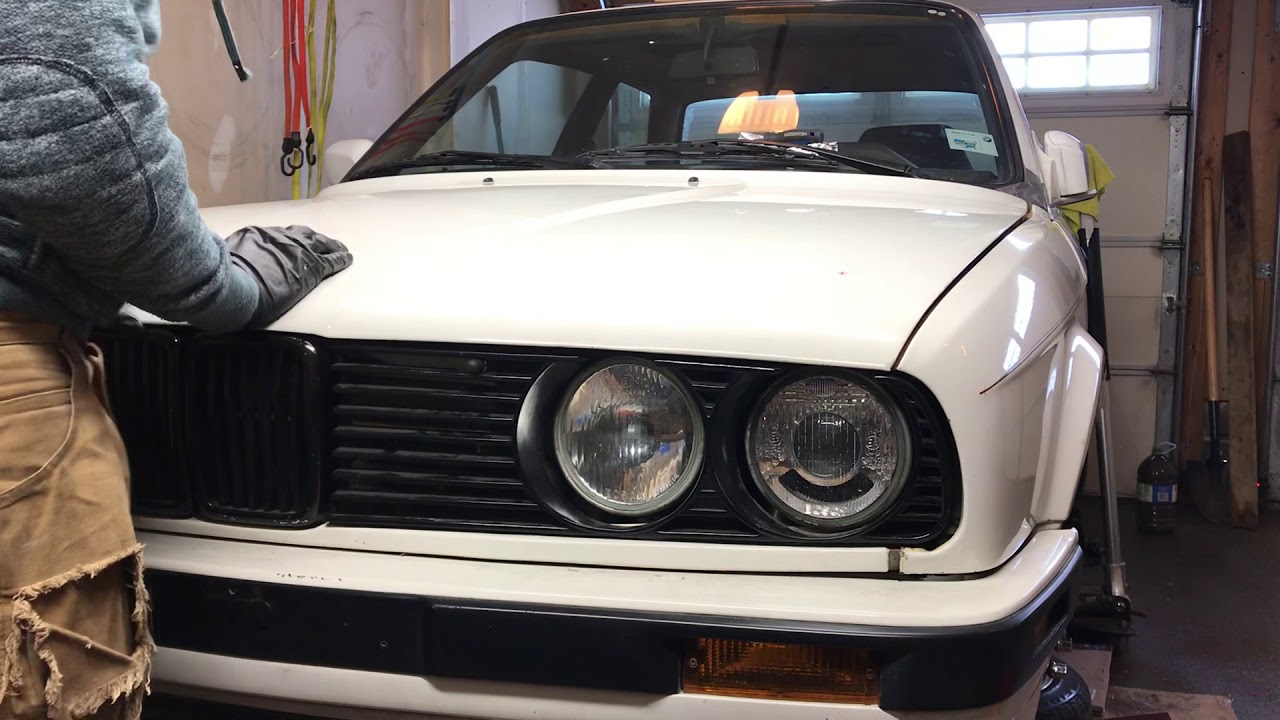

                        My latest mind cruncher - how to latch the bonnet now that I've removed all of the latching mechanism?
                        To get the biggest radiator possible into the front of the car, while allowing room for a decent puller fan, I had to chop out the latch mechanism way back when.
                        I have a pair of really nice aerolatches left over from the SC300 parts car, but it is hard to take the drill to an e30 bonnet these days. Having spent so much effort hiding everything JZ related, it'd be a shame to have the race car latches suggesting there is anything more than an m20 under the bonnet.
                        Here is one I saw online, and I noticed that the latches force the curve of the bonnet flat, creating dimples..
                        Sooo...
                        I made a sleeved rod that is spring loaded towards open. My thoughts here were that in the event of the sudden onset of fire, it'd be nice to not have to fish around with one's fingers.
                        Video!
                        $0

                        Homemade super tall shifter

                          What's that? You're bored? Stuck inside? WhY DoN't yOu PaInT 'Yo CaWwWw!
                          Sure thing bwain!
                          The last car I painted was over 12 years ago, so time really does fly.
                          At that time I was 22, living at home and driving an e30 m3. What a baller young man.
                          Fast forward and instead of rolling into a spray booth with a Devilbiss gun, I'm operating out of a clutter shanty with ma rattle cans.
                          The real story is that I'm done spending money, but not spending time. This particular e30 isn't for the show and shine life, but I plan to daily it in the summer months so I at least want it presentable.
                          I only started a few days ago, but things are going really well. I'm still doing all of the rigorous prep of staged block sanding etc, only the paint itself is bottom shelf stuff.
                          Some shots of what I'm working with, and where I'm getting to:
                          BEFORE - Some PO's efforts..
                          IN PROGRESS - my own efforts
                          Pre-wet sanding and clear
                          During wet sanding
                          Post-wet sanding, but pre-clear (the panels are sponge wet to see what lacquer should look like)
                          So...it'll be a panel at a time before hitting the door jambs and unibody in the coming weeks.
                          I think Youtube does an injustice to what can be done with no tools, as the Youtube Rustoleum Brigade general have a dip in and do zero prep.
                          No, it isn't Alpineweiss II, but the thing is already missing a BMW engine and has Pontiac wheels, so it is par for the course.
                          Could I have rented a booth? Sure, but this way I can prep & paint as I go. If I mess up, it is so easy to fix. Fender bender/drift damage?......click-a-click-a-click-a-fixed!

                            Of all things, the weather has stopped me in my tracks. Snow yesterday and consistent negative temps in the garage.
                            Nevertheless, I'm getting through things and believe I'll be all done within the next 3 weeks.
                            The absolute atrocity that has been rattle can 2K clear
                            Wet sanded and quickly buffed - much better!
