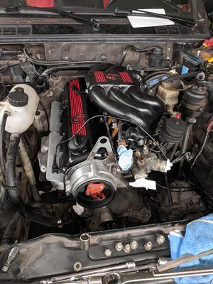

          So, for a more interesting update, here is the engine as it sits today;
          I should receive the throttle body gasket today, so I can install the TB and the vacuum lines, and the last of the sensors on the wiring harness. Then, if I can find a belt that will fit I can put the water pump pulley on, and hook up the cooling system. Need to hook up the exhaust to the manifolds still. Need to get new spark plugs, and a drop in filter (leaning towards a Pipercross), change the oil and that should be it.
          I don't have the SSSquid chip yet. But I figure I can break it in on the stock ECU, install the chip whenever I get it, then change the oil around 500-1000 miles. It will run crazy rich, since it has 19lB injectors in it, but at least it won't blow anything up. Well assuming I put everything together correctly.
          Oh I also didn't get the eBay exhaust, because they seem to be out of stock with all the vendors now. One of them told me they should have more in 2 months. Guess they are waiting on a new shipment from China. Bummer.
