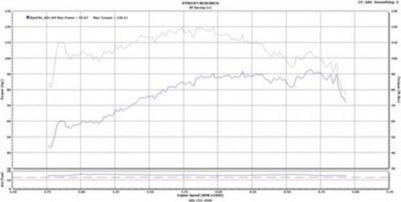

          So 4 months since last update, what has happened..... Oh yeah the world went to HELL!
          Anyway, in e30 land. I had this done last week;
          Thats what a bone stock (well except for the "i" dual exhaust) 34 year old ETA is good for;
          92HP and 120lB/Ft torque at the wheels.
          If you add 15% driveline loss that would be about 110HP and 140 torque. Honestly that HP number doesn't seem that bad to me, with just 120 (127? I've heard both, so who knows) stock new. But the torque is pretty low considering it should have been 170 new.
          Whats even harder to make out is the A/F ratio at the bottom. Its roughly at 15:1 the whole range. So it is running prettty darn lean. This most likely is dirty 34 year old injectors.
          But why in the world would I both getting a dyno pull on a stock ETA anyway you might ask. Well because this;

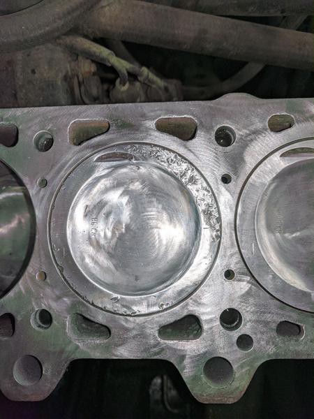

            Got the head and manifolds off, and started cleaning the deck and piston tops. And then I came to piston #4 and found this;
            Every other piston looks fine. Top of chamber looks the same, but no valve damage that I could tell. So I assume some time in the past ownership it broke a spark plug tip off. The damage doesn't look bad enough for it to be much of anything else. Because budget build not touching the bottom end, I just smoothed it with the dremel and I'm going to move on. I know this is a risk, but worse that happens is it blows a ring and I loose compression, and I have to replace the pistons. Everything on the top end should be fine even if this does go wrong. At least that is what I'm thinking, hopefully i'm not wrong. To that end, the cylinder walls look to be in pretty good shape. you can see a few light scratches on the wall, but can't even feel them with finger or nail.
            I never did a compression test on this engine, which I am now regretting. I will now when it is back together, and I should see right away if there are problems in that cylinder.

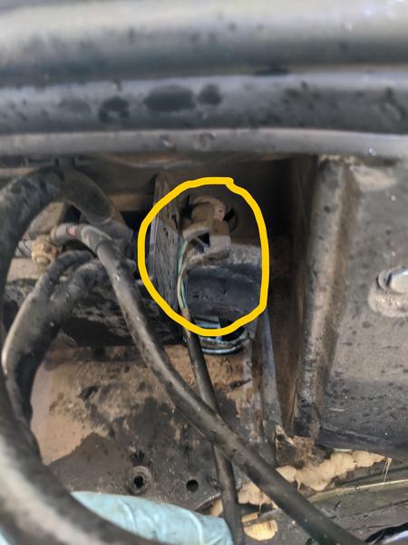

                  OK, next question.
                  What the heck is this sensor. It is on the firewall, to the right of where the positive power cable from the main harness attaches. There is no connector for it on the "i" harness. I wasn't able to track it down on realoem.
                  I assume its fine if I just abandon it, but maybe I'm wrong, do I need to wire it in somehow?

                  • e30sh
                    • Apr 2015
                    • 618
                    #99
                    Don't recall what that is but you don't need it converting to an i harness.
                    You will need to enlarge the firewall hole to get the i harness into the cabin. e harness hole is a smaller diameter..
                    I would add manifolds after the head is installed since you are doing it without a hoist.

                      Originally posted by e30sh
                      Don't recall what that is but you don't need it converting to an i harness. You will need to enlarge the firewall hole to get the i harness into the cabin. e harness hole is a smaller diameter.. I would add manifolds after the head is installed since you are doing it without a hoist.
                      I figured if it wasn't on the harness I didn't need it, just wanted to make sure. Yeah, I already enlarged and painted the whole. Got the harness laid in place and some of the connections hooked up. So is it even possible to mount the intake manifold with the head on? It looked basically impossible to get to some of the bolts. But yes, it does look pretty hard to place it on there with the intake already in place. I was thinking of mounting a pulley to the ceiling to help lower it in place. Sent from my Pixel XL using Tapatalk

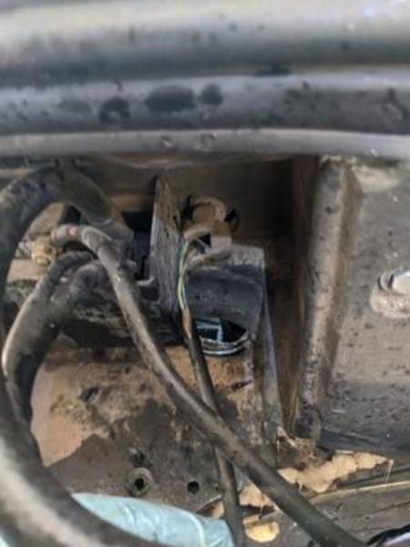

                          So today I put the 7kRPM tach into my cluster. I swapped the tach and coding plug into my existing cluster since I recently replaced the ODO gears, the PDB with a re-soldered unit, as well as SI Batteries. So overall my cluster was better.
                          While i was there I tried to track down if there were any obvious problems with my cruise control. It worked fine when I bought the car, then it started going out over bumps, then it just stopped working all together. I took the steering column apart and inspected the control stalk. Looked good, but from what I could tell you aren't able to open it, so not sure if the mechanism inside looks good. traced it back to the 4 wire connector under the cluster. All wires looked connected in all ends of the connector. Also checked the CC computer above the main ECU. All connections looked good. I sprayed them all down with contact cleaner and gave them as much as a wipe/scrub as I could. Of course I wont see if that helped until everything is back together, but oh well. Is there any way I can test the control computer without power, or a running engine? Like maybe some pin to pin continuity tests or something like that?
                          While I was out there I was just going through parts making sure everything was in place and deciding what to do next. I realized I couldn't find my new head bolts. I know I ordered them.... So looking around, no where to be found. Start checking all my accounts from my preferred online resellers and nothing there. WTH, I know I ordered these things. Finally start searching my email. I find my order from discountbmwparts.com or something like that. Then I see the 3 emails I missed from them saying they didn't have the head bolts and had no ETA, and then the order was cancelled. Then I checked ECS, out of stock no ETA. I ordered them from FCP Euro who claims they are in stock. nearly 50% more than from the first place I ordered them though, that sucks. But hey, I'm not going to cheap out and order Victor Rienz head bolts. This may be a cheap build, but even I have my limits, and I've seen enough horror stories about those bolts to know better.
