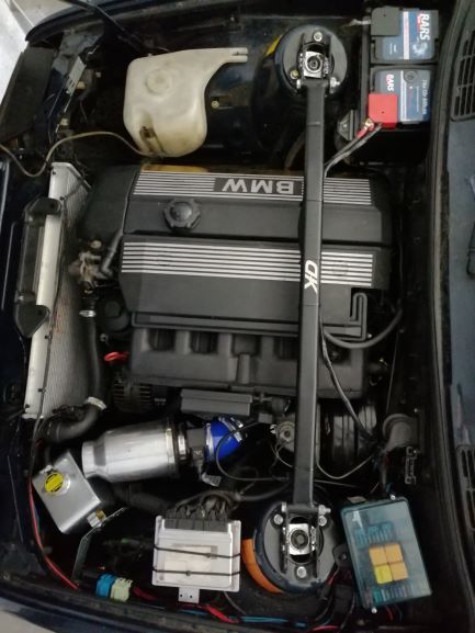

                    Update:
                    Another small update:
                    I debated about installing an open air filter, it's the most convenient solution but I like the more classy OEM style, ofcourse the stock airbox didn't fit because of the alternator.
                    A litte trim was necessary:
                    Also (almost) finished the back end of the car including the axles, all fresh with new handbrake shoes. Still need to mount the hardlines and bleed the system.

                      It's alive!
                      Haven't really updated in quiet a while. But that's mainly because I was too lazy to update this thread.
                      lets start with the boring stuff:
                      I'm probably the only one that is doing this but the center support bearing was under a bit of stress when mounted, so I made 1 out of 2:
                      (the mounting slot is a bit longer)
                      All mounted up, you can see that I needed the extra room:
                      I saw somebody use the factory airbox, and that's why I stated that I was going to use the factory unit. Unfortunately the m54 air intake valve location is placed lower than the m50/m52. Long story short: Too narrow, no airbox just a plain open air filter, but with a nice pie cut tig welded bend:
                      Also connected all the fuel lines to the really ugly fuel filter/pressure regulator, (Does somebody know a nice in line fuel regulator 3.5 Bar???)(51psi)
                      And ofcourse, there was another thing that didn't fit. Made a bracket for the steering reservoir:
                      Now it's time for the fun stuff: Wiring
                      I didn't think it was too bad, just researching a lot, removing a lot and trying to keep everything untangled and labled.
                      I will spare you all the details, but here is the spaghetti mounted in the car:
                      A while ago I followed the EWS delete how to, not knowing if it worked. I was really exited to try to start it.
                      The first attempt was not very succesfull. The car was all wired up and connected to the battery, I turned to key to ignition and all of the sudden it started to smoke really bad. Turned out that you shouldn't wire the ECU ABS cable to the c101 plug if your car is European and not equipt with ABS. Because you basicly connect a ground and a positive wire together.
                      After figuring this out it was time for the second attempt.
                      This is the first start of the m54b30 in the e30 harness. I was suprised on how easlily it started:
                      Really cool to finally hear the engine, now I'll just need to tidy up all the wiring, and all the other things.
                      A car has really a lot of parts
