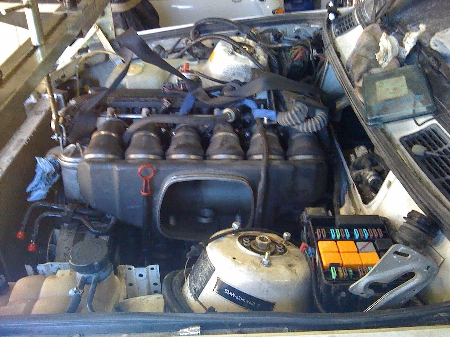

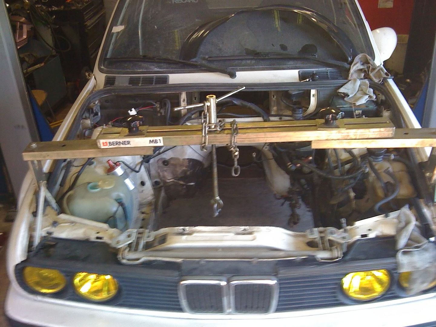

Finally!
M20 out
S50B30 prepped & lookin good!
New wider fender flares
Motor in the engine bay!
