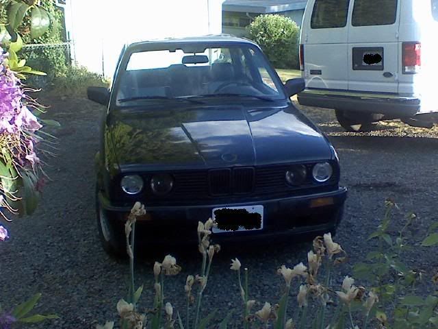

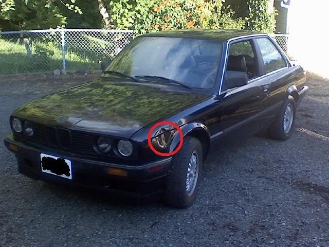

                            So, she is finished, well motor wise. drove it back from salem today.
                            i need to pop the dent out on this fender
                            and the PO ran it through some paint or something, gotta get rid of that too.
                            the car runs strong and fast. well kinda. it has a miss at idle, i cant tell if its a fouled plug or a dead coil. has a exhaust leak near the cats. i need to wire the electric fan. the tach and water temp gauges dont function, im hoping SI batteries. the PO had a E transmission installed somewhere along the way which is causing massive issues vibration wise. im on the hunt for a I trans. suspension is shot, im pretty sure its original (258k!!yeck). i have wheels and tires for it already. other than all that BS im a happy camper.
                            any fellow swappers know anything on the idle/missing issue? it does it all the way through the powerband, not just at idle. the tach and water temp gauge not functioning?
                            ill be happy if i can get this fixed by this weekend for the picnic. i have suspension on the way but bavauto and ups being the bastards they are might not be able to get it to me till the day AFTER the picnic, we shall see.
