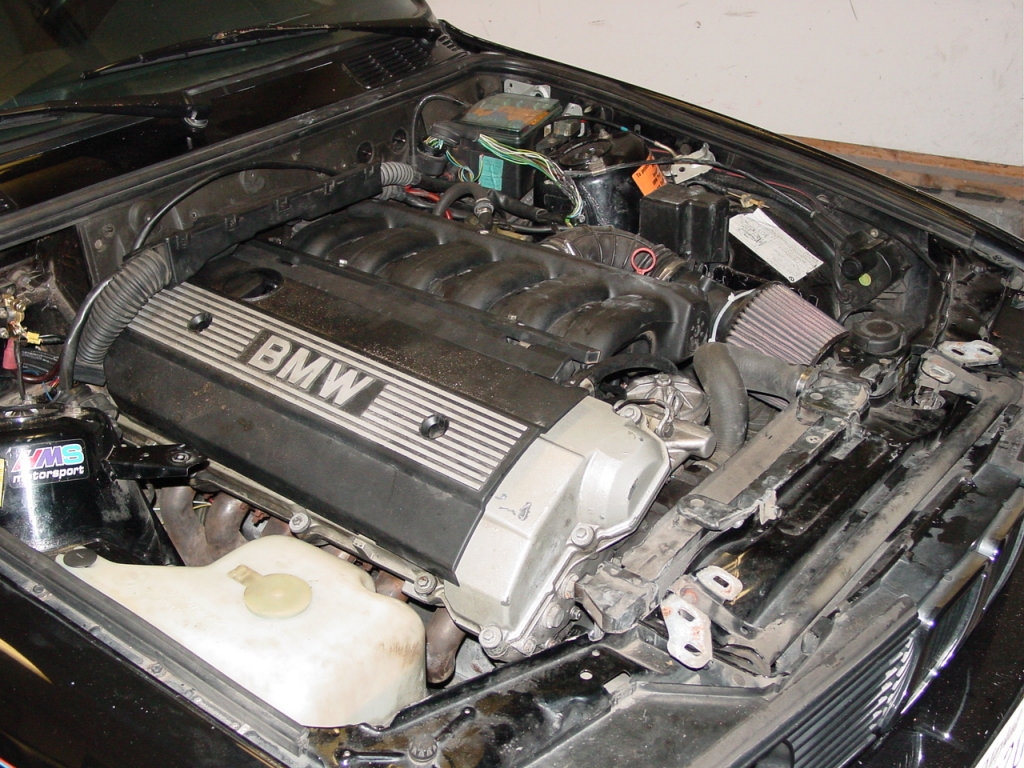

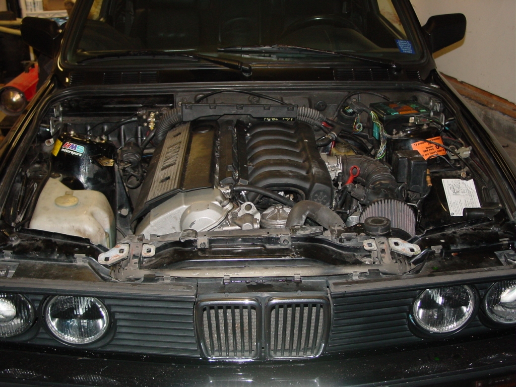

    etasport goes 24 valve
    bout 17 degress in this picture
    aww, its cute
    bitches....
    yes, it runs. But its not done yet. I got behind schedule a little bit with trips to get little parts. I had one wire mixed up but other than that it started right up. Threw a code for TPS and one other. It ran on its own, but it was super rich, hopefully a new tps will take care of that. Exhaust isnt on yet, but in the works. A little bit of wiring and some shakedown and it should be good to go. Oh yea, took 2 days with no more than 2 guys working on it at a time, and about 1600 bucks.

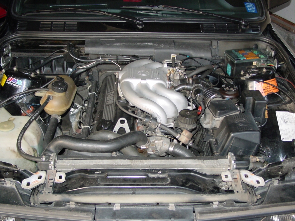

    Old and improved:

      Nice! What motor is it, what headers are those, and what are you going to do for an exhaust?

                  Very nice weekend swap, what are you doing with the 2.7i?

                    looks clean. thats one helluva fast swap. glad to see you were able to use that radiator.;)

                      I would suggest a hose swap on the top so you are less likely to get an air pocket.

                          Thanks, hope to be a little more active in meeting up come spring time. Its just an m50 for now, s50 clutch/flywheel. Kinda undecided as to how the car's future will progress. obd2 manifolds with some kinda e36 downpipes. I'm just going to connect them to the stock exhaust temporarily until I can get it welded up.
                          I'm going to have to fix a lot of things on it cause I was trying to make anything and everything work. The plan was to be able to drive it tonight, so a lot of what you see will probably be temp. The m42 radiator looks like it will work. The fan wouldnt clear but thats taken care of, and the hoses need some work since they didnt really fit well.
                          The m20 is out to pasture. The top end and motronic are for sale as well as most of the parts off of it. Bottem end is pretty much gone and the main reason for the swap.
                          Old and improved:
