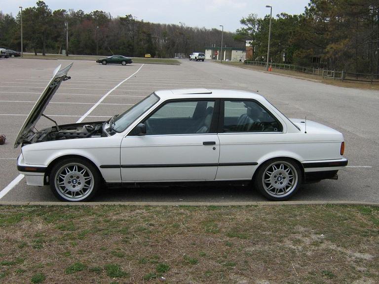

    Hi,
    I bought a 1989 E30 325is. It is more an E30/36 hybrid. It have a M50 engine, M3 E36 flywheel/clutch, E36 325 transmission, 3.25 lsd diff, E36 5 lugs conversion, E36 325 front brakes, 318ti/Z3 rear brakes and Z3 steering rack. Others goodies are Bilstein dampers, H&R Sport springs, strut bar, SS braided brake lines, rear adj camber/toe, brake brass guides.

    I found the 5 lugs conversion section very interesting. I am a bit confused when i look at the suspension mods. What camber plate i must use? E30 or e36? Is the e30 front swaybar will fit or the e36 struts will cause a problem? I read a lot but that's did not answer all my questions. I will need to ask question someday and take the risk to be called a freakin newbie that needs to know how to use the search function. :)

    My new track toy:

                You should consider dropping the 3.73 back in it as the M50 does not have enough grunt to adequately propel it around even with the 1-to-1 5th .
                The 3.73 will really wake that thing up .
                As far as the camber plates , you will need the E30 pieces .
                Same goes for the anti-roll bars .
