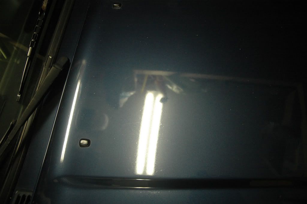

    In any case, here is a pic of the panel that got a fine polish only (imagine what it looked like before :shock:):
    Notice the individual bulbs are really hazy and almost fuzzed together. You can also see a fair amount of the pitting/etching/acid rain spots.

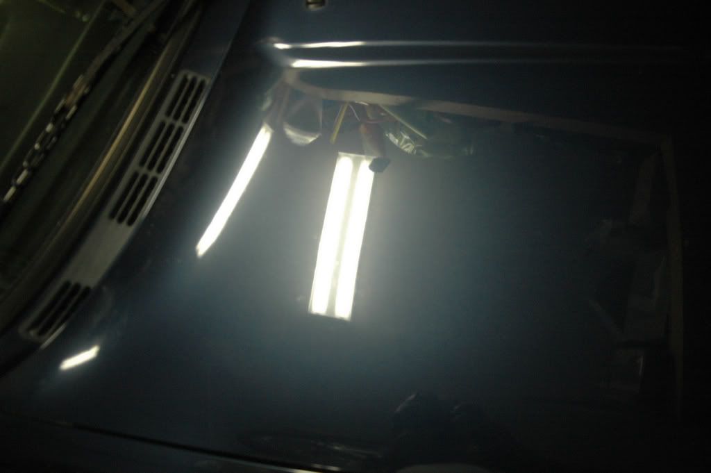

    Here is the panel that got the full treatment - two levels of polish, a glaze and then the polymer wax:
    When looking at this in person, you can even see the pattern on the plastic cover of the light. Notice how much clearer you can see all the crap on the shelf in my garage... :roll:
    Considering this car has severe acid rain marks, etching and scratches, I'm really impressed with the results. While you can still see the imperfections up close, their visibility is reduced tremendously. Next time, I might have a swing at the most aggressive polish, but for now I'm happy to learn.

      Frankly, I was a little intimidated - worried I would hurt the paint/clearcoat - but the system and the random orbital are designed to keep you out of trouble and there is a good video that explains everything in detail.
      My poor iX was the test victim, but I have no reservations about using it on the M635 when I wrap up the iX. It was pretty fun!

                    Will do. I taped off all the trim today and got most of the rest of the car polished - just have the driver's side door and fender. It is amazing how much difference two stages of polish make. I'm actually went mild-medium-mild on all the horizontal surfaces (which took a while) and just mild on the vertical - they were generally in pretty good shape with no real scratches or etching to worry about.
                    The glaze and wax will go much quicker! Glosshaus isn't cheap, but damn if it isn't amazing stuff to work with - simple, too...

                            With the Porter Cable (or Griot's), the right pads and the right liquids, you have to work pretty hard to hurt something. I didn't understand that until the last couple days. The one you have to be careful of is the most aggressive polish with the most aggressive pad, and even then you have to be hammering the crap out of it.
                            Buy a cheap, ratty hood from the junkyard to practice!
