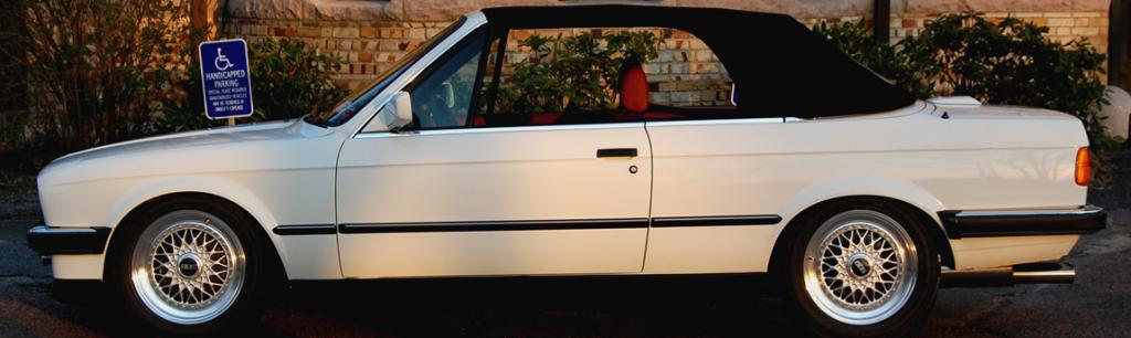

    I want my vert to look like this
    This is what I want my vert to look like.
    Last year I foolishly installed H&R Sports and Bilstein Sports. The springs of course did not lower the car as much as I wanted (I had a full coil cut from the fronts along with the thinnest spring pad). I ordered a set of Suspension Techniques vert specific 55/35 springs. Anyone know if these will give me the look I am going for? If not, any suggestions? I don't want to go coilovers yet since I just got the Billy Sports.
    Thanks for the help.

            The ST suspension 55/35, you will not, i mean not be happy with. I had them installed on my cabby, and rear had so much rake it looked like a drag BMW. I hated it and I am still to this day regret buying that kit. I would go coilovers, talk to Elliot (E30trash). He can help you out on the suspension. I can promise you that you will want to cut those springs, cause that is what i did to the rear. Get the 60/60 for the coupe/sedan, they are all the same.

              seriously, if your buying springs, don't complain on how low it goes, you can't get that much of a drop from springs on an e30.
              you want a drop, get GCs. had them on my e30 with konis. lasted 2 years including canadian winters with no problems at all.

                I cant remember if early cabrios have the smaller rear fenders or not. My LowTec 60/50 kit with no spring pads looks close to that pic you posted, if your fenders are smaller you might want more of a 60/40 kit with no spring pads.
                Pic for referance:

                    I ran H&R Race and Bilsteins on mine - do some searching and you should be able to find pics of it - it was pretty damn low - but tolerable for driving on normal roads.

                      The H&R cup kit will give you the look you want. Very comfortable ride too.

                        Stop wasting money on springs. Buy a set of GC's for 400 from Ground Control. Put them on your Billy sports. It feels just like HR race. Except you can go as low as you want.

                          The cup kit is specifically listed as 'Not for iC models' on the H&R website. Know why? Because the super soft springs and extra weight of the convertible DUMP the car. Ask '92 mtechnic cabrio', he broke 4 oil pans running that setup. Definitely not a good choice IMO if you are concerned with driveability.
                          As far as the OP, I'm in the same boat as you. I would like to get mine a bit lower too (I'm running the exact same setup as you) and I've come to the conclusion that coilovers may be the only way. You could always try the 60/50 springs, they sound like they'd be just about right. But to get exactly the height you want, coilovers are probably the only way to go. Oh and you can keep your Bilsteins with the GC coilovers, so you wont have to throw them out.

                            I am running H&R race springs with no spring pads in front, and both in the rear. Without them in the rear the rocker panel sits dead level with the ground, but I wanted a little rake (1/2") since it already looked like it was sitting with reverse rake even though it wasn't. Think about people getting in the car and a trunk full of shit, it would sit way too low.
                            My stance looks pretty close to the picture at the top.
                            The picture was taken directly after I put them on and drove around the block, also at a low angle so it looks like there's a lot of fender gap up front. It's pretty good now though anyway, and the rear looks the same. I wouldn't go much lower than that. I scrape shit all the time on tall speed bumps once my front tires clear even if I'm barely moving, and one of my friends driveways drops away from a curb that angles up too at a pretty good angle. The car will cruise right over the rocker panels, exhaust etc, whatever every time I roll in ever so slightly. I try to avoid it whenever possible. Especially with people in my car. I'm running on stock size 195 65 14's too....they're fairly new too, so I can't wait to see what happens when they wear out and have almost a half inch of less clearance.

                              All verts have LOWER rear wheel arches (like the facelift cars) despite the bumper style.
                              Not low enough for me. 55mm front is lower than the 1.6" claim for the H&R Race. Plus on a vert the extra weight on the rear will make it look like a speedboat.

                              The $399 conversion kit will only get me down 1.75". Again, this is less than 55mm. I know I messed up and should have gone with full coilovers to begin with, and in a couple of years I may remedy this.

                              I have seen your images before. I did not realize you had the ST 55/35. I am assuming that your latest post in the member's rides section has the rears cut, but honestly the front looks pretty good to me, and I can deal with the rear a little higher than you have it. Do you have any other complaints about the 55/35's beyond the drag car rake? I've seen coupe 60/60's on verts on e30zone and, to me, it looks like the rear suspension failed.
                              I will consult E30trash in a couple of years when I go coilovers (I really like the way his car sits), but I think I may go your route for the time being.
