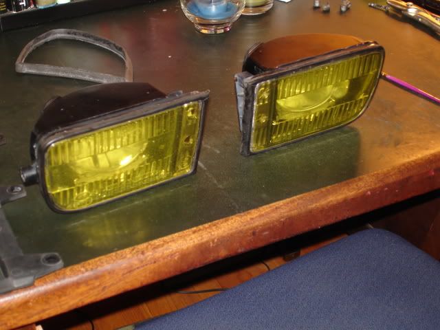

I've been trying different yellows for a while now. I think i'll stick with this one.

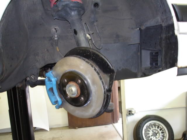

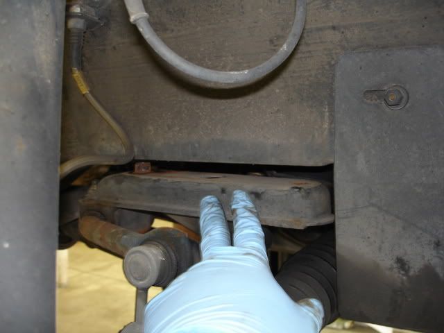

Ok, one other update. While doing my brakes, i notice i am missing one subframe bolt. As i go to replace the other one, that one breaks as well.
Have another look. Ooops, shouldn't be a gap there.
So, I have two sheared off bolts stuck in the threads. I drill a hole in the first one, get an easy out tool in there, get it to bite, then crank too hard and the easy out breaks off inside the bolt. Dammit.
So two options: Remove subframe for easier access to them to drill out an re-tap
or, the R3V way, to run a weld along the seam.
Well, this is r3v afterall. So, i now have my subframe welded on for now. Expecting a motor swap after winter, so the weld will be grinded off and done correctly then.
I followed up with POR-15 on the weld, as well as a few misc spots underneath the car to stop further rust.

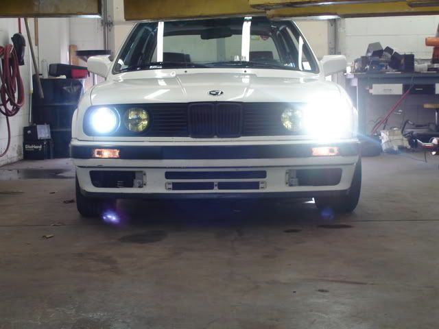

I'm running red city lights in mine. I bought the color set though, so I also have green, blue, yellow, and orange.

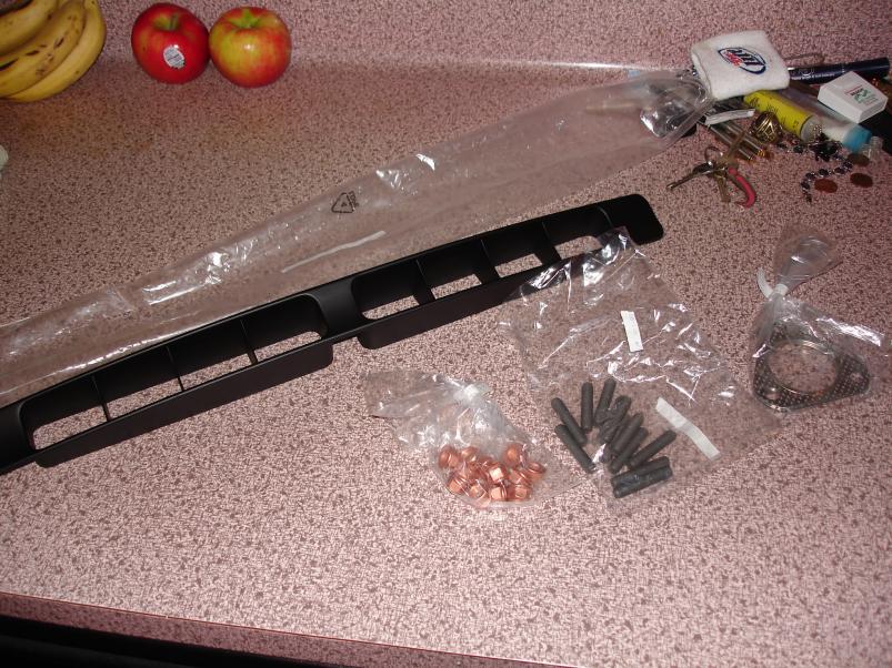

-driveshaft arrived at the shop today
-fog bulbs arrive tomorrow
-and these misc parts were at my door when i got home
The body man at the shop was kind enough to paint my brake ducts black for me. Expect work pics on Saturday. I'm so excited. Three weeks is too long to be without my girl. I don't know how i'm going to cope next year when i do the motor swap.
