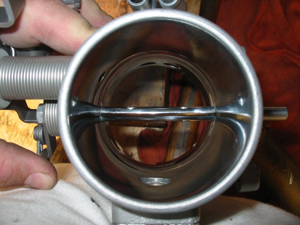

    The wall was just cleaned up but no material was removed at the seal off. The butterfly was tapered to a .010 edge so only .010 of the original seal off needed to be maintained.

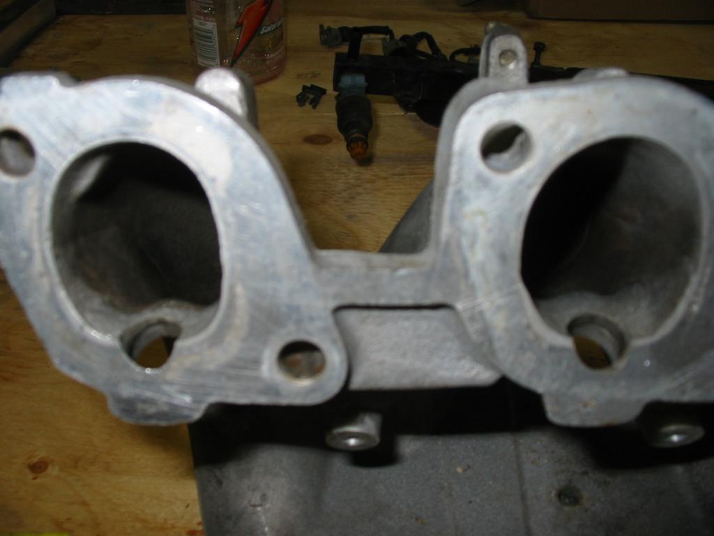

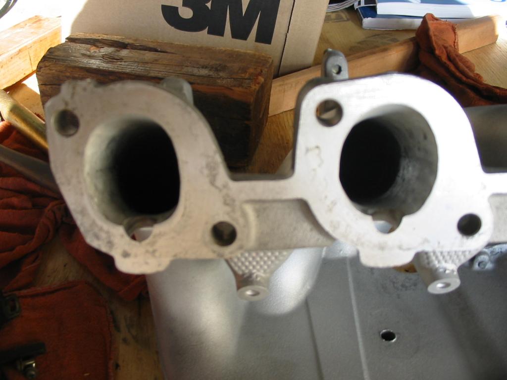

              Can I see some port matched intake manifolds?
              Before
              • chameleonleather
                • Mar 2008
                • 586
                after

                      you didn't go deep enough into the intake to begin with. you just kind of made a funnel there. you need a less abrupt change in the manifold to the head.
                      no, you are not helping things with your polished throttle body. you would benefit from taking it and running a cross hatch scotch brite pad through the work you just did to give it a micro finish instead of the shinny one you have there.

                          Well I have now read the MM article and it's very well written. I did notice a positive difference after having it done. Now could there have been a better result if some perfect grooves where machined in, possibly. I will give that a shot when my head gets rebuilt with another throttle body. I agree that the manifold did not go high enough, only had 4 hours to polish up the throttle and open up the intake before installing it for the SD autox next day.

                              Any advantage you're feeling is simply from cleaning the moving parts in the throttle body. The work you did to the manifold will probably be a disadvantage, you've created a low pressure zone right in front of the valves.
                                You don't need to machine in perfect grooves. The stock texture will flow better than your polishing work. If anything, you DECREASED air flow. But it sure looks pretty!
