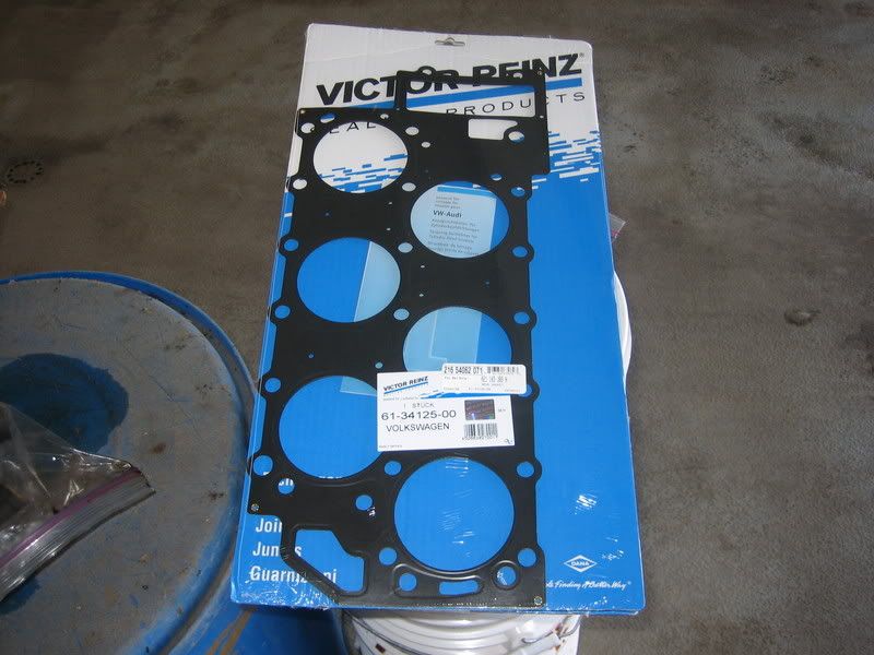

    This is when it went downhill. I figured, fuck OE, lets bore it out. So I went out 2mm to 83mm pistons for a dirty "3.0" build. Also the pistons ar 10.5:1 CR versus the 10:1 stock. I decided to couple that with a mk4 HG to raise the final CR to 11:1

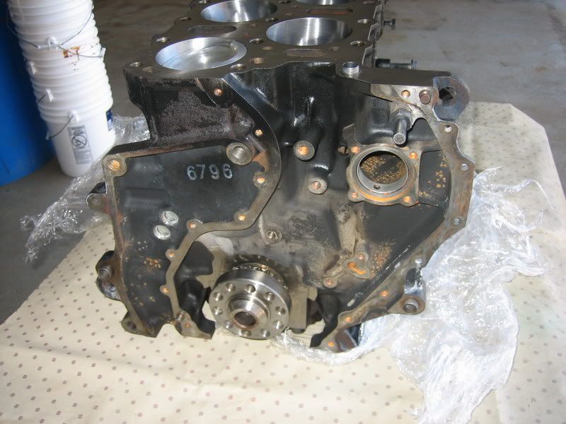

    My block all done:
    Mk4 HG

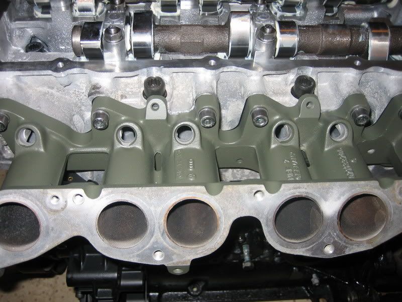

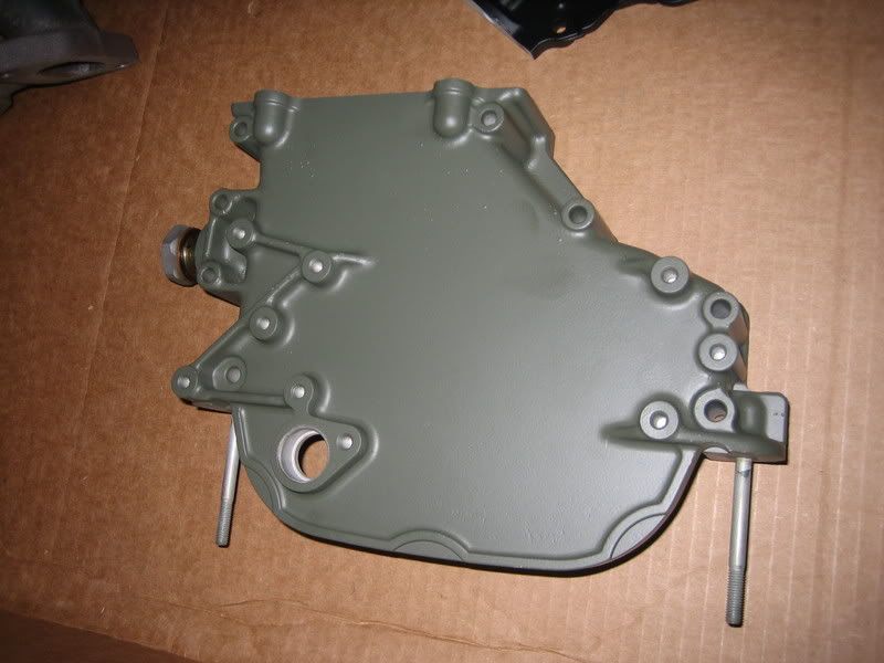

    I also got all my powdercoated stuff back. I had the intake done, rear engine mount bracket (kinda I waste, the whole thing I was thinking it was the front one), Upper timing cover, lower timing cover, and thats it.

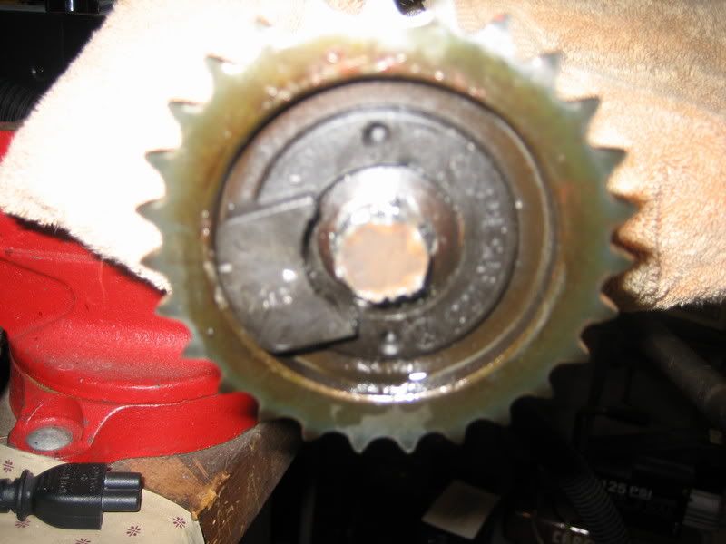

    Also the bolt for my other cam sprocket is stuck the fuck on, I can't get it off for the life of me. So I am stuck on getting the timing done until I can get the fucker out.

                  I then decided to tackle the stuck on cam bolt. That was a full disaster. That thing must have been torqued on by jesus because its not coming off. Stripped the damn thing out, tried heating it which just melted the plastic on the trigger wheel (which I figured would happen) and was also no assistance in getting the bolt out.
                  So I said fuck it, and threw it on the floor, I quit with that cam. Just going to go to the dealer monday and order up new parts. I ended up making another list of misc stuff I overlooked and still need to buy, mainly o-rings and some gaskets.

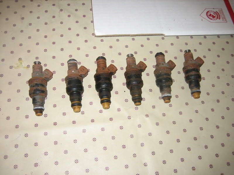

                  I also got my injectors back from Witch Hunter a few days ago, they look purty now. I guess this was like the 1 thing on this engine that wasn't shot. Injectors were barely bad at all.
