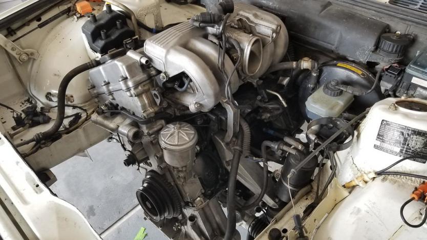

      Motor is stabbed. Time to start bolting accessories back on! Also did the "mess under the intake" cleanup. I decided not to replace the master/clutch cylinders just to try and not complicate things by breaking too many systems all at once. I can always do that later.

        Looking good! Plans to replace any of the cooling system? How long until you fire it back up (or is it too soon to tell)?

          Hey Mike! I've got replacement pieces for the water tube under the intake, heater hoses, radiator hoses, water pump and t-stat. Assuming a new shift rod selector joint (piece I received was off-center) arrives on time, hopefully I can get it fired up this weekend!
