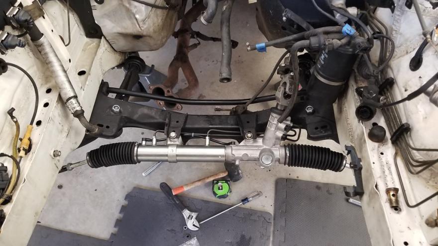

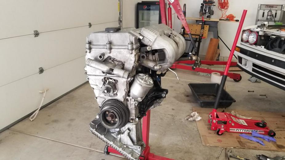

                              Spring cleaning and house projects have kept me a bit distracted but the engine is sealed up and cleaned up a bit... ready to go back in! The thing was leaking from the front timing cover, valve cover, both oil pan gaskets, the rear main (already fixed the oil filter housing and dipstick tube before) and power steering lines. Still doing a bit more fitment on the Z3 rack, install the new shifter rebuild parts, transmission seals but it's getting there...
