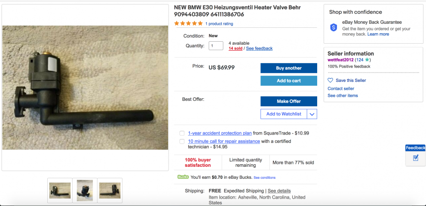

      -The stupid heater valve my dad rebuild is seeping every so slightly. Found a guy on eBay selling them brand new though (New/old stock never installed, original BMW) for $69 shipped. He only has like 3 or 4 more so I'd act fast if one of you needs one. Even with my discount at the dealership I'd be paying over $2xx! Ordered one and it's on the way. Sucks I need to pull the heater core out again to get this valve out but screw it, I need a heater..

            I don't think the valve in your attached photo isn't the correct one... hopefully I'm wrong, but I believe most e30s use one without the L shape below the housing.
            Here are my old and new heater valves. The new one is a different design, but the pipe positioning is the same between them. Yours has an L shape and extended pipe.

              Dughh! Dumbass me, your totally right. You just saved me a huge headache thank you! Looks like I'll be spending $2xx tomorrow at the dealership then .

                Ugh, sorry it was't the right one. :(
                I edited my post above with a photo of the old and new style heater valves. Be sure to take a look at the "instructions" as it briefly describes how to rotate the top of the housing and then lock in back into place. The housing on top of the new style valves is a bit larger than the originals, so it needs to be rotated to fit.
                I posted more details (and photos) about it here: https://www.r3vlimited.com/board/for...07#post9927307
                Don't forget new o-rings! :)

                  More work done! First and foremost, I got the new $2xx heater valve installed. The new valve looks nothing like the old style valve and doesn't fit the greatest either. The very top portion of the valve "pivots". Once you have the very top portion that "pivots" in an OK spot, you can tighten down on the top nut hand tight (Thank You Mike for the pics in your thread ).
