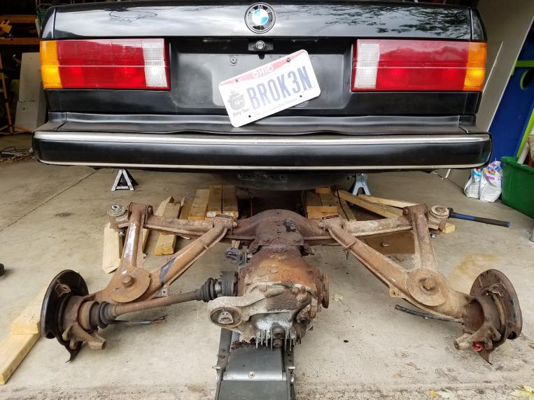

      The rear subframe and diff looked to be in rough shape. There was rust scaling peeling off on the diff housing and the arms were covered in surface rust. All the bushings were deteriorated as well. I decided it needed to be dropped and dealt with.

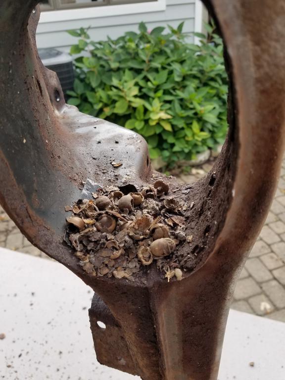

      I had to tap the subframe bushings with a 5/8" tap and thread in bolts. It only took a couple taps with a hammer to free each side after that. Unfortunately the driver's side ebrake cable was too worn to stop the hub from spinning and I ended up rounding a couple of the T50 torx bolts trying to remove the axle. Anyone have any suggestions on removing an axle with it disconnected from the vehicle and having rounded bolts?
      Anyways, I broke down the subframe assembly to start cleaning it up and to get it read for new bushings to be installed. In the process I dumped out at least 1/2lb of acorn shells from inside the cross member. The PO wast've had some very hungry mice in his barn because this thing was packed tight.

      Anyways, that's where the car currently stands. The wire wheel on my angle grinder is going to get a workout this week. I'll also use this time to clean up the rear undercarriage, replace the sway bar and bushings, and weld in any new brackets that may be too far gone. I've been watching videos from 'Restore It' and 'Soup Classic Motoring' on youtube to also stay motivated.

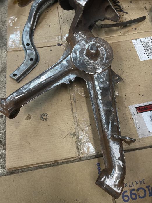

            I whipped out the wire wheel, flap disc, and file sander and started cleaning up the subframe bits. I soon realized it will take weeks to get these parts as clean as I want them. I decided I'm going to outsource the cleaning to a local media blasting company. I have etching primer and some rustoleum flat black, so I don't think I will spend the money to have the parts powdercoated. Next step is to remove the hub and wheel bearings so I can send them off to be blasted.
            That's where the project stands. Next steps will be to disassemble the differential, check the condition, and send the case off to be blasted as well.

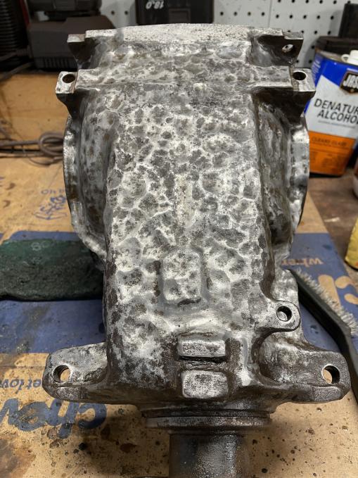

              Hey All. Don't worry - I haven't abandoned this project. Progress has been slow and steady despite the freezing temperatures and working in an unheated garage!
              The rear subframe is looking pretty good now. The worst offender was the differential housing, but through the use of a hammer and chisel and dremel flap discs I managed to get it to a respectable state.
Name:	diff crusty.jpeg
              This was taken after some initial cleaning. The amount of rust scale blew my mind.
Name:	diff pitting.jpeg
              You can see all the pitting caused by the rust. It looks like a golf ball. The housing will get 3 coats of rust reformer, 3 coats of gloss black rustoleum, and 2 coats of clear before going back on the car.

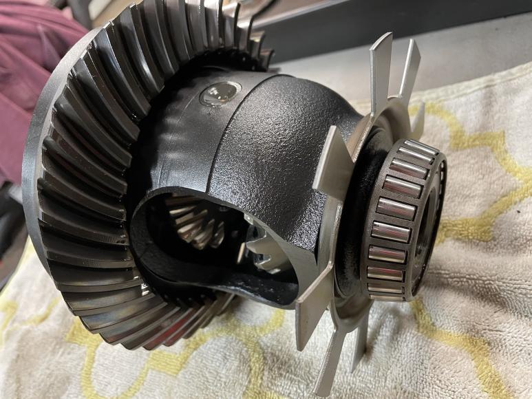

              Despite the ugly outer shell, the actual differential appeared to be in great shape (or so I'm told by those with more experience with these things. I've never refurbed a diff before):
Name:	diff naked.jpeg

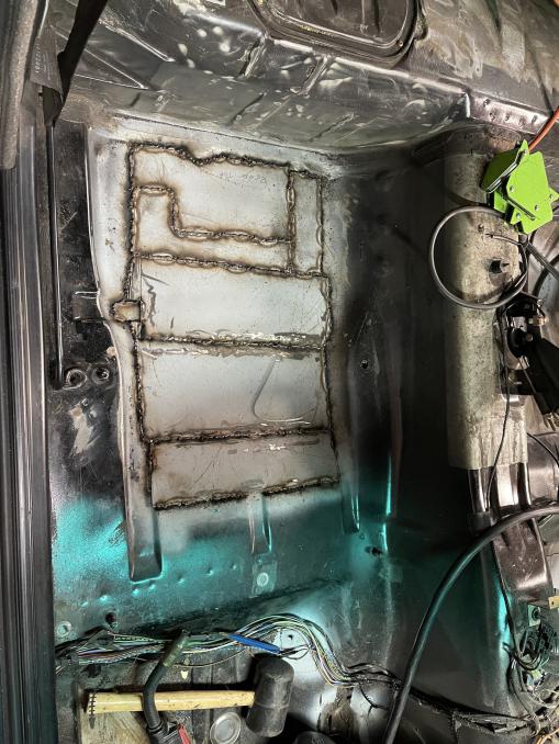

              Lastly, I welded in a new passenger side floorpan. This would be the rear seat footwell and directly under the passenger front seat. Because of the slight concavity in the original pan, I had to use multiple pieces. The metal I am welding in for the floor replacement is 2 or 3 times as thick as the original metal. It is difficult to shape, but much stronger than stock:
Name:	pass floor weld.jpeg

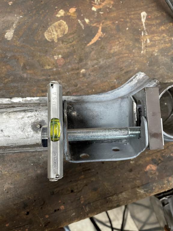

                      This weekend I used a dremel to slice up the control arm mounts on the rear subframe support to weld on some garagistic camber and caster brackets. Ireland Engineering sells a similar product and has better instructions in case you were thinking about tackling this project. Before welding, I used a small level to ensure my brackets were straight and also mocked up how they would be installed on the car to make sure the bolt was in line. I make a tack weld in case the bracket shifted during the weld and checked again with a level. I cranked my little 120v welder up all the way and laid down some thicc welds. For anyone thinking of doing this at home, here are some more tips since I couldn't find much info out there:
                      1. Cut out the holes in the control arm mounts before welding the brackets. I saw some videos of folks welding the brackets before cutting the subframe. I would be worried I'd damage my nice new brackets trying to cut out/grind the stock metal.
                      2. Keep your welder grounded close to the brackets you're welding (this is basic welding knowledge, I guess). I used the subframe mounting holes on either side of the support depending on the side that was getting welds. My welds were noticeable better when the ground was closer, even if it was just a foot or so.
                      3. You will get some spatter inside the bracket that will hinder the movement of the bolt. Make sure you have a way to grind those specks of metal down. I used a small dremel attachment that fit nicely inside the path of the bracket.
                      4. If MIG welding, you will need to wire wheel or grind the finish off the brackets. They are zinc coated and a MIG weld won't stick.

                      Garagistic includes some reinforcement metal to weld in as a way to extend the stock metal to match the new bracket. I still need to grind those to the correct size and clean my welds up a bit.
Name:	weld level.jpeg
                      Leveling out the brackets before welding.

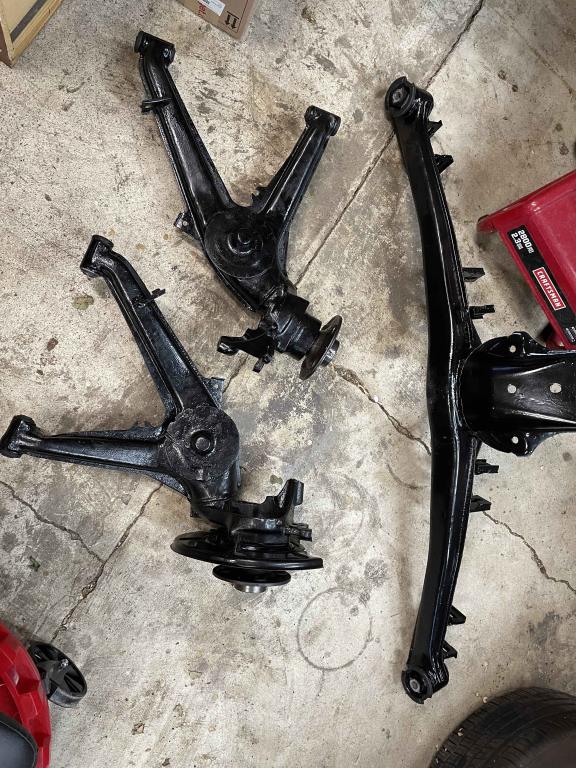

                        Managed to get the rear subframe cleaned up and painted via rattle can (3 layers rust reformer + 2 layers primer + 3 layers gloss black + 2 layers clear). It took forever to remove all the rust without having access to a blast cabinet. The primary purpose for the paint was to protect from future rust and not concourse level perfection. Also hit my new ANSA exhaust with some high-temp paint to prevent rust.

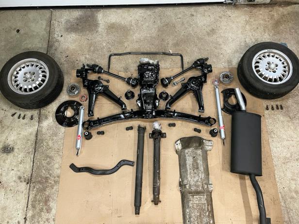

                            I'm still at it. I got sidetracked with some other issues that popped up with my summer daily and another BMW for sale locally that I could not pass up.
                            Finally installed new hubs, and new OE bushings in the subframe and trailing arms. I bought a 12-ton floor press thinking it would make the job a breeze. Unfortunately the subframe and arms are incredibly awkward to align on my press. I resorted back to the threaded rod method which worked out surprisingly well.

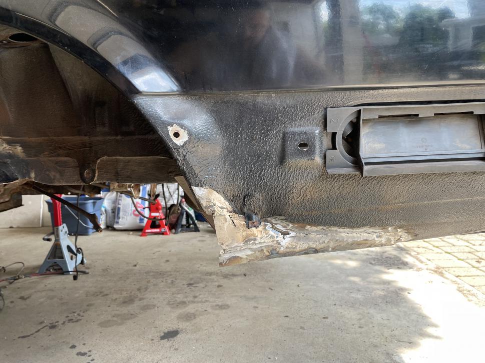

                            The trunk corners are both shot. The car came equipped with mud flaps which trapped dirt and water against the inner fender wells which accelerated the rust. I fabbed up a 20ga steel "tray" that will act as a patch on the trunk bottom by the factory jack. It's welded on the outside and underneath/inside. It still needs some more shaping and paint.

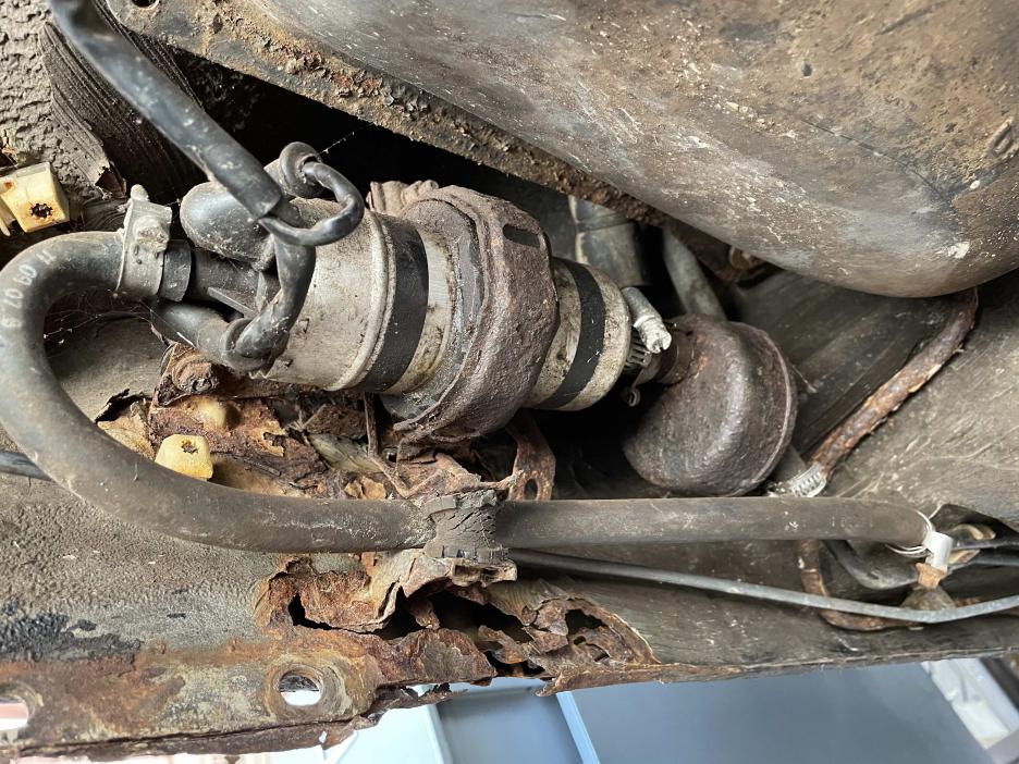

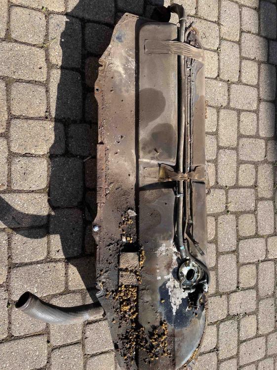

                                The fuel tank was also looking a bit rough from underneath, so I drained out 8 gallons of gas (not fun) and dropped the tank to clean it up. My hard fuel lines look newer, so I wasn't going to mess with them. However, the early model e30s have an external fuel pump and dampener mounted inside the rocker near the passenger rear wheel. That area was looking pretty rough:
                                Click image for larger version  Name:	rusty pump.jpg Views:	0 Size:	148.7 KB ID:	10023650
                                All this has since been removed and new metal has been welded in its place. I'm going to have to find a way to fab up a new fuel pump bracket which appears to be over engineered with multiple bushings and all sorts of stuff. Had to cut a few soft lines from the top to get the tank to drop easily. There was a mouse nest on top of the tank as well.

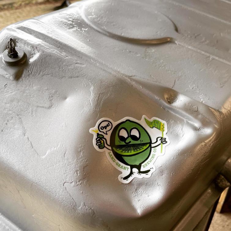

                                I cleaned it up and removed all the surface rust. I didn't bother stripping off all the old paint. There was a small hole next to one of the hard breather lines on top that I patched with a fuel tank putty. Got it cleaned up and decided to paint it a metallic silver because why not:
                                Click image for larger version  Name:	fuel tank new.jpg Views:	0 Size:	133.2 KB ID:	10023652
                                I did not mess with the connection pipe. I read they were a nightmare to remove and would likely break. It wasn't the prettiest but it wasn't leaking, so I just sprayed it along with the rest of the tank.
                                Also added a little note for the next owner. Seems somewhere in the past someone used the fuel tank as a jacking point.
                                Click image for larger version  Name:	fuel tank dent.jpeg Views:	0 Size:	82.4 KB ID:	10023621
