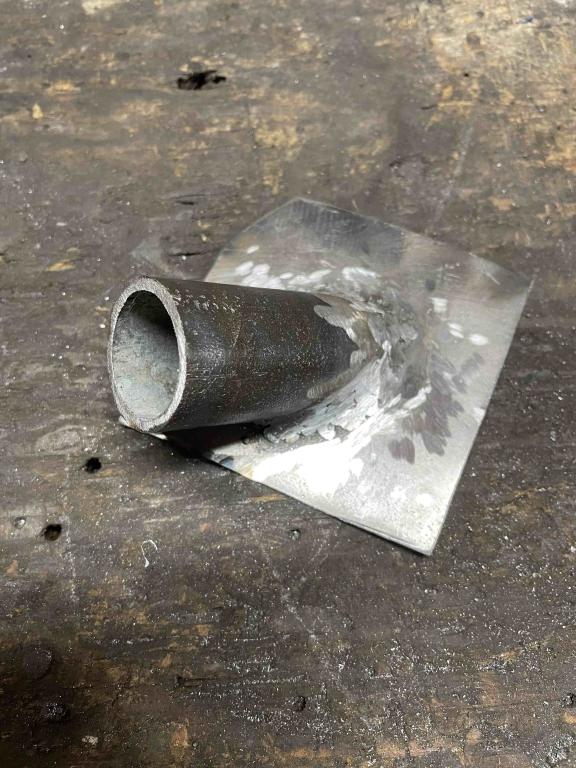

      Using part of a fence post (AFTER using a stone to remove the galvanization - don't weld on galvanized metal, kids) and some 18g sheet metal I created a new outlet port for my vent lines:

      My plan is to run a couple feet of vinyl tubing from what is left of the metal tube to this new vent port. Yes, the fuel vapor lines will now mostly be routed inside the vehicle, but they will be sealed inside the vinyl tubing with worm clamps at both ends. Yes, there is the risk of water making its way from the wheel well into the vinyl tubing, but the inner sections of the metal have been primed. Time will tell how well this works.

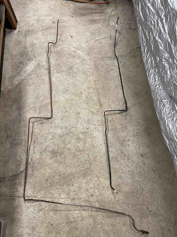

        Got the rear end assembled and installed back on the car. Reinstall went smoother than expected, but the bar is set pretty low. I replaced all the soft fuel lines as well as the hard fuel vent line. The mounting area for the fuel pump was completely roached (see pics in earlier posts), so finally dealt with that. I haven't tested anything to see if it starts because I still need to do more welding on the front half of the vehicle and don't want any fuel nearby.
