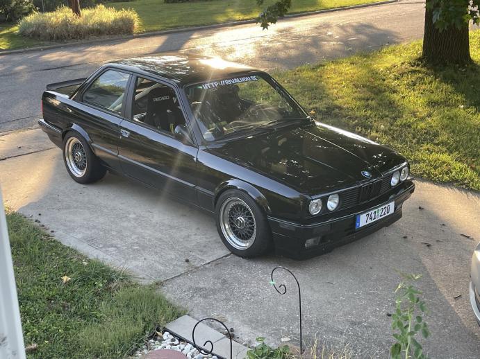

    Click image for larger version  Name:	10606368_10202974399628112_8703770689634626457_n.jpg Views:	7 Size:	74.9 KB ID:	10039545
    First picture I ever took of the car. I bought it with a steering rack that would leak P/S fluid out as fast as I could pour it in and a subframe bushing that was completely separated on the passenger side. So I got to work on it almost immediately.

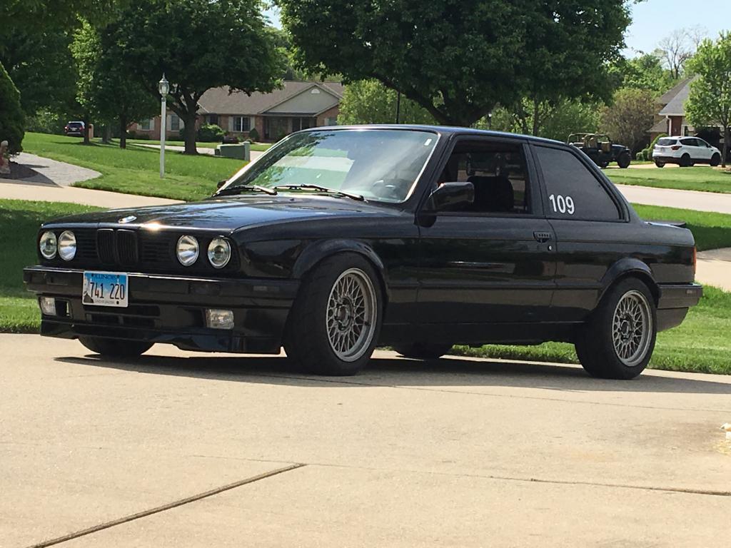

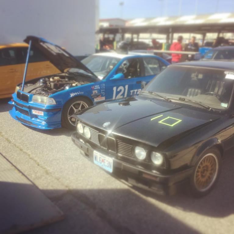

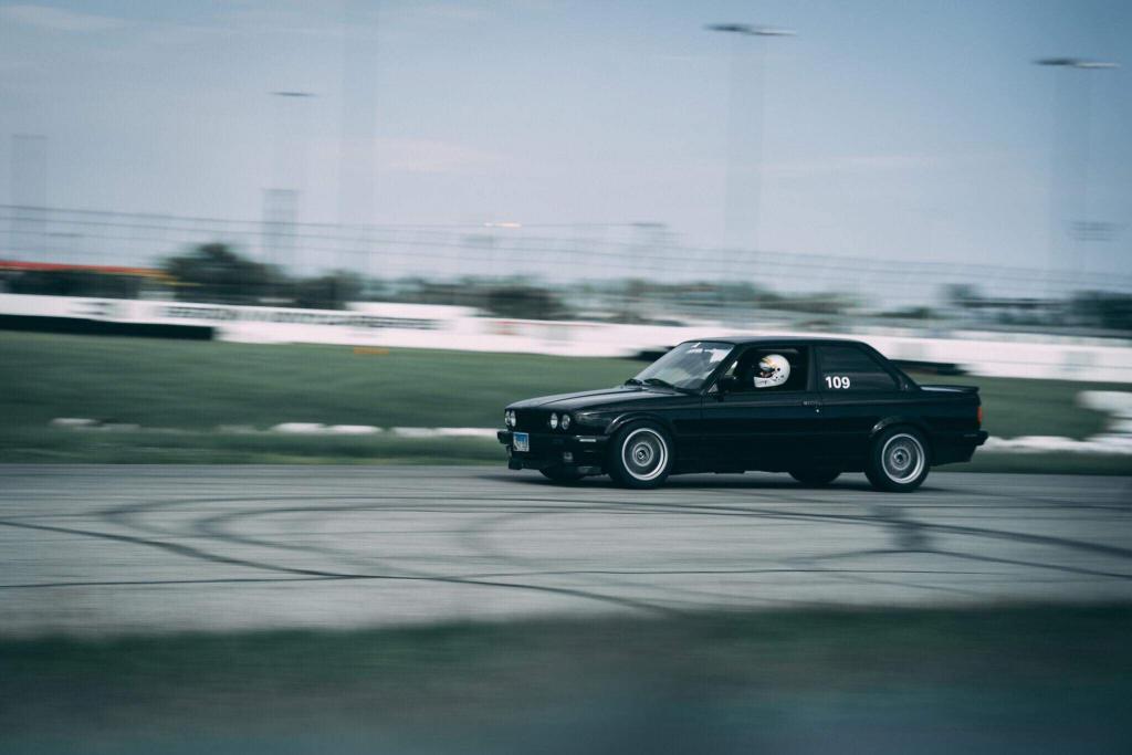

    Click image for larger version  Name:	17505393_10208891719237404_4618260029821493396_o.jpg Views:	6 Size:	53.1 KB ID:	10039546
    The first track day I ever did with this car, still M20 powered. Sitting next to my good friends NASA time trial car.

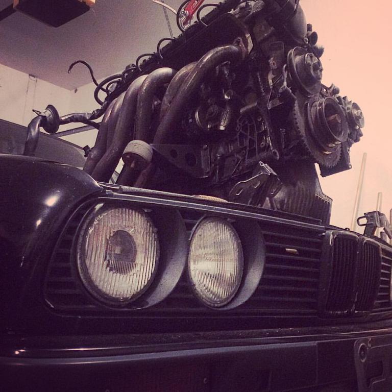

    Click image for larger version  Name:	14976788_10207751747618826_1254568465474949394_o.jpg Views:	6 Size:	79.3 KB ID:	10039547

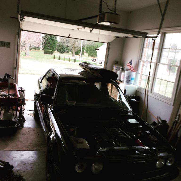

    M20 removal winter 2016

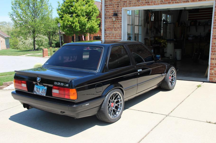

    Click image for larger version  Name:	16836421_10208572024805243_6219522994160907504_o.jpg Views:	6 Size:	67.8 KB ID:	10039548
    S50 in and ready for first test drive with open header. My brother hanging out the window ready to go with me. Spring 2017.

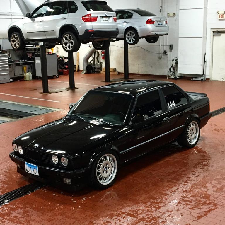

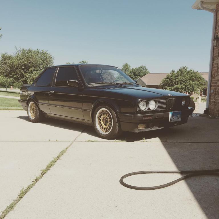

    Click image for larger version  Name:	33599944_10211889121490587_1157960635116421120_n.jpg Views:	6 Size:	62.0 KB ID:	10039549
    Taken sometime late 2018. This was right before I got serious about making this car look good, both inside and out. A lot of things were faded and turning grey like trim and lower valance.

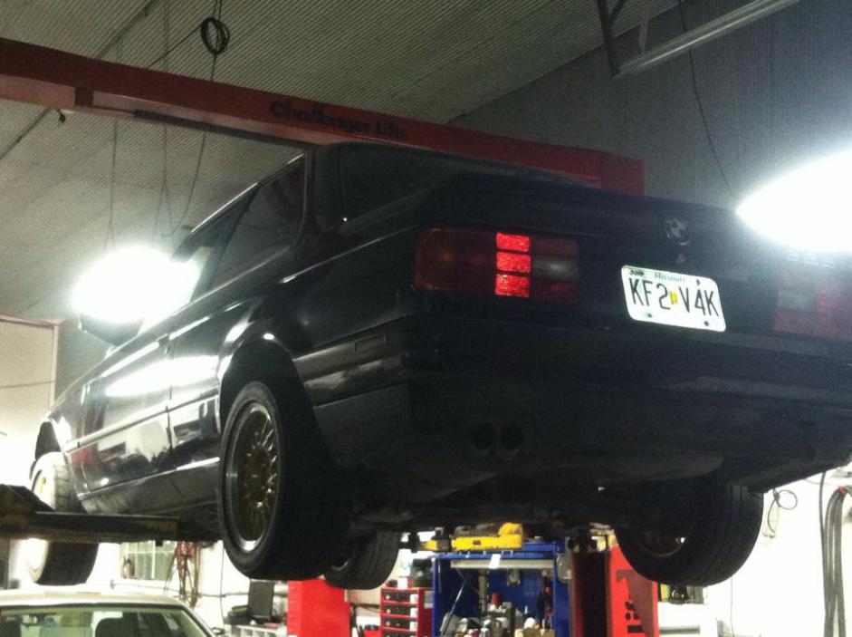

    Pic taken early 2019. A lot of work went into the car and it went through it's biggest transformation yet IMO. Over the winter between 18/19 I had removed a bunch of trim to re-paint, installed new rear bumper cover to replaced the cracked old one, painted the front valance and installed an IS lip for the first time during my ownership. I also did the 5 lug suspension and brake conversion and coil over install. I took this picture when I had to roll the car out and take a good look at it even with all the missing trim. The front obviously sat way too low but damn I just couldn't keep the smile off my face seeing the car change this much. Just a really big moment for me.

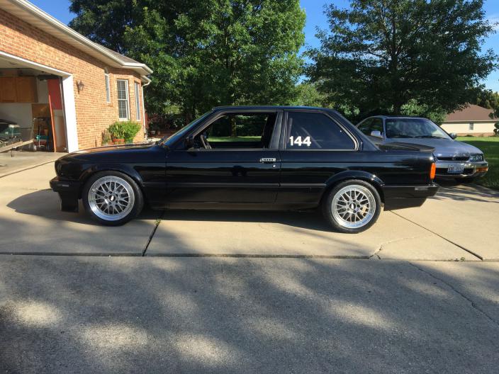

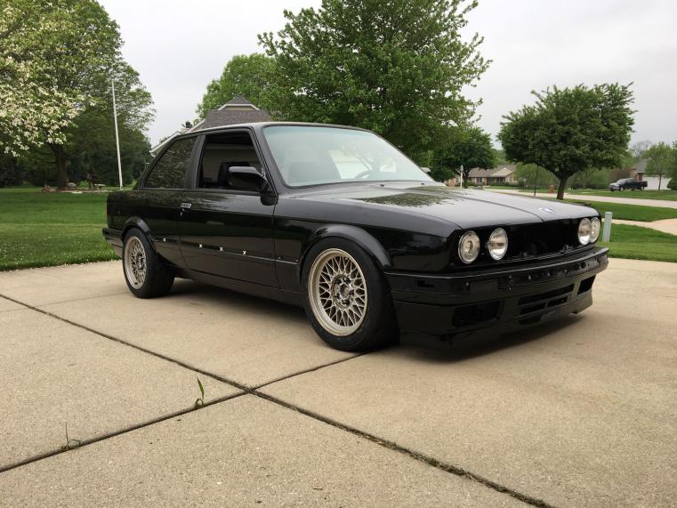

    The rest of the trim installed and freshly aligned after 5 lug conversion. Wearing it's first set of 5 lug wheels and tires. Spring 2019

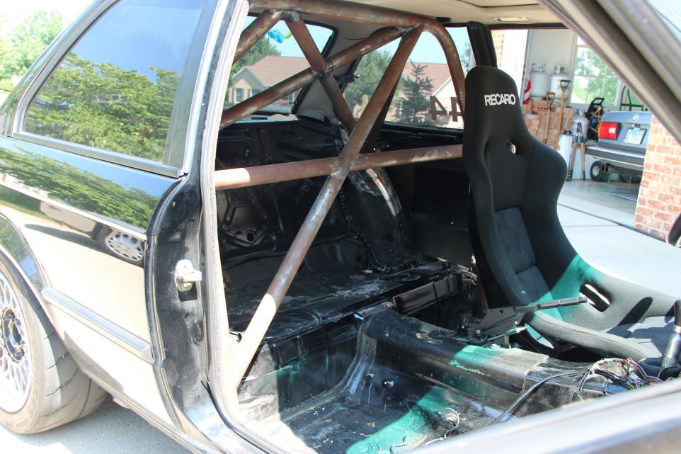

      End of 2019 and into most of the whole year of 2020 was when I got to working on getting the interior the way I always wanted it to be. I ordered the DIY cage and had it fabricated and installed, put fresh carpet in, installed the most amazing shifter to ever be created, and many other things that transformed it almost as much as when I got the car sorted cosmetically.

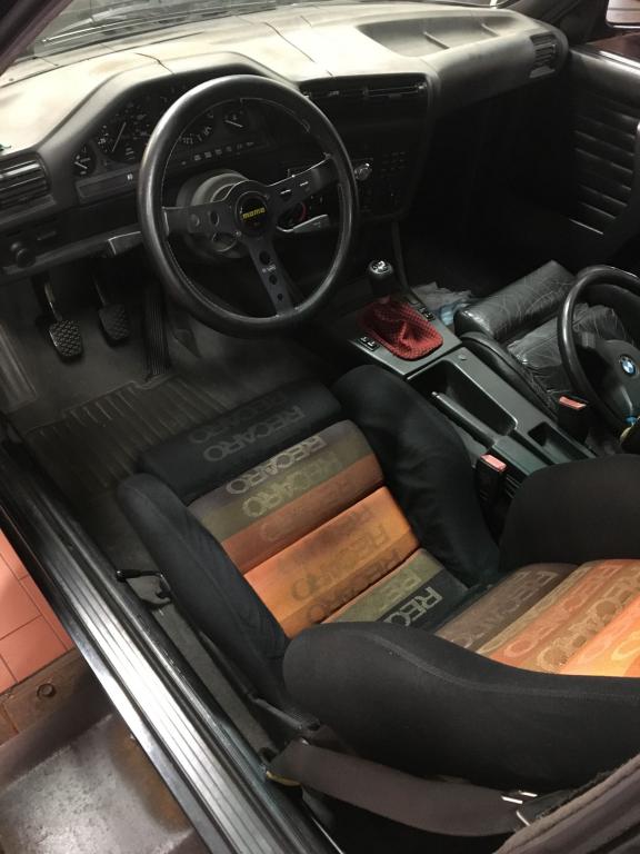

      Interior picture take sometime in 2017 I think. I only took the picture because I was excited about installing the MOMO Prototipo wheel.

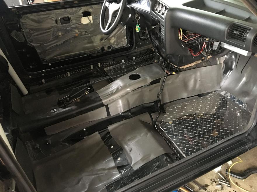

      After getting the car back and the cage painted in started installing the false floors and putting some sound deadening down. Could have done better with the sound deadening but even with the amount I put down I think it helped a lot.

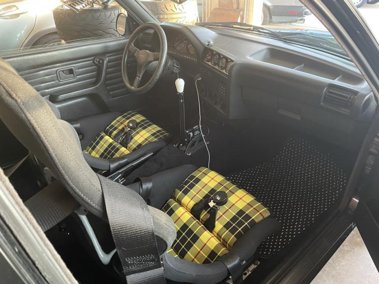

ID:	10039562 Interior mostly done in this pic. Taken mid to late 2020. Mostly happy with the way the carpet turned out but in person it has a lot of wrinkles and isn't very smooth. I am also still not happy about the way it meets the heater box and looks unfinished. Still need to figure out what to do with that. My main goal was to have a clean center tunnel with no center console and really display that absolute unit of a shifter.
      Tartan seat inserts installed and coco mats installed.
