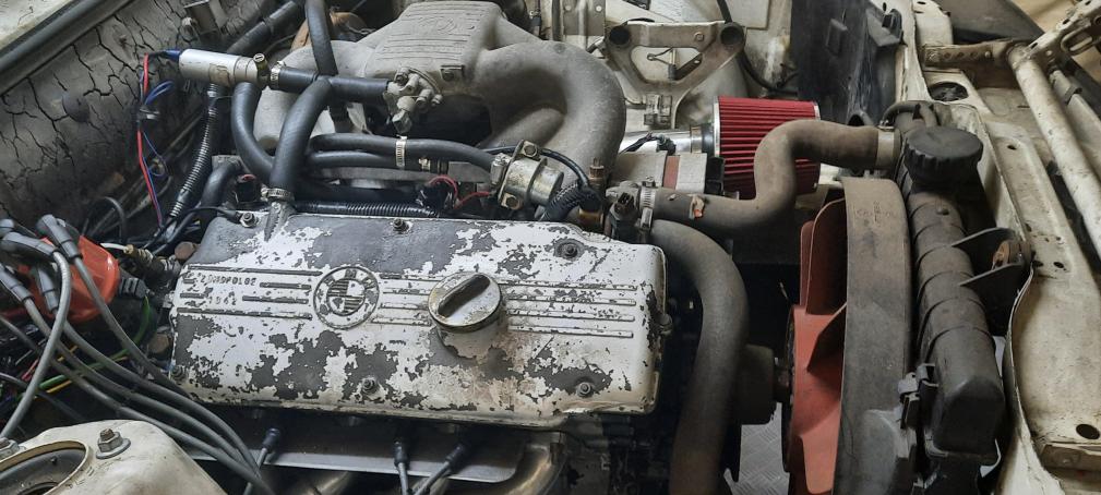

    So I decided to "hit it" hard. Since I knew the pistons were marked I was a little concerned about it but I wanted to get the wiring done to be at least able to test everything. So little re-cap so far, started the wiring in 2015 and never touched it again till 2020. After about a month of me working a few hours a night after work. I was finally done with the wiring. It didn't look smooth or clean kinda just wires everywhere but it was all connected.

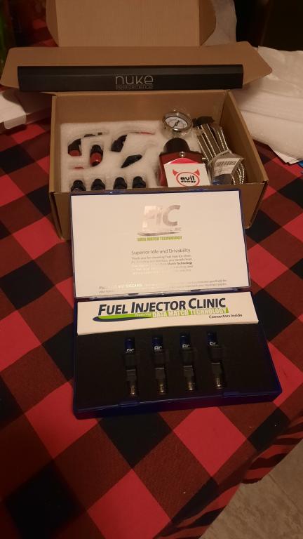

    Once the wiring was done I went on the lookout for a semi factory tune that someone out here on R3v could help me and give to me so the first time I turned the key it didn't go bang and destroy itself. I was lucky enough to find 3 people that had tunes. Non of them had spent the money I did on the engine they were all factory built just had a Megasquirt added. That didn't bother me though because no matter who's tunes I got I would have to tweak it to make it mine. I also went out and bought a high volume in-line fuel pump, an some new E36 M20 fuel injectors. I wasn't planning on boosting the car at this time yet since I didn't know if it would run again or not. But with asking people about tunes What I found kind funny is everyone I asked was very confused on how I was going to get the "crank signal" for the ms2 (even "professional technicians and businesses"). I would explain with "the same way they did it in 1984". Almost no one understood what that meant. Everyone is so stuck on a sensor near/ next to the crankshaft they forgot or never knew that it used to just come from the distributor dizzy. ( manufacturers left this alone later because they realized once the timing chain was stretched enough the dizzy would never get correct timing due to the valve timing being off) So I just gave up trying to explain and left it alone when people kept asking me.
    So I got the tunes, combined a few of them and set up the ms2 to just understand a simple AC sign wave that the distributor dizzy produces. Then I felt like I could see what happened when I turned the key. But before I turned the key, I did a final check/ inspection. Turned the engine over by hand, made sure no fuel leaks, did a spark test using the ms2 to simulate a crank signal to make the coil fire. Once all that checked out I did a compression test. I was really impressed and excited when I found out that all cylinders are ~20 psi higher then factory. So I know the head work is really doing its job. So with all that information checked I went for it. It tried to Start it but the ignition timing was off. So I adjusted on the ms2, tried again and it stumbled an died, so closer but ignition timing still off. So another adjustment and bingo!!! It ran, I didn't let it run long since I didn't have the custom exhaust I built finished yet.

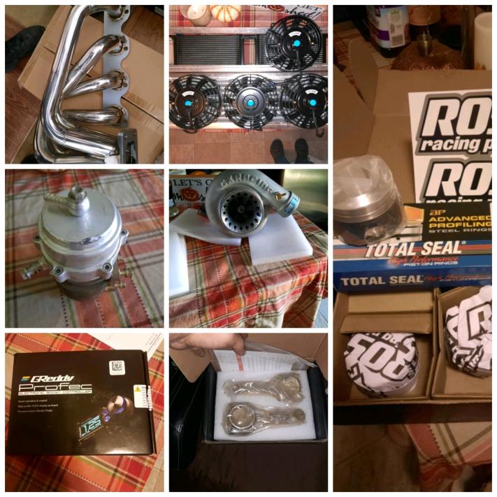

    So once I knew it ran, All types of ideas came rushing threw my mind. This is when knowing the pistons were marked really started to bug me. I knew it was running at a higher compression an I was nervous. I didn't want the $$ I put into the top end be destroyed by a slight lack/mis-trust in judgment in the integrity of the pistons. Boom, decision done buying new forged pistons (didn't want to go used factory). Next thought, well since I'm getting pistons, it won't take much more to turbo the M10. That's when I said FK it, TURBO GOES PSST!!! So in 2021 I went full send an spared no expense. New 9:1 custom forged turbo pistons with side skirts coated, new crank and rod bearings, A.R.P Head studs and main studs. New water cooled dual ball bearing T3. Greddy electronic turbo controller, turbo manifold, new 650cc injectors, aftermarket universal air-air intercooler (only thing I went cheaper on, since it was going to be a full custom build). Since going turbo I wanted better control over ignition timing so I out with the original idea of using factory ignition setup, went with the I.E under-sized crank pulley with tooth wheel and sensor, an bought a 4 tower M.S.D coil pack. ........more to come, to be continued!!

              I like turbo e30’s. What is your goal for power? I’m building a turbo e30. I would like to do costume pistons and rods in the near
              • Whit3 E30
                • Dec 2013
                • 142
                Honestly I don't want massive amounts of power, the car doesn't weigh enough to make that a smart decision. Which is one reason I wanted to stay with the M10B18 4 cylinder. I didn't want to go M20, everyone that has a e30 with a factory M10 always swaps it. So I'm hoping to get ~150+ hp not boosted with all the engine work N internals, then boosted 300 hp maybe 350 if I'm lucky and can get a great tune.
