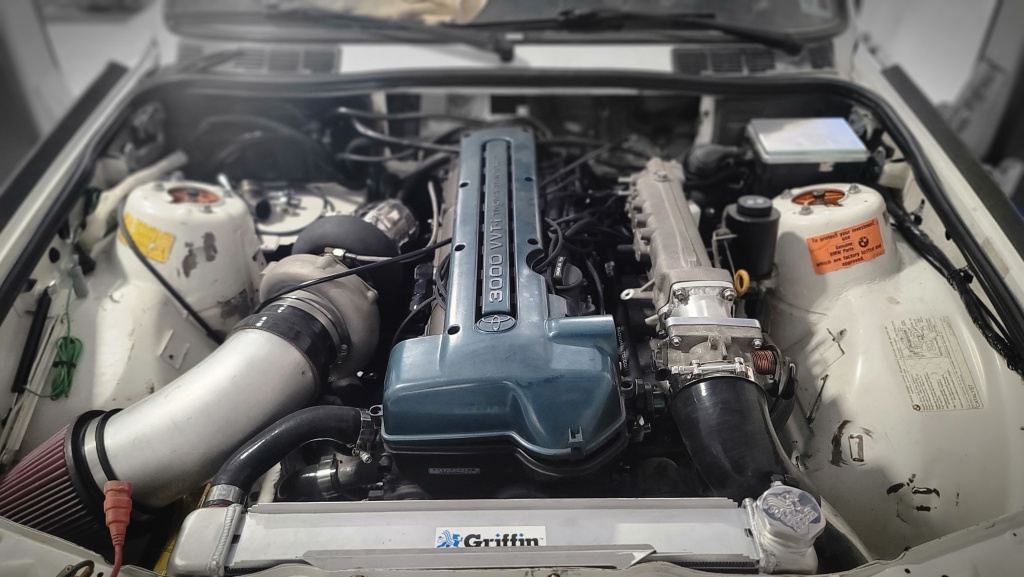

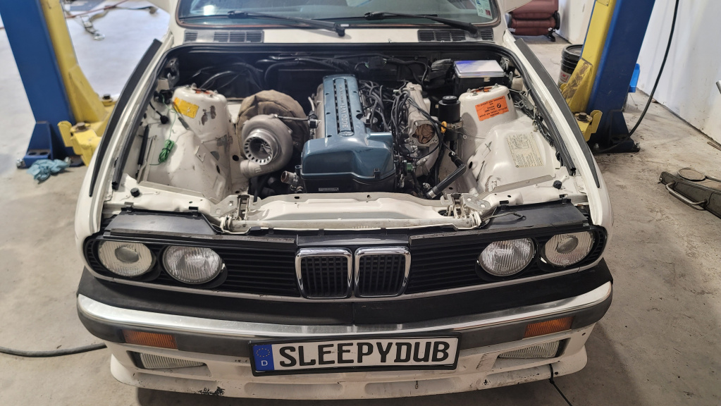

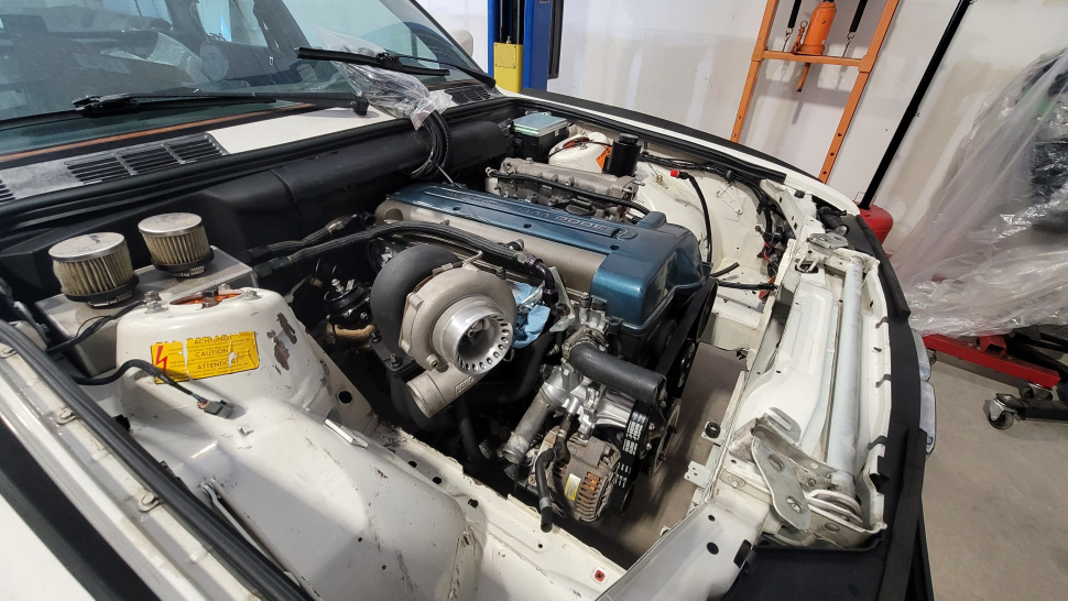

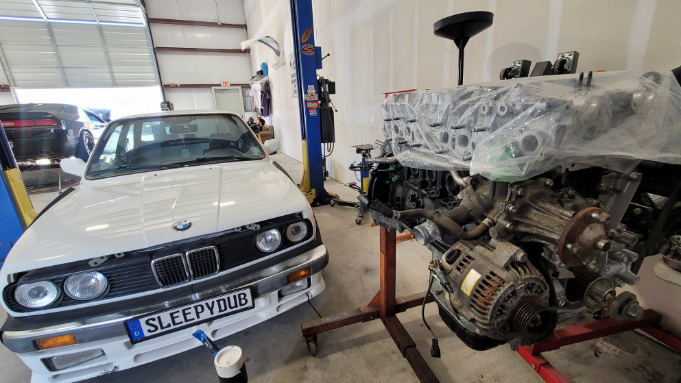

    Whats up guys. I barely post on here anymore, but figured I could at least showcase what we've been working on for the past few years. I only get a few hours a week MAYBE to work on this car. I run 3 GMC dealership service departments during the week, and a dyno tuning/fabrication shop on the weekends, so my personal projects take the back seat most of the time. I'll try my best to describe the setup and reply to any questions with the limited time I have. Bare with me, this may be a rough post.

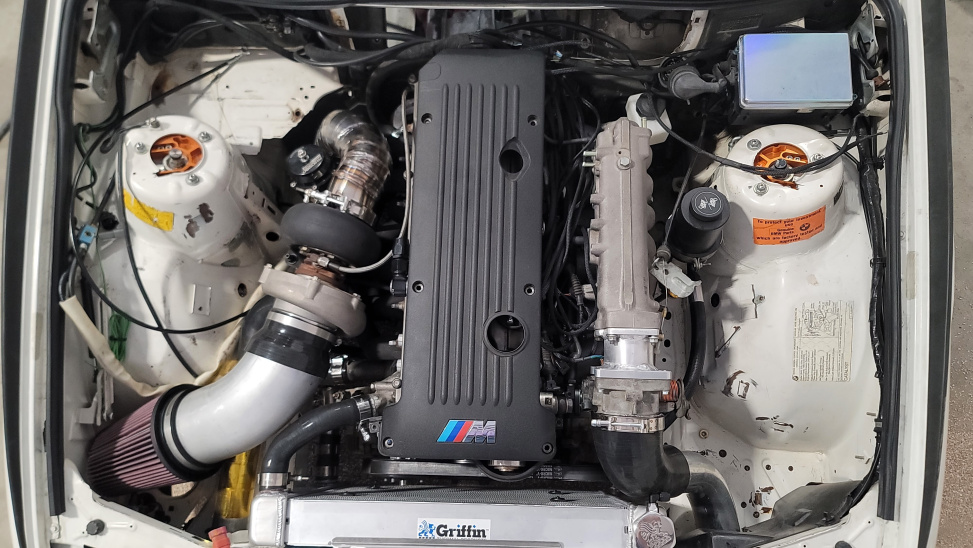

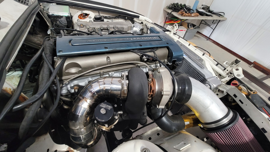

    The car started out its life as a stock 87 325is. Ended up making 522whp/500tq out of a stock 2.7 bottom end. Head had Bimmerheads 280/274 cam, and the associated HD valve springs and rockers. Car was fast, but the trans was terrible and felt like it was the biggest drawback. So I decided to go DCT swap. Well, in the midst of doing the DCT swap, I built a forged 2.9L bottom end with expectations of 700whp or more. Ran into some machine shop issues that just couldn't get my head right. Wasted 3 heads in the process due to lack of poor workmanship. So, I had this old stock unopened 2JZGTE VVTi lying around that I had planned on putting in something. Decided to just throw that in there and mate it to my DCT and do something that has not been done yet. Although we have already done a 2JZ E30 swap, and someone has done a DCT swap into an E30, they have never been combined before...and I can see why!
    Engine:
    Stock Bottom End 2JZGTE
    GSC S1 Billet Cams
    GSC Beehive Valve Springs
    GSC Titanium retainers
    Shimless Buckets
    ARP 625+ Headstuds
    ATI Dampener w/ Titan Crank Bolt
    ARP Cam Gear bolt
    Billet tensioner
    Gates Timing Belt
    PHR High Volume oil pump
    Radium 10AN Press Catch Can Fittings
    MS3 Pro EVO
    Radium Fuel Rail with Direct Mount Regulator
    ID1700x Injectors

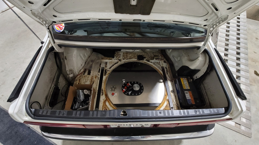

    Twin Walbro 525 Fuel Pumps in an RCI Fuel Cell
    8an feed, 6an return
    Aeromotive filter
    Flex Fuel Sensor
    ​LS Truck Coils
    Drewgo Exhaust Manifold
    Precision 6466 1.0AR
    Precision 46mm Wastegate

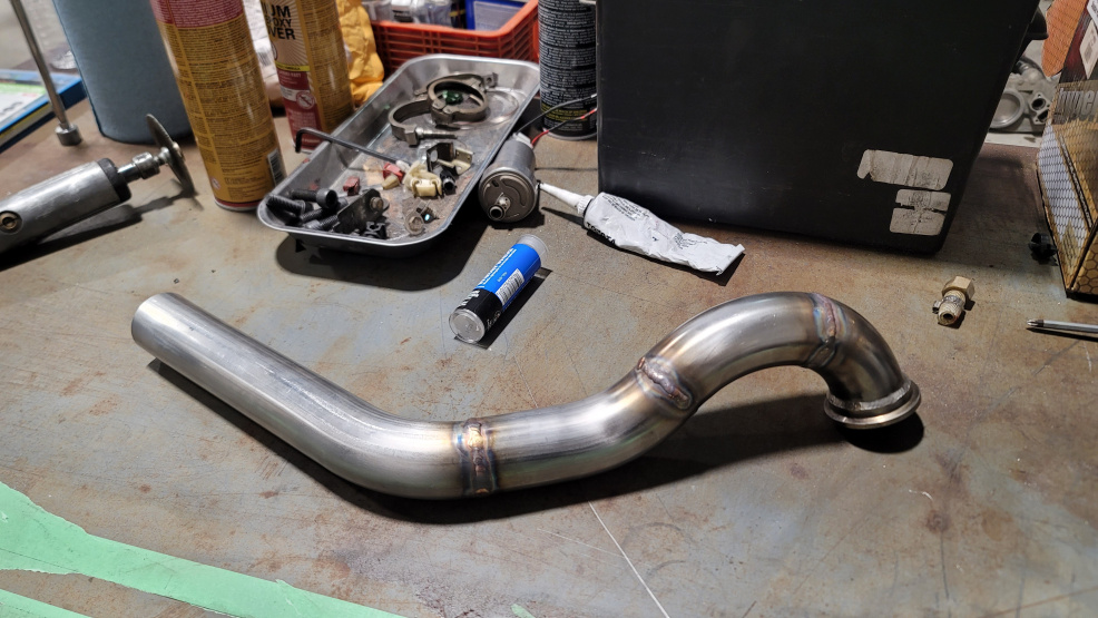

    3.5" Downpipe to 3.5" Oval Exhaust
    Custom Catch Can Setup with 10an hoses
    Chase Bays Power Steering Kit
    Griffen Aluminum Dual Pass Radiator
    SPAL Slim line 16" Fan

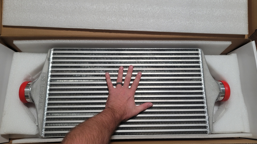

    Treadstone Intercooler
    5" Intake
    LS1 Throttle Body
    Custom LS Throttle Body Adapter to use on stock intake manifold

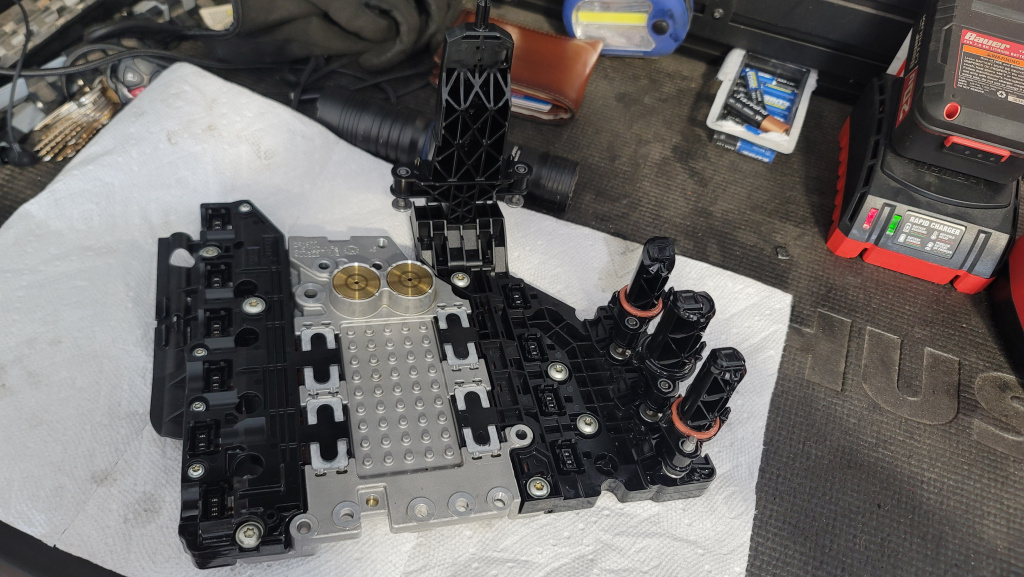

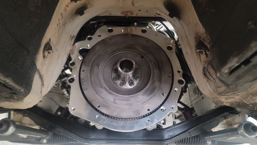

    Transmission:
    GS7 DCT from 2017 BMW M4 *Long Ratio*
    Modified Mechatronics Unit wiring
    HTG GCU
    3D Printed mount for GCU

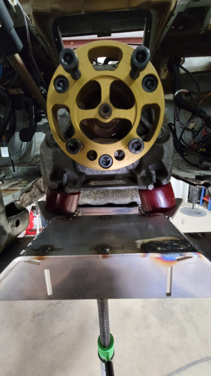

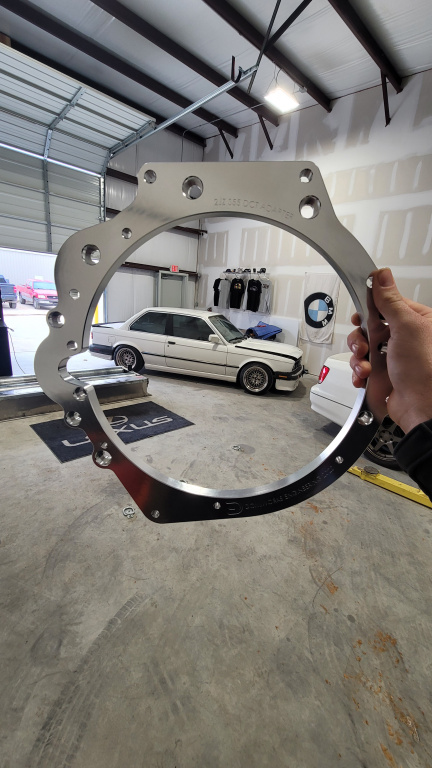

    Domi Works GS7 DCT to 2JZ adapter plate and hub
    Blink Marine CAN Key Pad
    DCT Shifter
    Seems Legit Garage Paddles
    Custom Mount for Paddles to mate to Nardi Wheel
    Custom one piece driveshaft
    Custom Transmission Tunnel
    Seems Legit Garage "mini" billet DCT oil pan
    Seems Legit oil cooler line adapter
    Oil cooler with lines and fan
    Seems Legit Garage Manual DCT Park lock cable
    Shock Travel Sensor for the Clutch Pedal (yes I can still use the clutch!)
    Brakes:
    RX7 Calipers
    Corrado Rotors
    Hawk Pads
    Chase Bays Brake Booster Delete
    Stainless Braided Lines
    Custom Hydro and Rear Willwood dedicated ebrake calipers
    Interior:
    Nardi Wheel
    NRD Prisma Seats
    DCT Shifter and Suede Boot
    Tablet for Cluster for MS Droid
    Blanks for HVAC Panel
    Customer Console Panel
    Fully functioning glove box!
    Red Carpet Swap
    Newly reupholstered rear seats
    Husco
    BOSS bluetooth receiver for stereo
    Pioneer sub and amp combo
    Suspension/Steering:
    BC Coilovers
    SLR Ultra Kit (Plus all the goodies associated with it)
    SLR Camber/Caster Plates, Adjustable Lollipops
    E36 Steering Rack
    Fully reinforced subframes/arms front and rear
    Camber and Toe correctors on rear
    Condor diff and subframe risers Delrin
    Extra Ear mount for Diff
    Exterior:
    Formuling Wind Splitters
    Cow Catcher
    Ellipsods
    Push In Diving Boards
    Ford Taurus Side Skirts (soon to replace with Kamei)
    Kamei or Zender rear wing setup, cant remember
    Zender rear apron? I Think?
    Airpress License plate panel
    Red Tinted Tails
    ESR 16x9 Mesh Wheels (Soon to be 16x9.5 -20et Work VSKF)
    225/45/16 R888R (probably going to 245 soon)

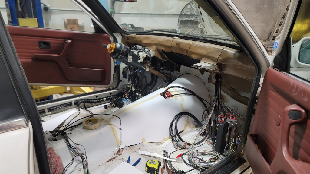

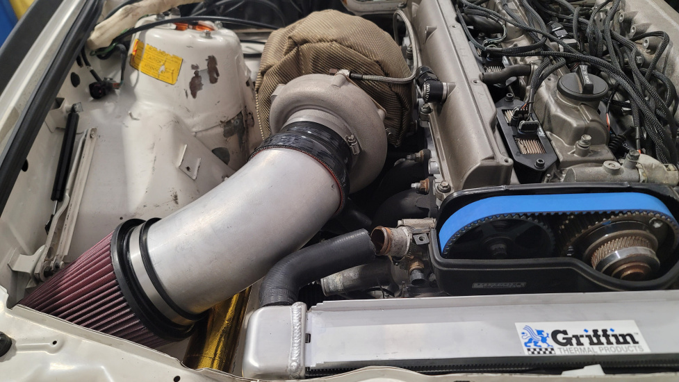

    Some pics of the car
    Click image for larger version  Name:	FOTAC80.jpg Views:	0 Size:	0 ID:	10080134 Click image for larger version  Name:	20191024_134742_resized.jpg Views:	91 Size:	206.5 KB ID:	10080137 Click image for larger version  Name:	IMG_20190527_071126_703.jpg Views:	187 Size:	186.3 KB ID:	10080135 Click image for larger version  Name:	received_10160543500235442_resized.png Views:	93 Size:	144.9 KB ID:	10080136 Click image for larger version  Name:	whitebmw2 (1 of 1).jpg Views:	90 Size:	149.3 KB ID:	10080138

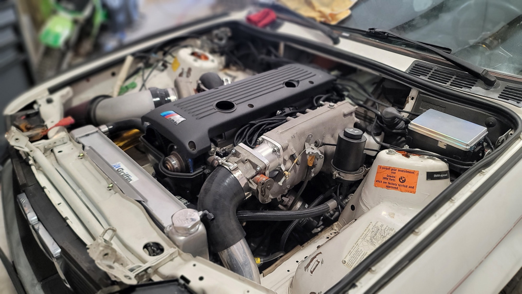

      Old setup with stock bottom m20
      - AXIS POWERS - 2JZ E30 Build
      Current Project - 87 325is 2JZ Swapped with M4 DCT

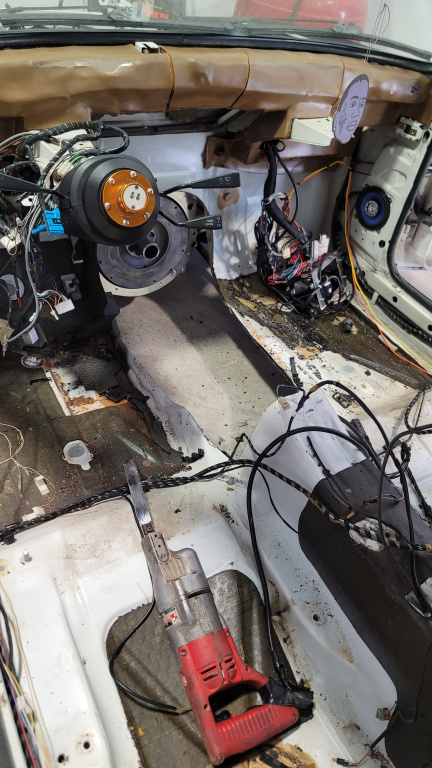

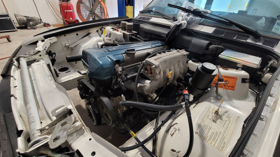

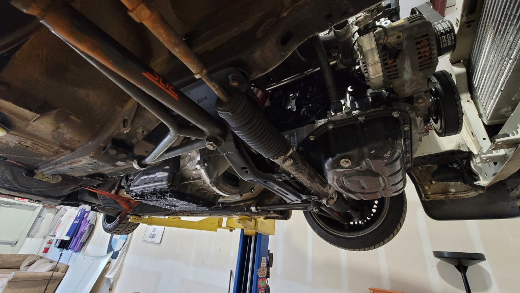

        Some progress pics

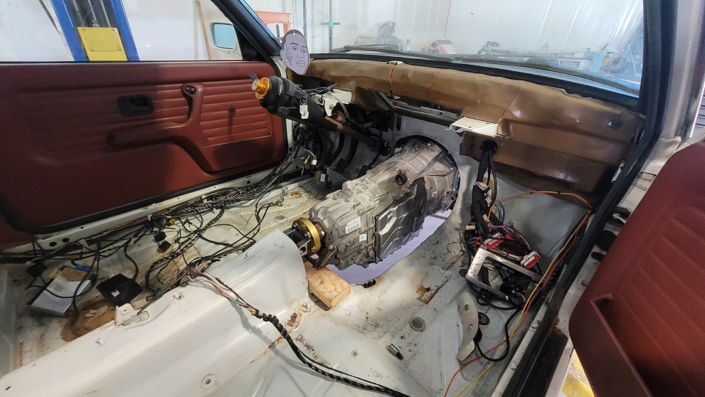

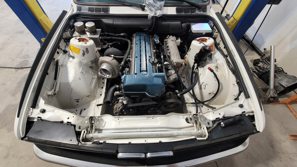

          More progress
          • SLEEPYDUB
            • 658

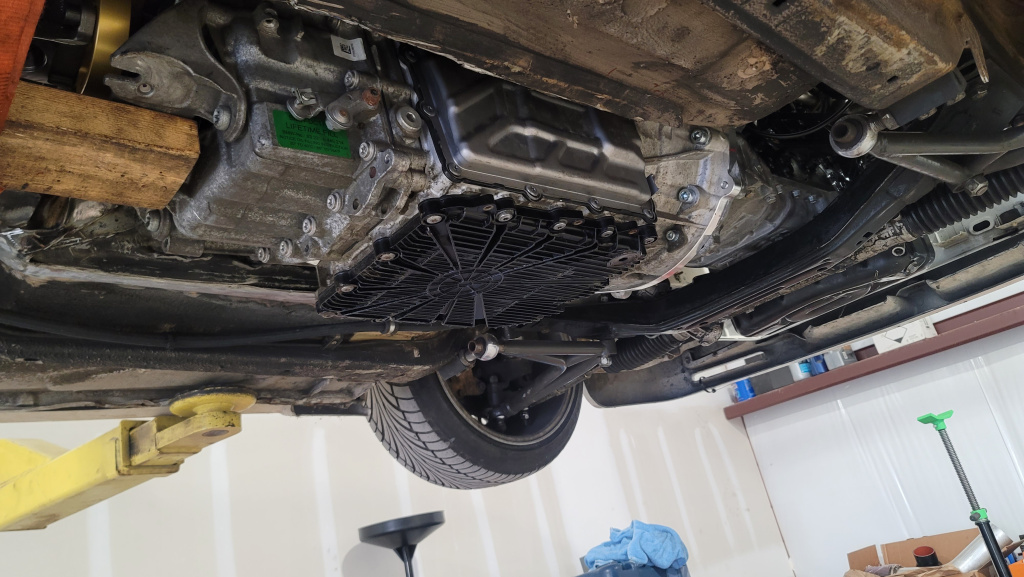

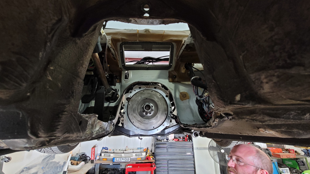

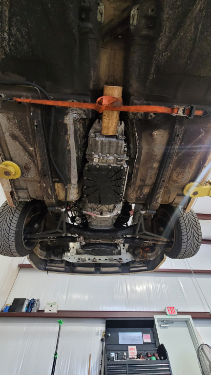

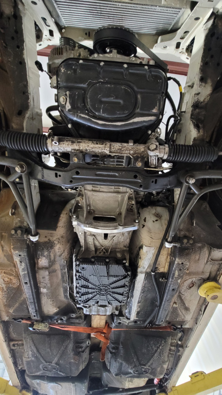

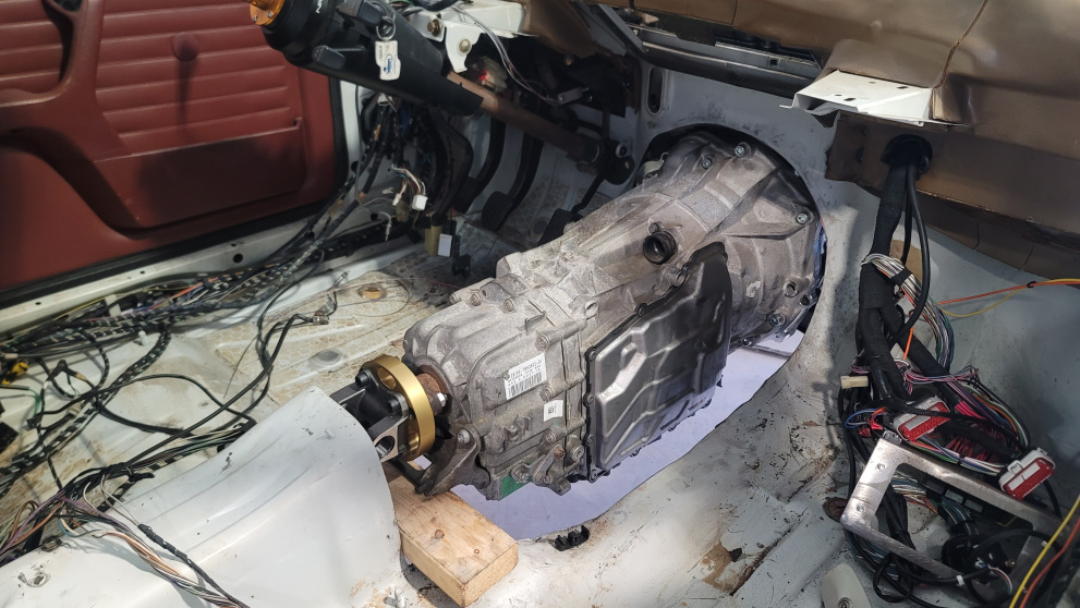

            Trans is so big
            • SLEEPYDUB
              • 658
              A little too big if you want any reasonable amount of ground clearance
              • SLEEPYDUB
                • 658
                Just so big

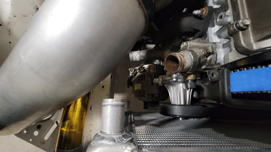

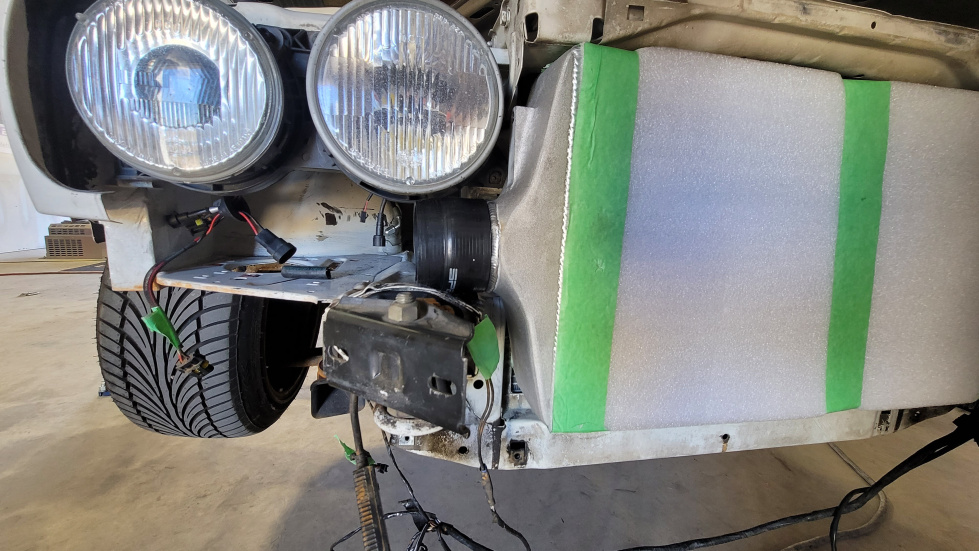

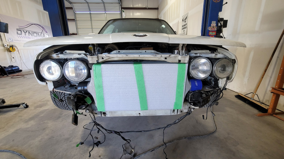

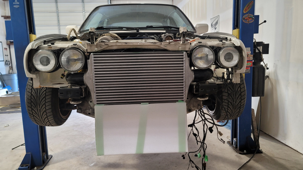

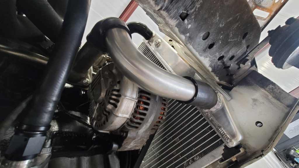

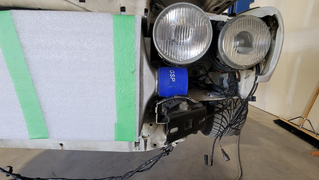

                  Biggest intercooler I could find that would fit well
                  • SLEEPYDUB
                    • 658

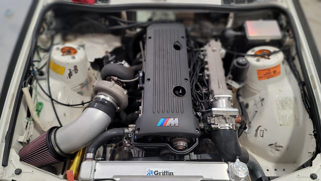

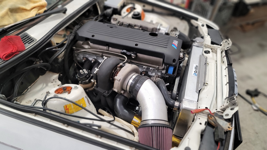

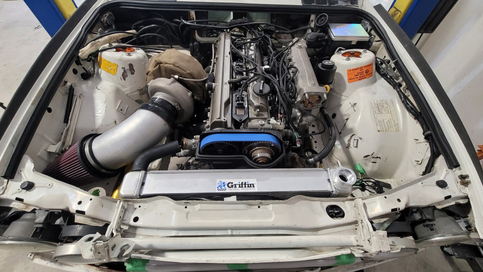

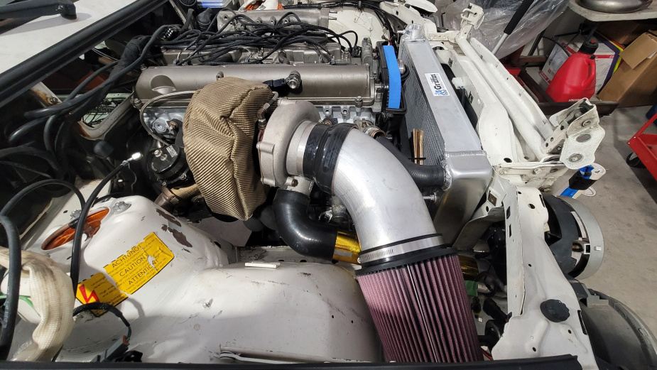

                    Thicc ass intake

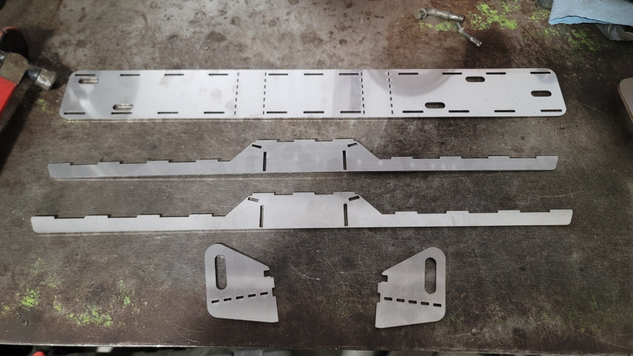

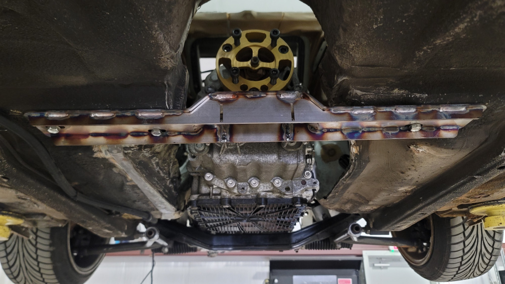

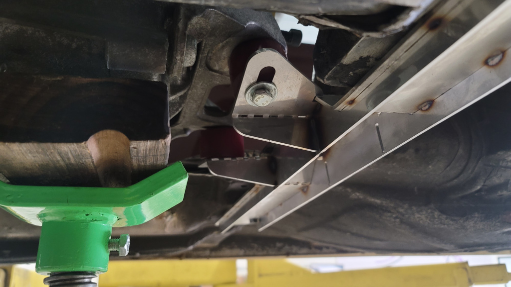

                      Trans mount done

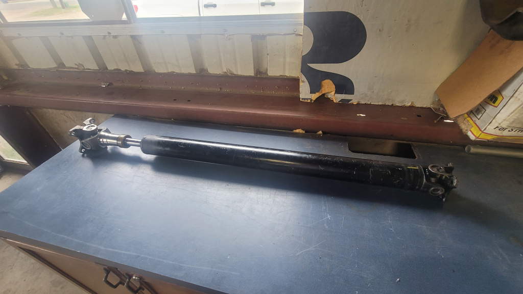

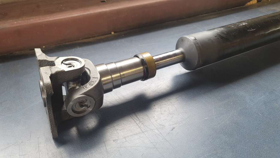

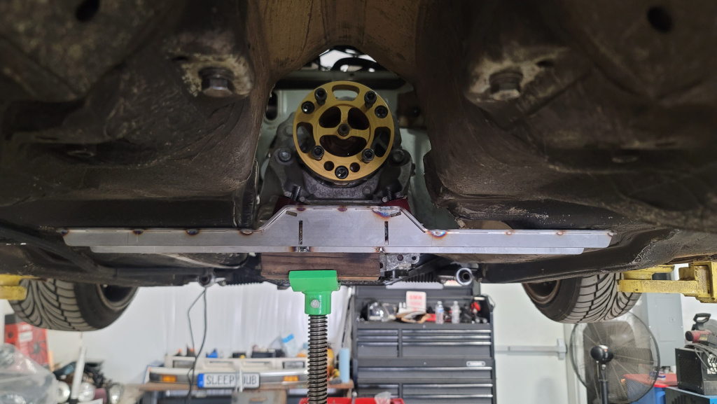

                        Some fab work, driveshaft
                        • SLEEPYDUB
                          • 658

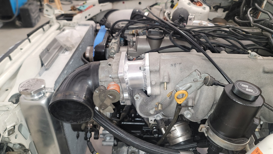

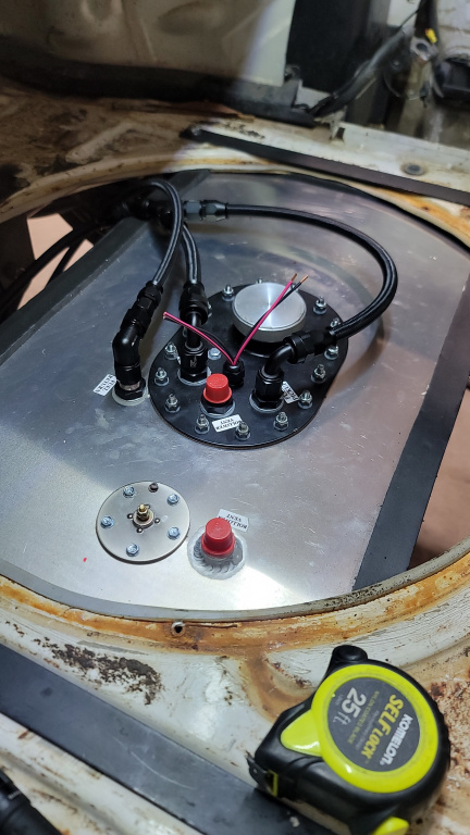

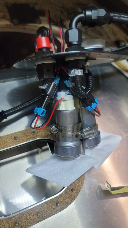

                          LS1 throttle body fab. Fuel setup

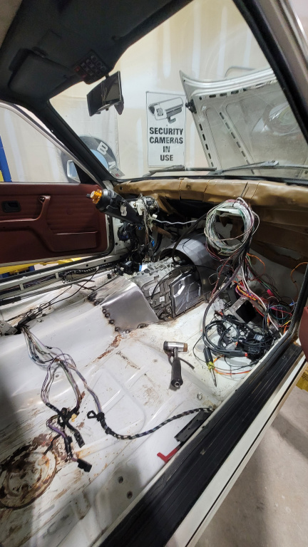

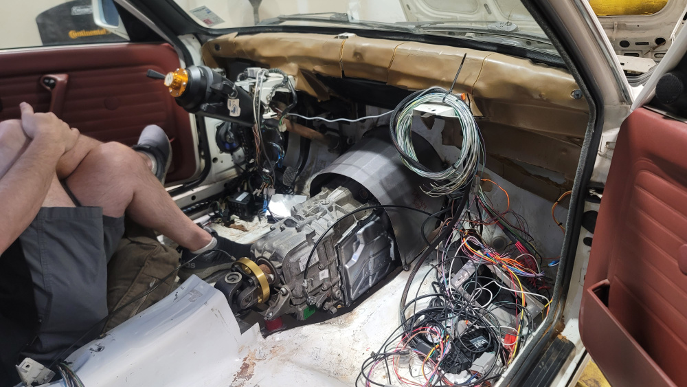

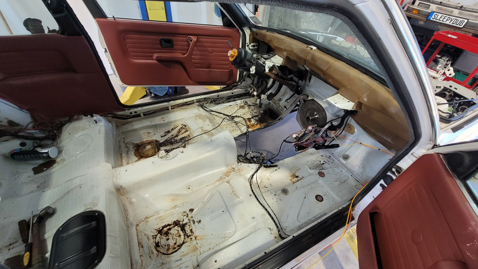

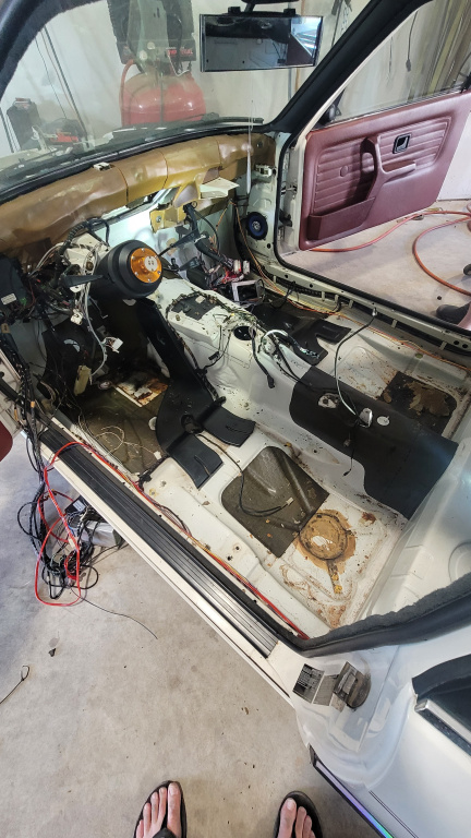

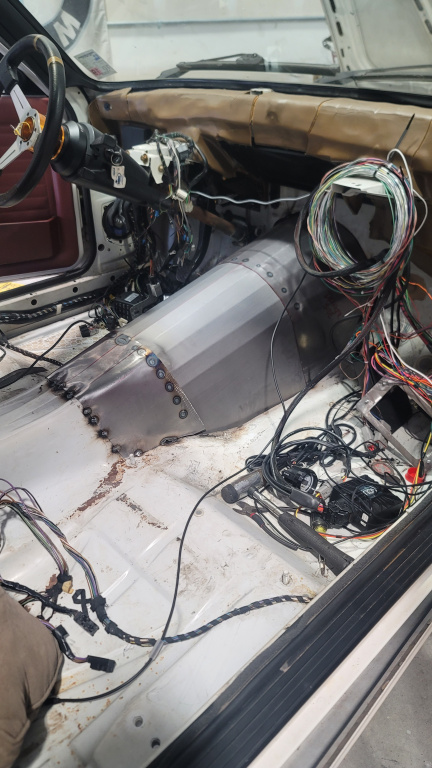

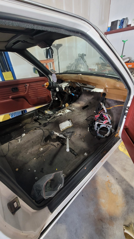

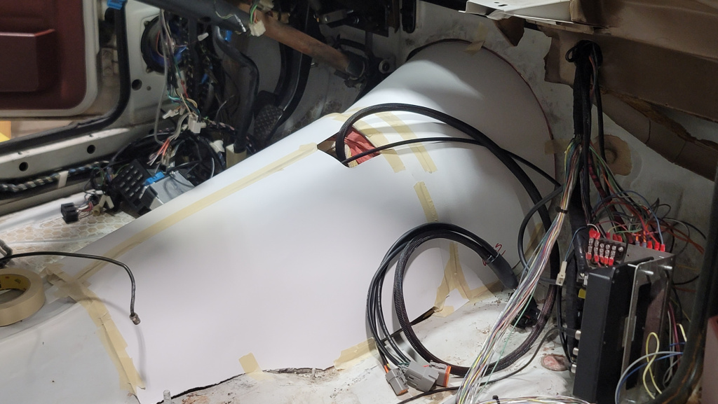

                            Trans tunnel
