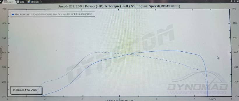

    OK small update.

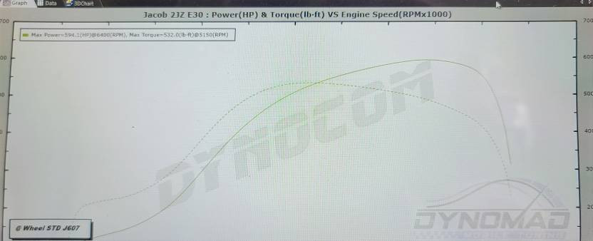

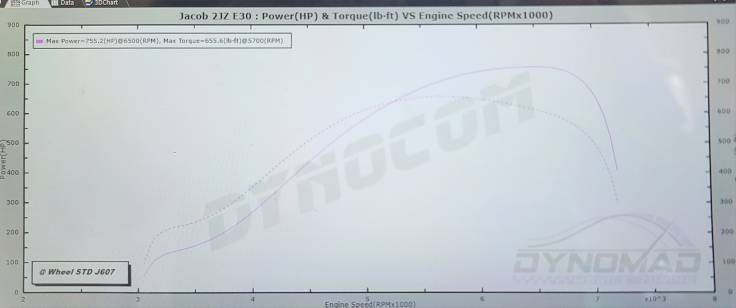

    Car made 411whp on 10psi, 595whp on 19psi, 755whp on 29psi, and 772whp on 31psi.

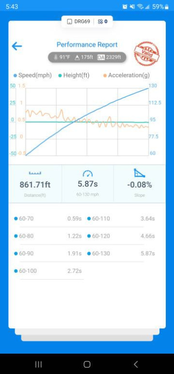

    Ran a 60-130 on 19psi in 5.87s

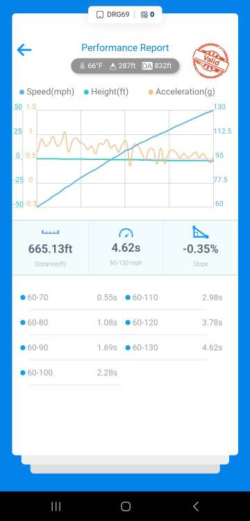

    Ran a 60-130 in 28psi in 4.62s
