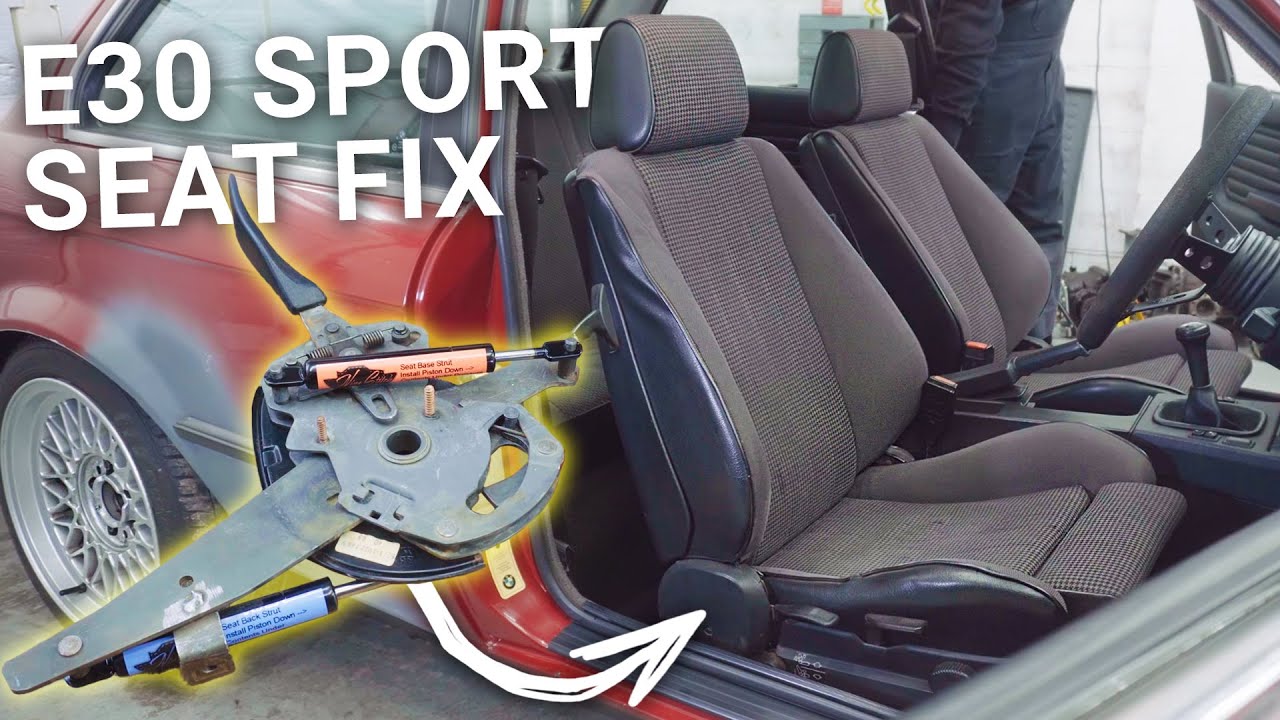

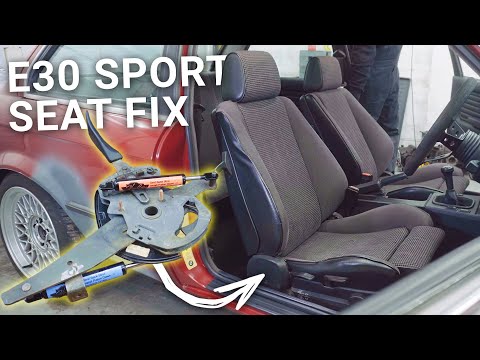

        It's been a minute since the last E30 project update but I'm back on it.
        I decided while the car is laid up int the garage, hiding from the winter salt, that I will turn my attention to the interior of the car, and pause on the complaints I have about the pots and pans noise, and the stiff suspension.
        I have picked up some covers to restore the sports seats, but before that I want to make sure they are functioning properly. Unfortunately, neither of my seats are operating correctly.
        They can slide back and forward, but the seat base height and backrest lean adjustments have failed.
        The lean is a particular issue as the seats back rest flops all the way down when you pull the lever. It can be either hilarious or dangerous when you forget and do this while driving.
        I ended up setting the drivers seat to my taste a long time ago, and have been careful to leave it alone and not try to mess with it since. Although I would like to be able to refine the driving position for myself going forward.
        The sports seats I have were included when I purchased this otherwise poverty spec 316i. I was very lucky with that because they are worth a pretty penny these days. They are houndstooth which has really grown one me, and stamped 1985 so likely to be from a prefacelift 325i Sport M-Tech 1 which is very cool.
        I found out the seeat adjusters are operated on little gas shocks which are no longer available from the dealer. I was able to source some aftermarket direct replacements from a company called NineStitch. These little struts are remarkably strong so I also had to get creative with how I installed them. Luckily this was much easier by the time I got the seats out and stripped the backrests off giving me access to remove the entire hinge assembly.
        I will have to wait to find out how much sturdier they will make the seats feel, as the next stage is to change the covers, something I've never done before so sure to be a learning curve!
